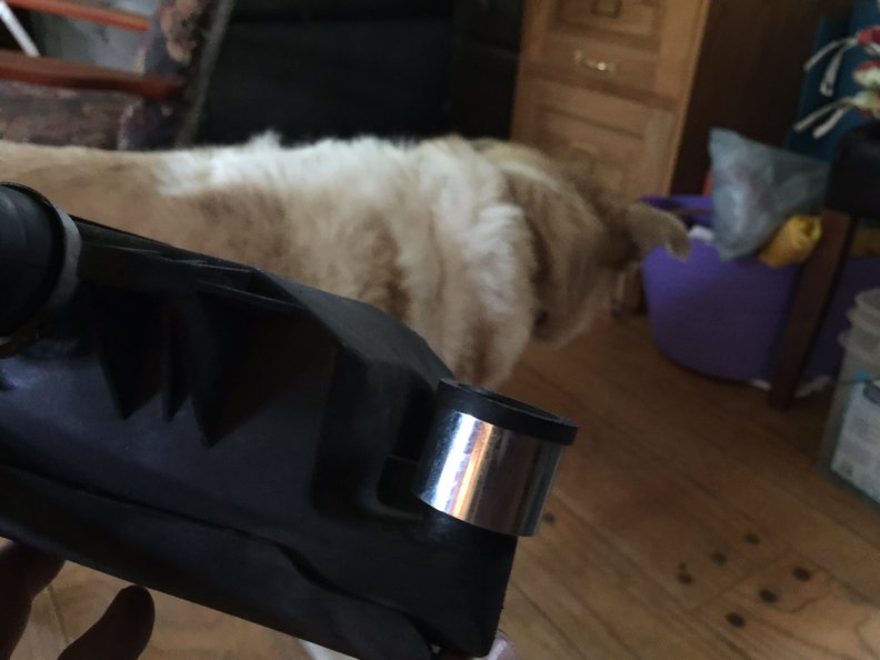

Okay...should the plastic boss on the lower connector for the PCV box point towards engine or the box?
Dog doesn't like the first one..

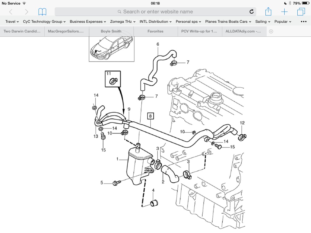

VIDA has a poor picture which looks like towards engine block.
My mechanic intuition says rubber part should touch plastic box, metal touches metal.

Volvo picture seems to show boss goes to block side

As far as I can remember, I've put it block side on my PCV changes. Not saying it's the right way, but it's my way at least...

I've been putting them to the trap side. I reasoned that the block gets hotter, why cook the collar if you don't need to. I can tell you they don't leak when turned to the trap side, FWIW. But that graphic would be my guide, I would go block. Will if I think of it next time(s).

It doesn't matter that much.
I have done it both ways, no issues whatsoever.
It is just a short hose to connect the oil trap opening to the engine block and that is all.

In the thread below, it looks like the boss touches the engine side.

I always put it toward the block as well but I really don't think it matters. I usually put hose clamps on both sides but that isn't really required either.

From an engineering standpoint, I would "assume" it's boss to block to damp vibration and allow for thermal expansion differential between the two-even though it's mounted together.
