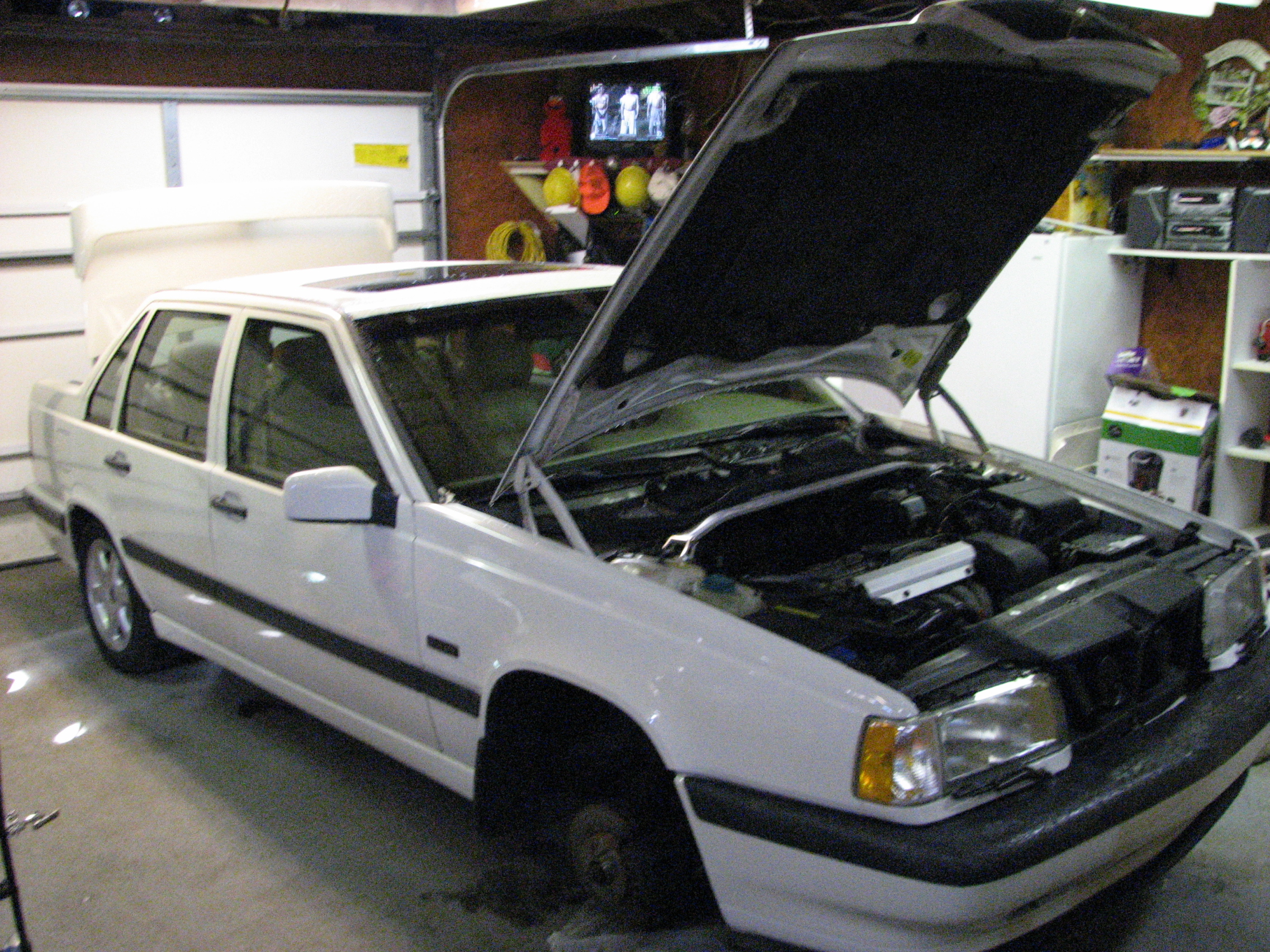

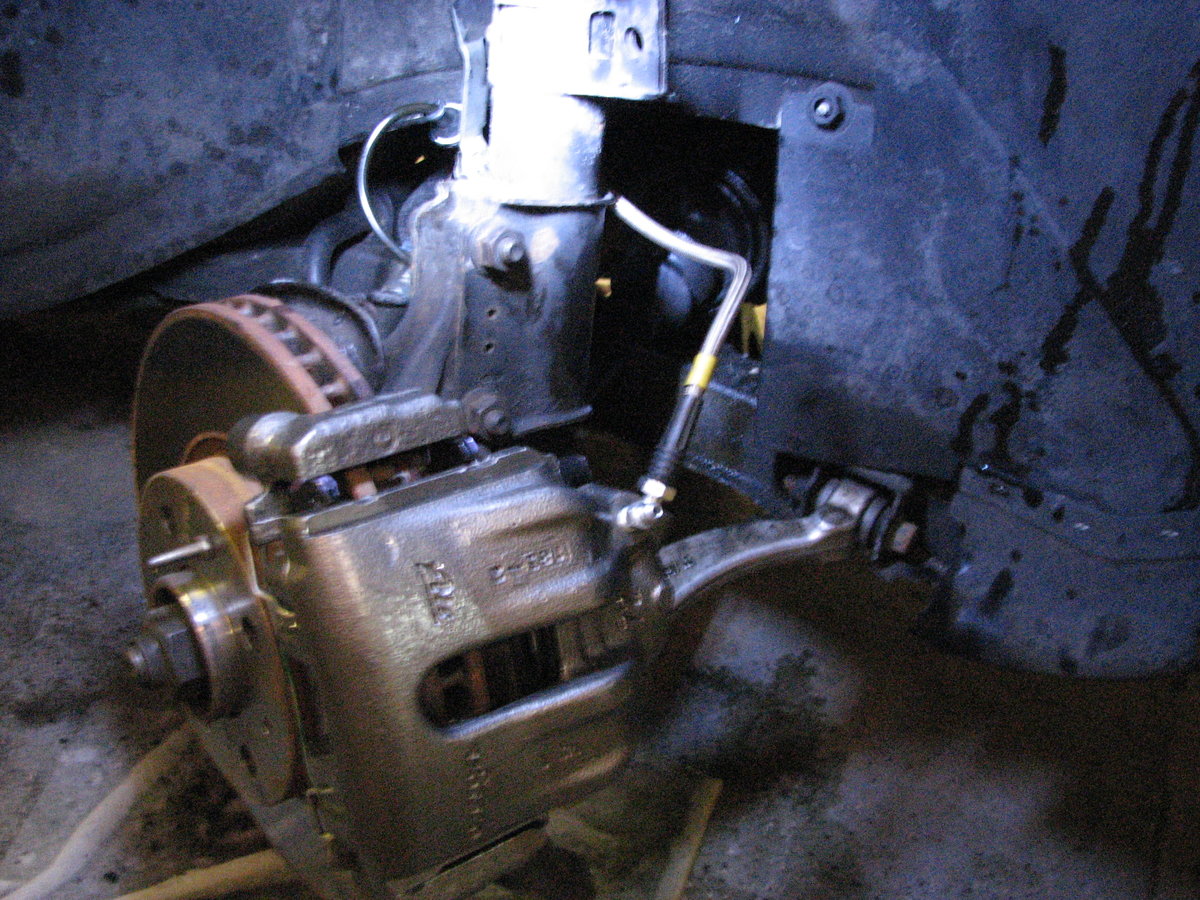

Yesterday now, I had a chance to use a friends heated garage. I had bought front calipers and stainless brake lines to compliment the new rotors and ceramic pads that I had installed last month.
It was a pleasure to work inside. The vehicle is appreciative.

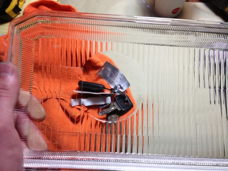

Is that a new lens, or did you do something to it?

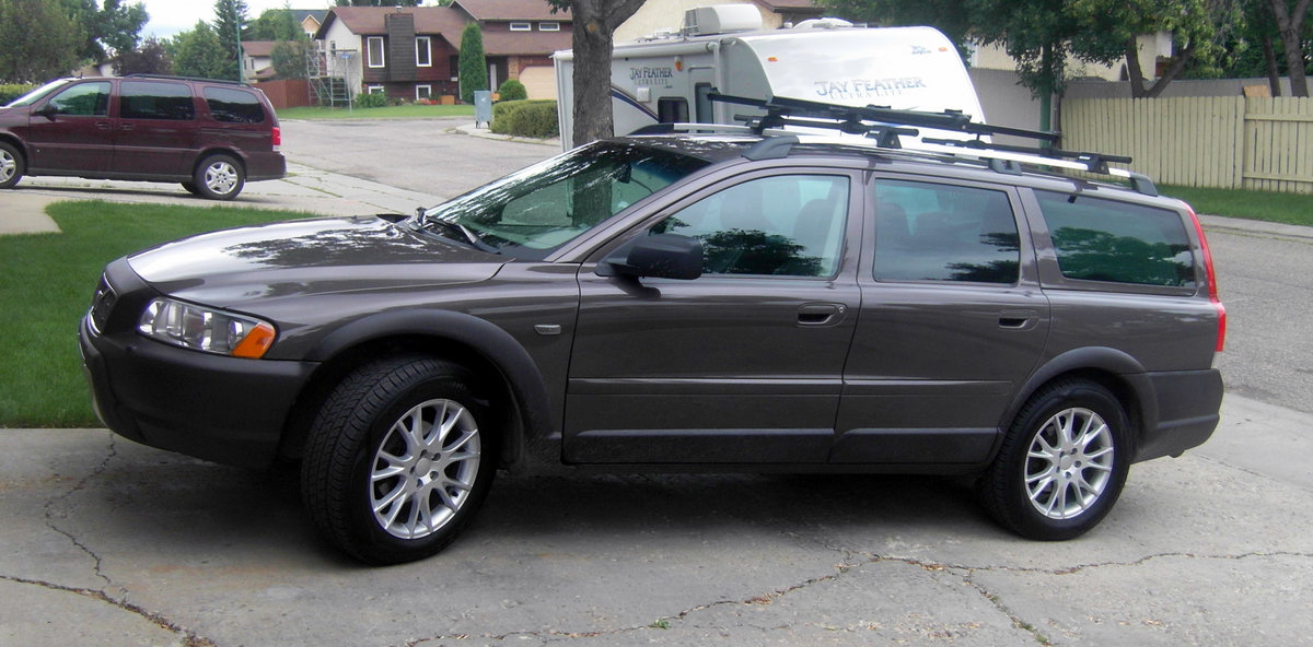

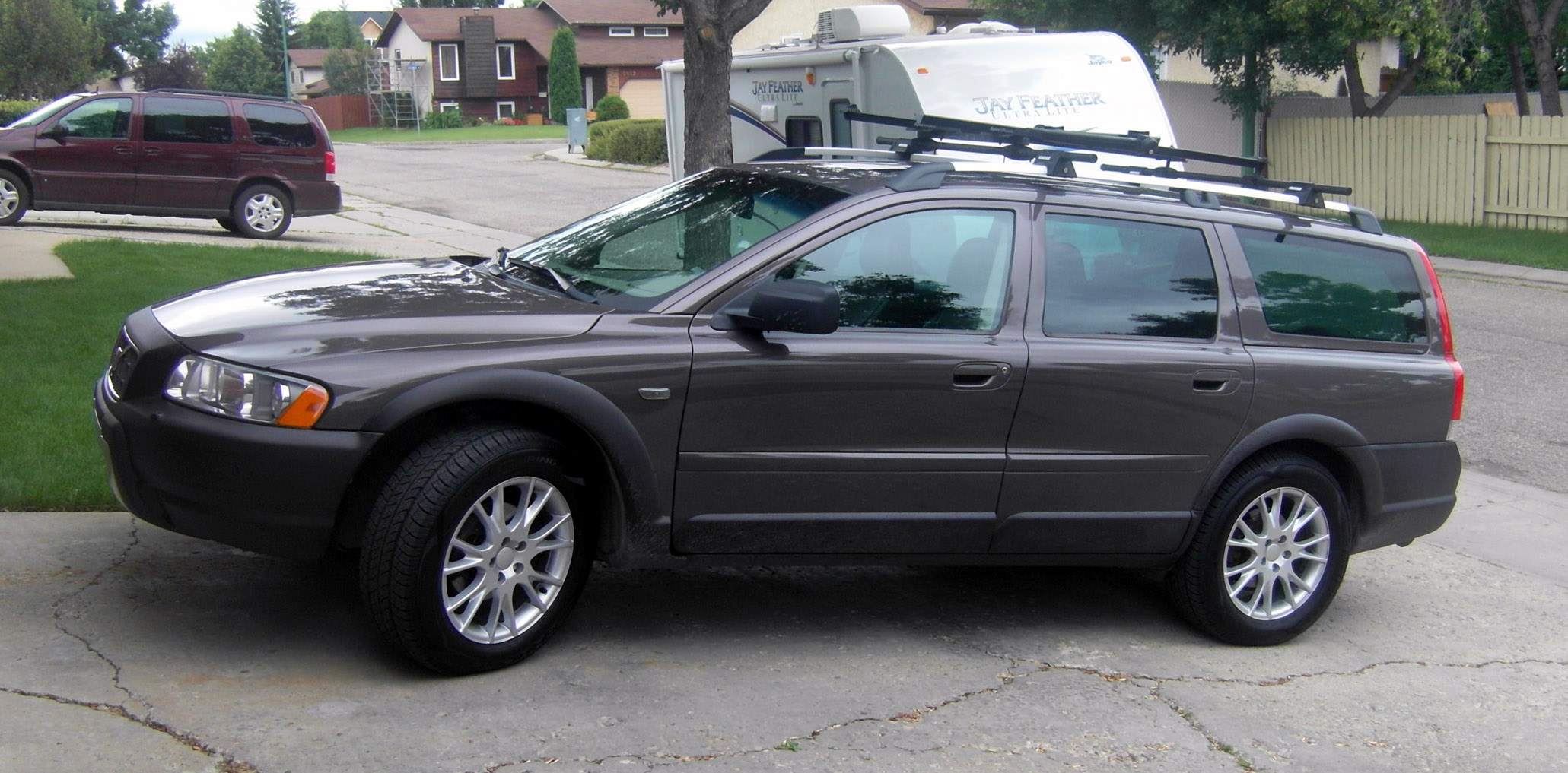

Today I did an oil change followed by installing a Fumoto quick release oil valve, installed rubber isolation tubing on my front coil springs after I installed a 2" lift kit. Installed XC90 axle bolts with the rubber spacer to fix front axle ping, aimed my headlights. Did an alignment, and thoroughly inspected every rubber mount and ball joint as well as axles and fluid levels in the bevel gear and rear differential. I also removed my power steering reservoir and cleaned it out and then did a full power steering flush. 165,000KM young and at stage zero and driving like a beauty!!! Hard to say whether I'll keep it for long or give in to my temptation of an XC60 which I drove and loved last week
