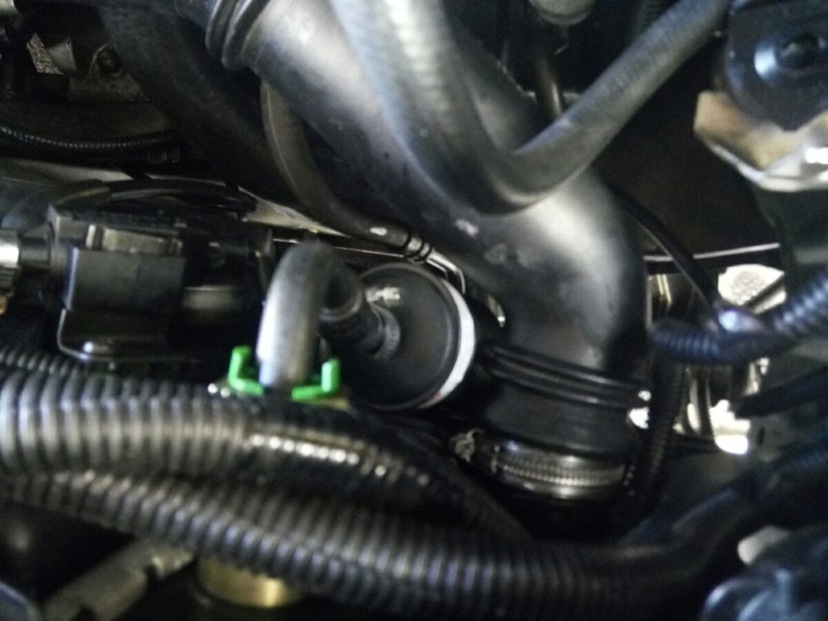

Magnefine x 1 is in place. Everything checked for leaks. Fluid level is perfect. Transmission continues to impress with a seemingly "cured" 1-2 shift after a further 60kms.
Not going to remove the transmission to mess with what's already working well and will definitely be keeping up the transmission filter and fluid changes from now on.

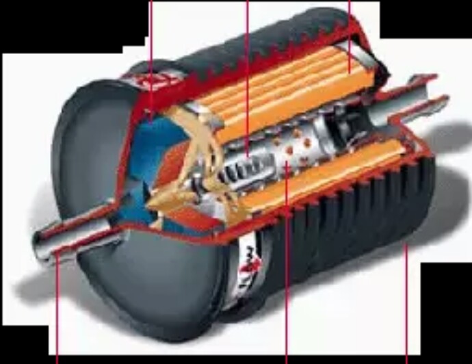

The Magnefine is certainly a better way to filter than that ridiculous cost-saving gauze Aisin fits.
A special thanks to Cuhfs who brainstormed the idea of drilling the transmission case and Nautic who provided extra photos and videos; I would still be driving the wife's old 2002 XC70 with semi-working A/C.
Total cost of the repair including new fluid, filter and various hoses/syringes and clamps would be in the vicinity of $250 though I had the thread taps, bolt and washer/o ring in stock.

Still going strong no issues even in stop start traffic.
Over 600kms now.
I was speaking to a friend of mine about this marvellous Magnefine external filter. He owns a 2003 model Subaru Legacy and a Hyundai Lantra. He mentioned that both of them have screw-on type transmission filters very similar to engine oil filters.
Begs the question why didn't Aisin protect their units with the same? Even the newer 6 speed TF-80SC doesn't have this feature. Clutch material can do the same to any filter unless the filter material has been improved to prevent clogging.

Another 1000kms and now the TCM has adapted to the new fluid pressure. 1st to 2nd is perfect and no thumping on downshifts at all. Smooth as silk......
I can now slip the gear lever into the manual gate, rev the motor to 5,000rpm with full throttle and change gear to 2nd with a clean snappy shift.
