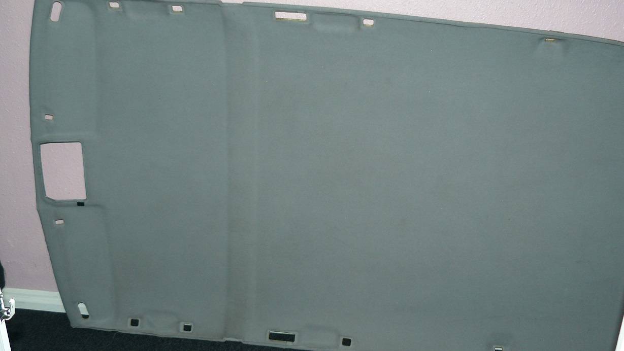

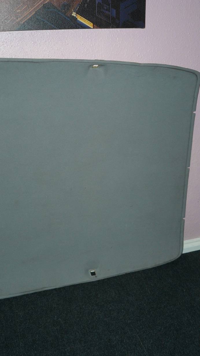

hi all well after a good couple of years of hunting i have found and purchased a good clean non baggy headliner/headlining for the 855 out of a 1998 v70 i got to take it out myself and between downpours i somehow managed to get it home in one piece and still dry!
today i investigated the water ingress causing the damage to the headliner before i fit it and was chuffed to find all 6 roof bar securing bolts came undone without breaking/rounding off and as suspected it seems the seals have rotted away and due to prolonged exposure the water is making its way in through the screw threads and inside the car i have some black seal material and will make the seals and ensure there is no water ingress before fitting the replacement liner,i pray it fits but got to be worth a punt for £65 aye?
