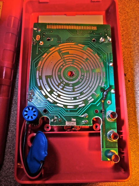

I could not test the blowers at higher currents because my supply and meters were limited to 10A. In fact, the first current meter I used -- a Harbor Freight cheapie that I got with a "FREE" coupon -- blew out at about 6A despite being rated for 10A. I opened that one up and took a look at what failed:
Blown current trace on circuit board of my "Free" Harbor Freight multimeter after using it to measure the current draw of the blower motors.
After the smoke cleared, I used a different, higher quality multimeter to get the data in the load line graph above. While testing, I could hear faint squeaking coming from the old blower (I hadn't heard this while it was in the car, either because it's harder to detect while it's installed in the car or because the blower developed the squeak again during removal or testing).
