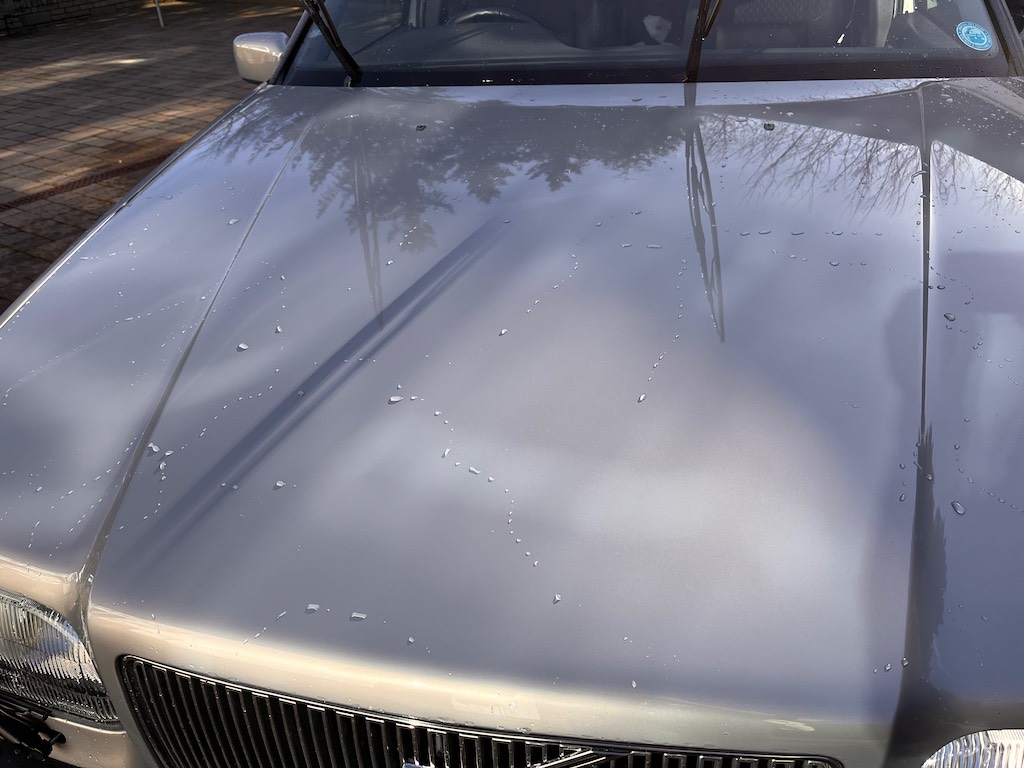

Time to give Val a bath in preparation to going back on the road next week.
The last time she was polished was 5 years ago. I do give her a wipe over with Chemical Guys V07 a couple of times during the summer but apart from that nothing else
The water ran off after rinsing and this is what's left to blow off with the airline
Now sitting with doors open and waiting on the sun to dry her off

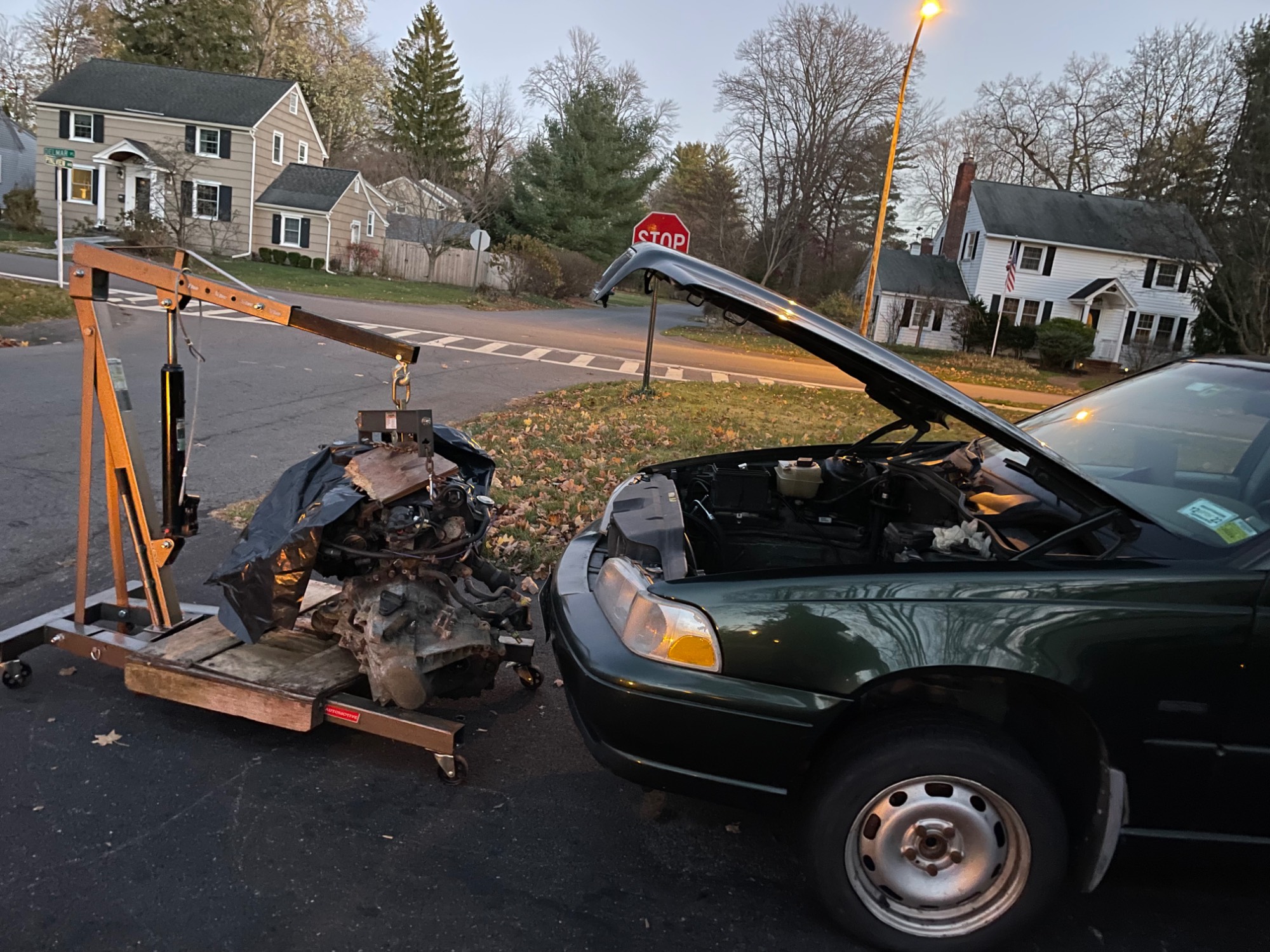

I dropped my P2 clutch out the bottom, dropping subframe completely.
Last P80 came out the top….

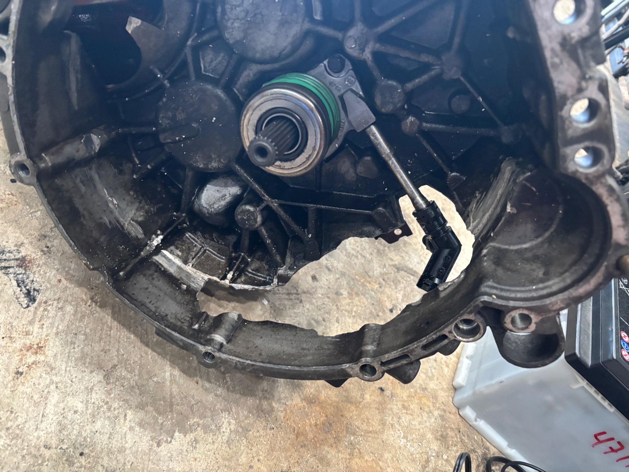

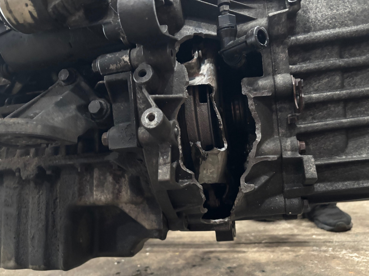

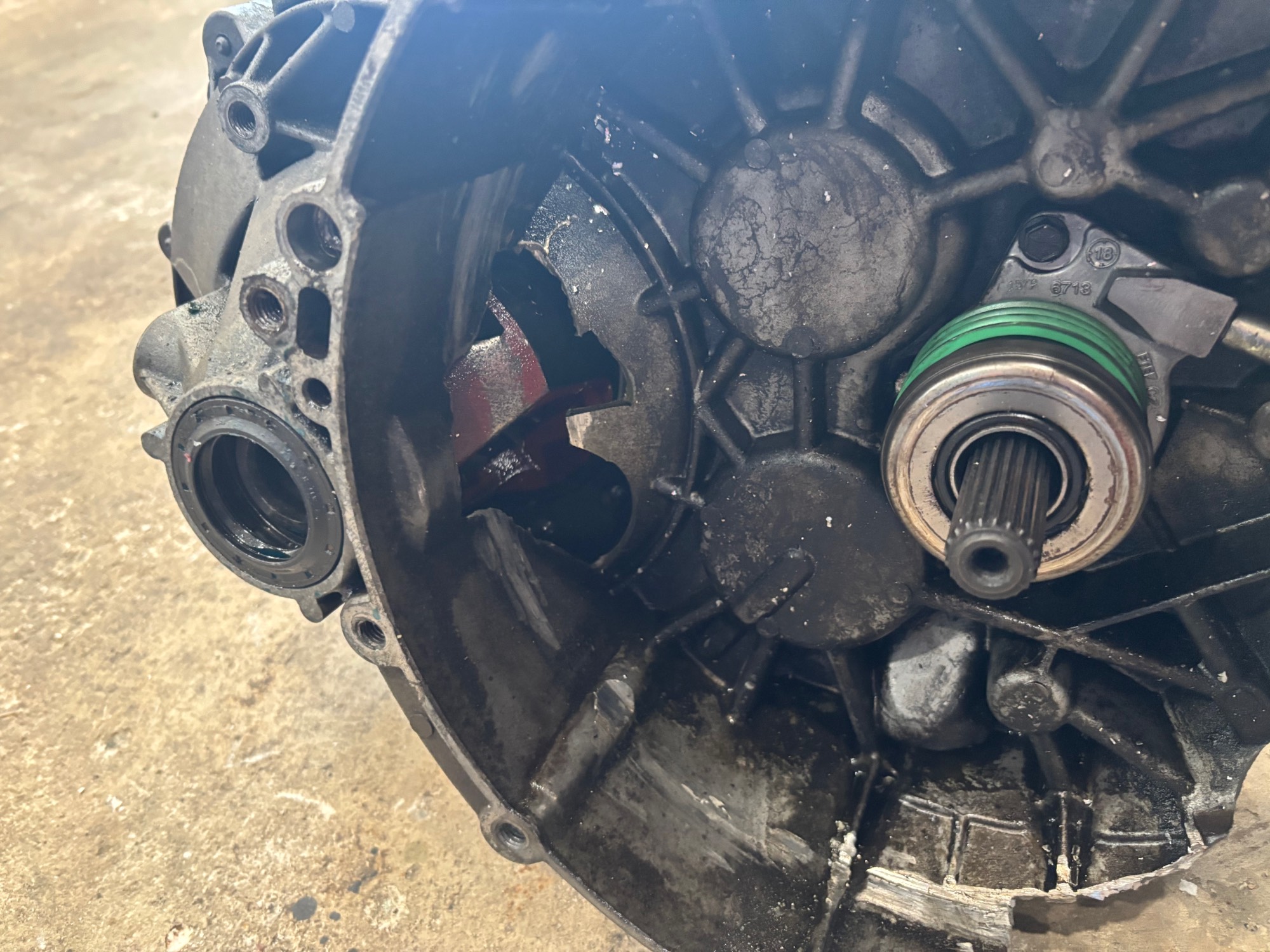

My cousin just pulled his T5’s drivetrain last weekend to install a 19t, clutch, and transmission. His old M56 failed spectacularly. If you can believe it, it still drove! Clutch wasn’t releasing completely, so you had to start it in gear and couldn’t change gears, but we drove it onto the trailer and into my shop!
Waiting on the correct clutch right now, since clutches for a turbo with a single mass flywheel are incredibly hard to find. He had everything ready to go but it was the wrong clutch.

Are you done with that m56? Looks like it still has some life left …..
