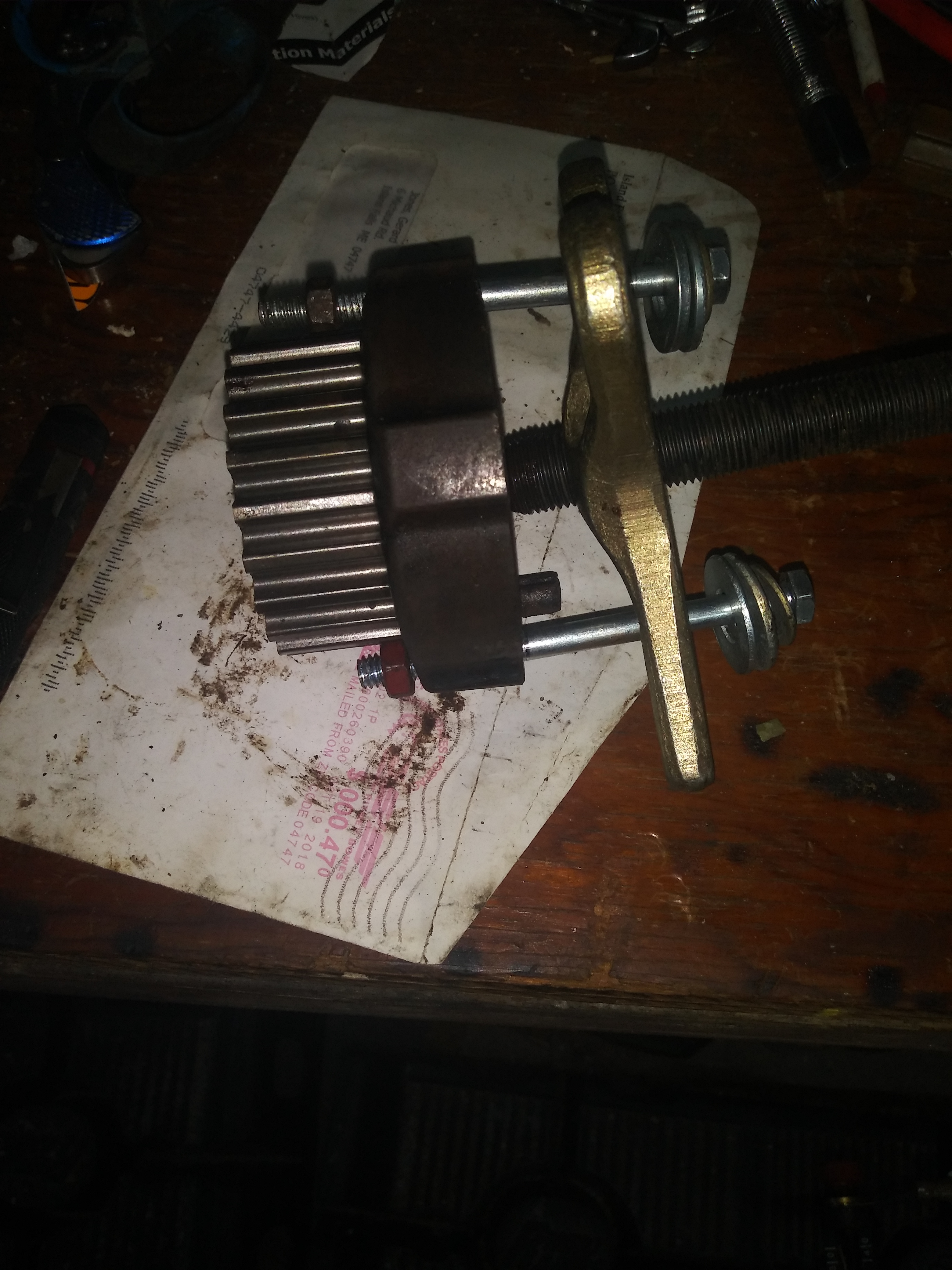

I pulled the crank gear, new one coming. damaged splines due to lost crank nut.
we can fix em.
Posts: 35289
Has thanked: 1502 times
Been thanked: 3817 times
Nice jones - I recall from an earlier thread the gear splines are a lot softer than the crank splines so they get damaged and the crank will be fine.

abscate wrote: 19 Jun 2020, 19:20 Nice jones - I recall from an earlier thread the gear splines are a lot softer than the crank splines so they get damaged and the crank will be fine.
That makes sense, sacrificial consumable part.
There is very little damage to splines, only a short section but enough to allow a wobble and condemn it.
I really need a decent 2 jaw gear puller.
