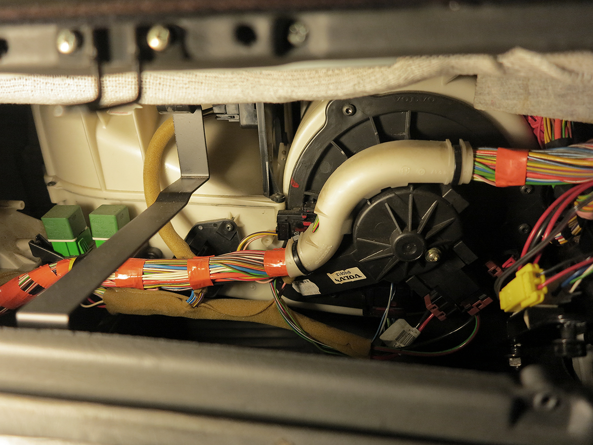

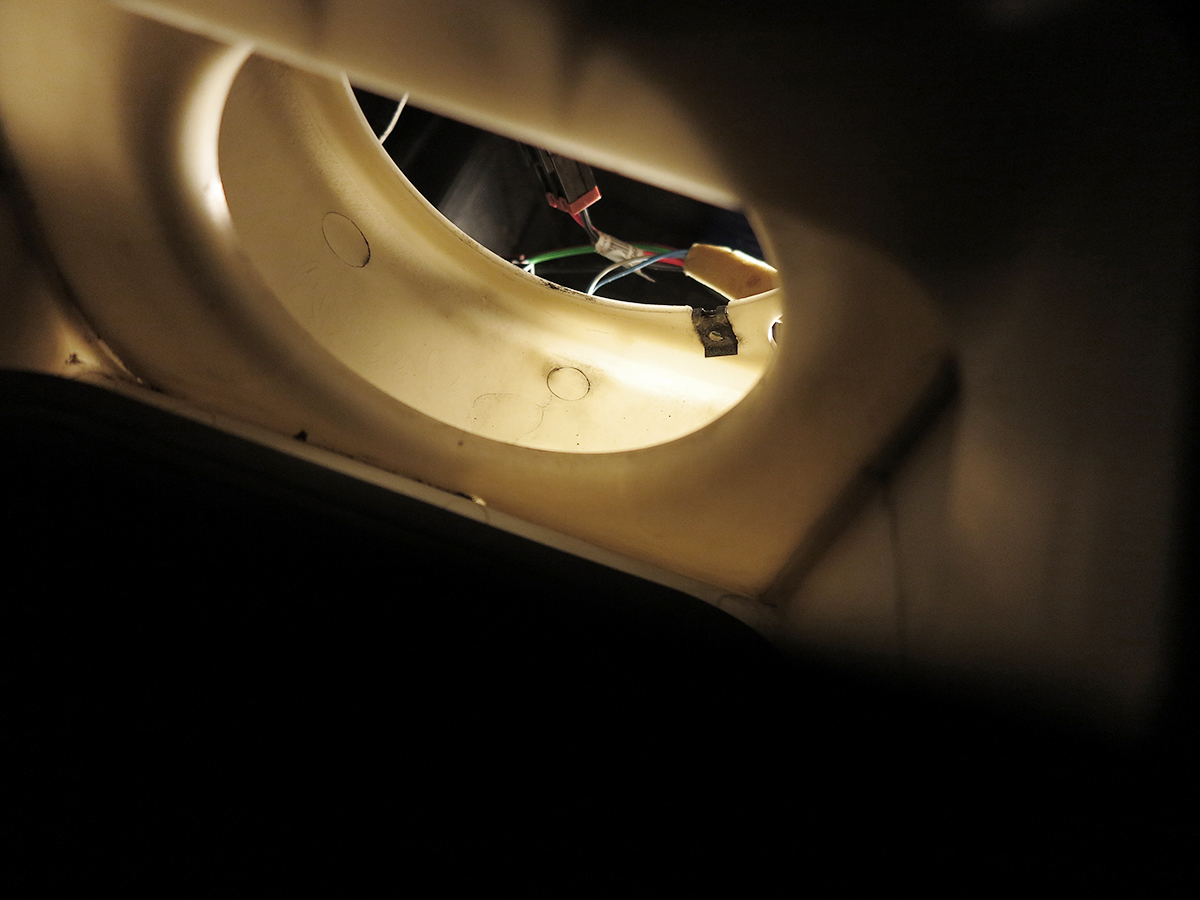

Blower fan, resistor, and cabin filter were replaced with new, all Volvo.
Hand-held "breaking brushes" was non eventful. Fuse #5 controls fan speed 4, and #31 for 1,2, and 3.
Glove compartment fastening points needed rebuild, only one had survived the time and removal.
Few photos...
Few photos...
