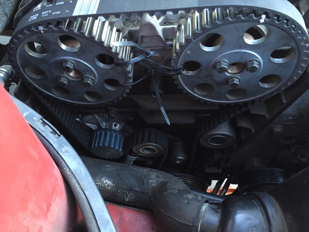

Hey thanks for this post. I actually printed out your steps and followed them. It was very helpful. I wanted to add one thing though. I used some straps in a makeshift cam holder. It's a bit janky but it did it's job very well.
As it turned out, my timing marks were not hard to spot at all. It looks like someone has been in there before and made very clear white marks. Odd as I am the only owner of this car and I don't recall ever doing this...
Anyhow, many thanks for your efforts.
