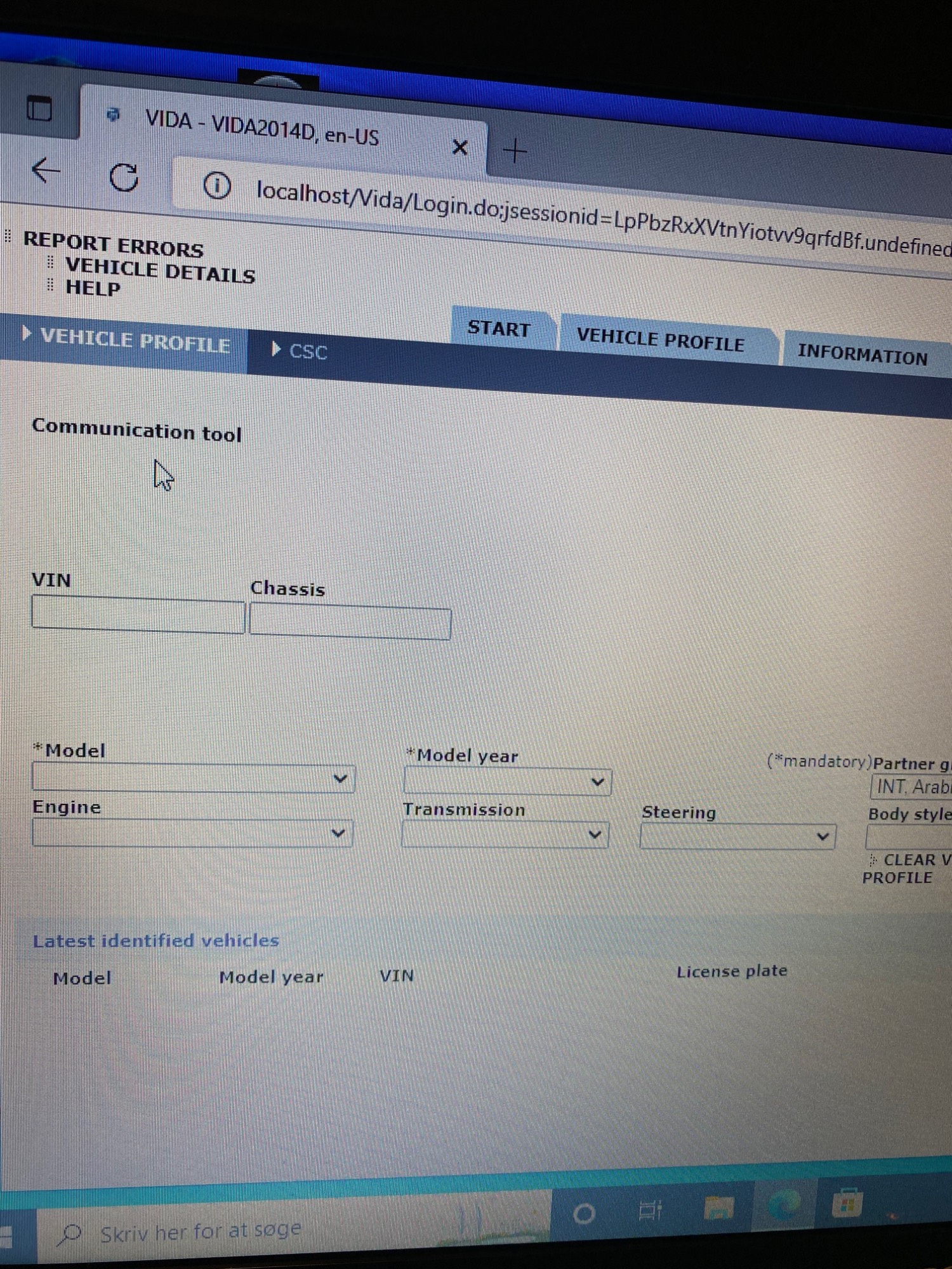

Well - Hi again!
I have now managed to install, and everything seems to run smooth, except one thing; Dice controls does not show up under Communication Tool on the Vehicle Profile tab…
Only the headline “Communication Tool” is vissible
The popup window is missing
I have installed the Dice Tools from the 3PP/Products/DiCE folder
And DiCE Diagnostic app is testing the device OK
Firmware is up to date with firmware on the .iso
Did a custom install of the DiCE from the Script 02_VIDA - just to make sure
Restart several times
But it does not show up on the Vida page…
Any ideas?
BR Espen

Red X in Communication Tool .... IE Hosting did not enable.Espen Beck wrote: 02 Sep 2022, 14:08
To fix:
Vida DVD:\Install\Utils\EnableIEHostingxxx.reg .
Make sure you run the right one for your operating system.
xxx =x64 is for 64bit operating systems,
xxx =x86 is for 32bit operating systems

Thanks but there is no red cross - bot popup is missing (attached image)
Tried to run the EnableIEHostingx64 anyway, but with no result - have restarted after also - still no popup
Any other suggestions?
I have two DiCE devices and one of them used to run fine with the Vida 2011 version, but now i am on a newer 2014 XC90, so i need the 2014 Vida
Appreciate all your help here!
BR Espen

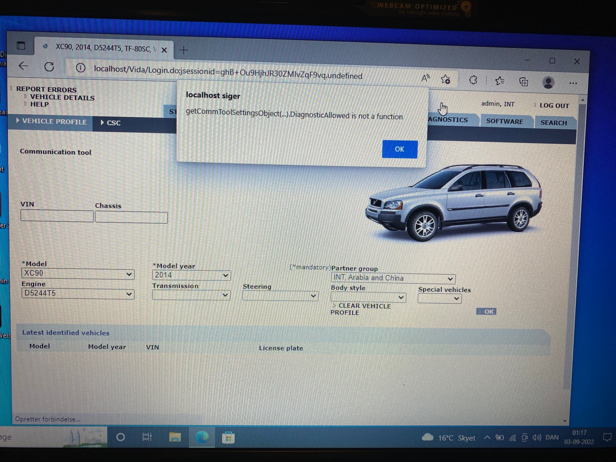

Maybe a hint about what is the issue…
I get the localhost dialog shown in the picture if i try to select the car manually and then click ok…
Any ideas?
Any ideas?
