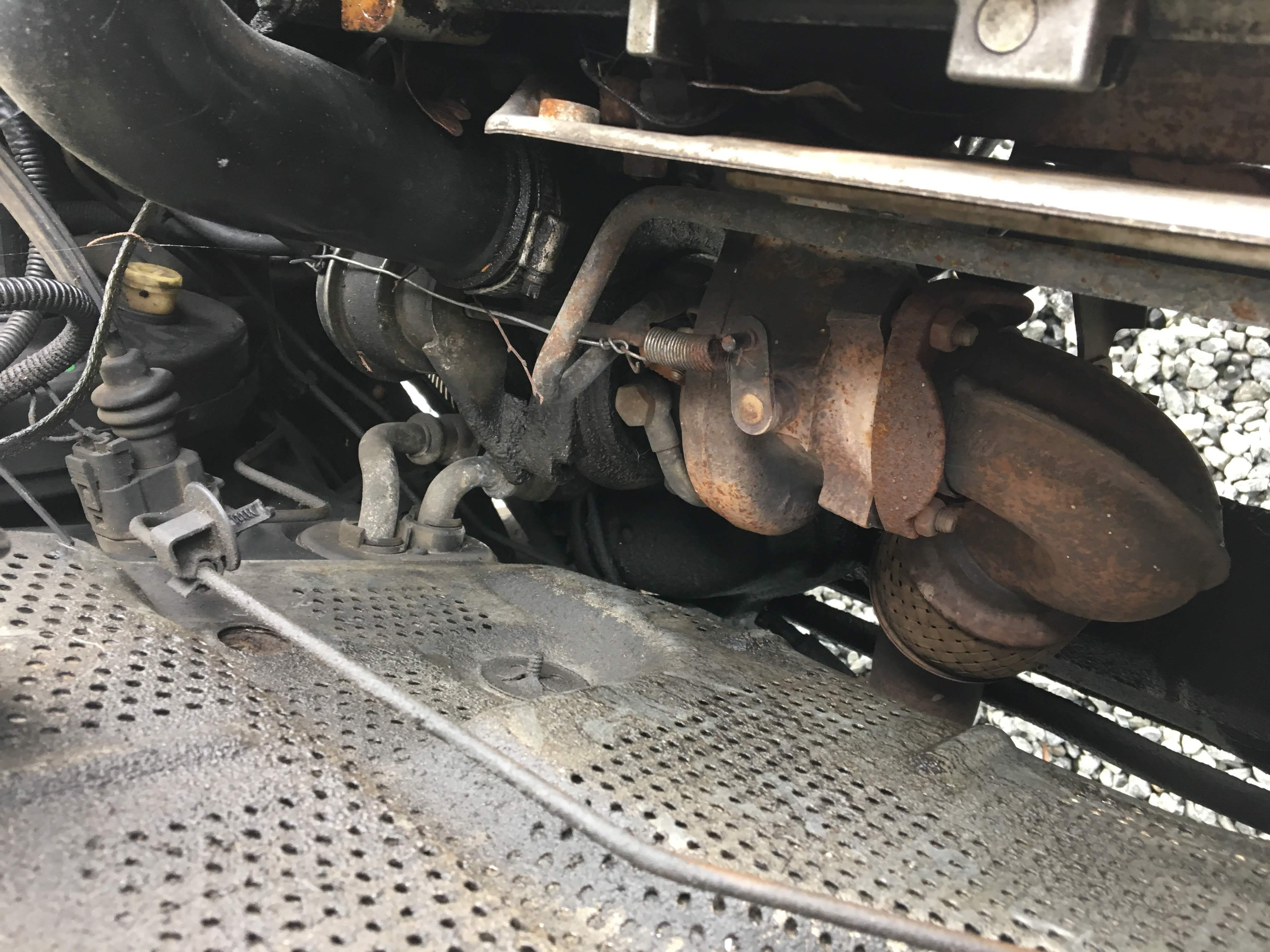

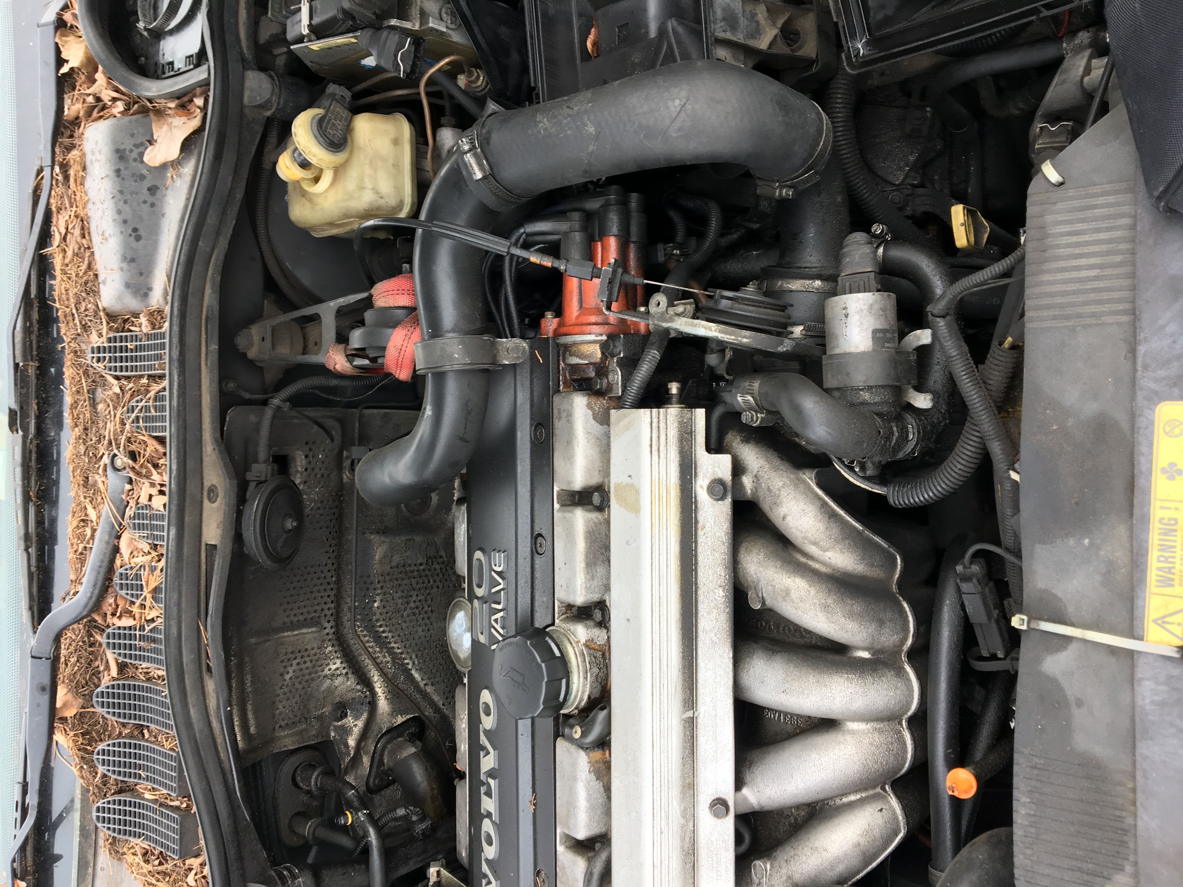

I also came across this gem at the junkyard today. Spot the problems...

That's hilarious! It's like those kids' activity books where you have to find what wrong with this picture.
I think the screw (and the "vent") in the PCV hose is my favorite. The wire-activated turbo waste gate (?) is a close second.
Was the upper mount "repaired" with a plunger?

Hahaha, I didn't even see that! That could explain the film of oil over everything!brunocerous wrote: 07 Dec 2018, 13:48 That's hilarious! It's like those kids' activity books where you have to find what wrong with this picture.
