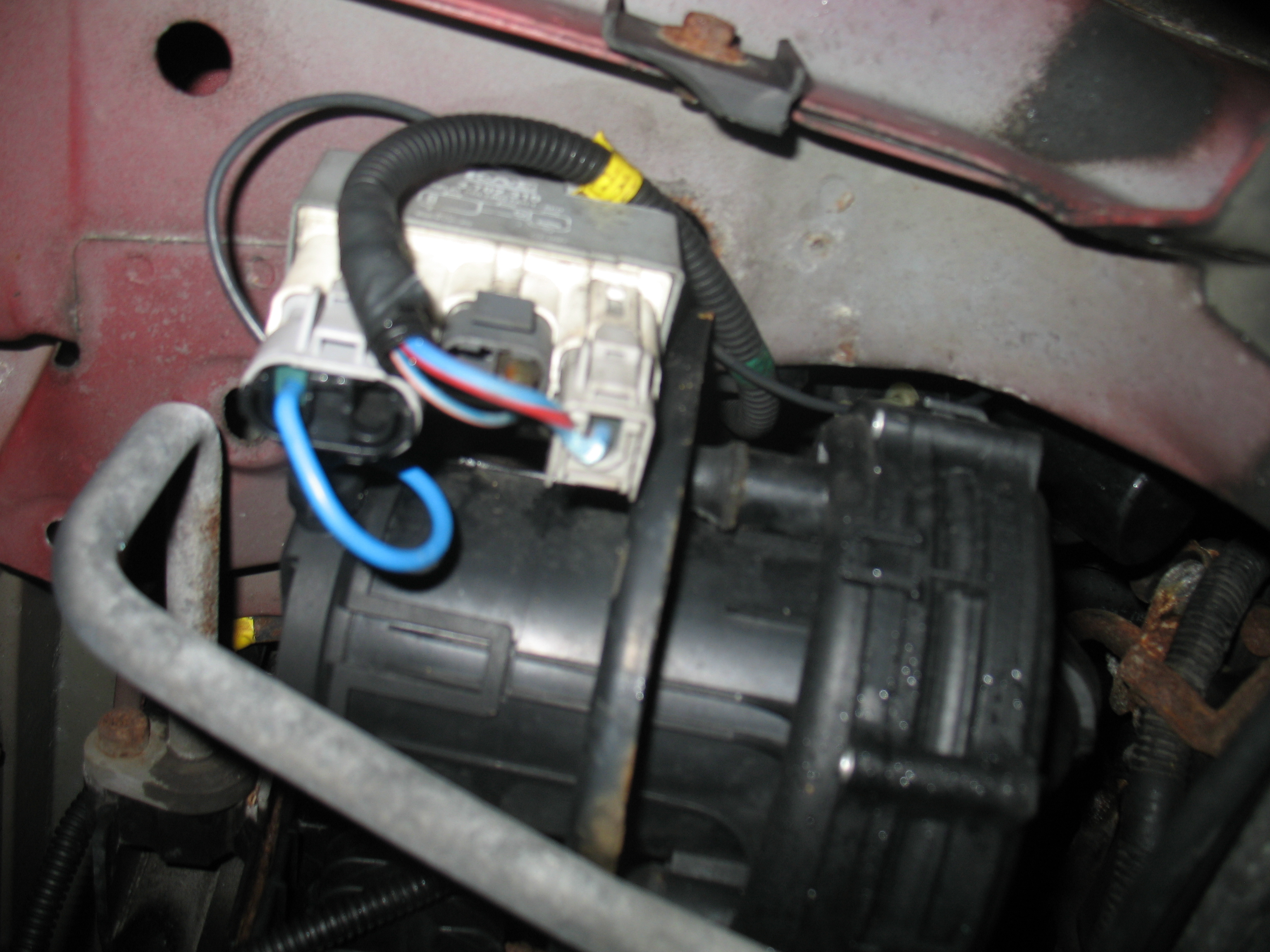

On my '97 850, here's the pump and relay - quite cozy together. I'd think your '98 would be the same. Just stuck my camera under the bumper and took the pic. If I recall, there's a clip that's a part of the pump bracket on which to mount the relay.

Yes that's were my 96' has the relay located, maybe previous owner took relay out of person who can't find there's, just a thought.vjaneczko wrote:On my '97 850, here's the pump and relay - quite cozy together. I'd think your '98 would be the same. Just stuck my camera under the bumper and took the pic. If I recall, there's a clip that's a part of the pump bracket on which to mount the relay.

You can also look by the fuse block by the drivers side strut tower, I know some of the V70's air pump relay is there and since a S70 is the sedan version of a V70 then yours should be also. Some of us were talking about the 850 models which are almost identical but some things have been moved around, Good Wrenching.Dave123 wrote:So here is the deal on my s70. The only wires coming out of the pump are the ones that go to the connector. The connector is located just behind the driver side headlight. I don't have the configuration shown where the relay and ground coming out of the pump are located right next to the pump. So where is the relay? Hate to think that I have to go to a dealer, yikes!!!!
