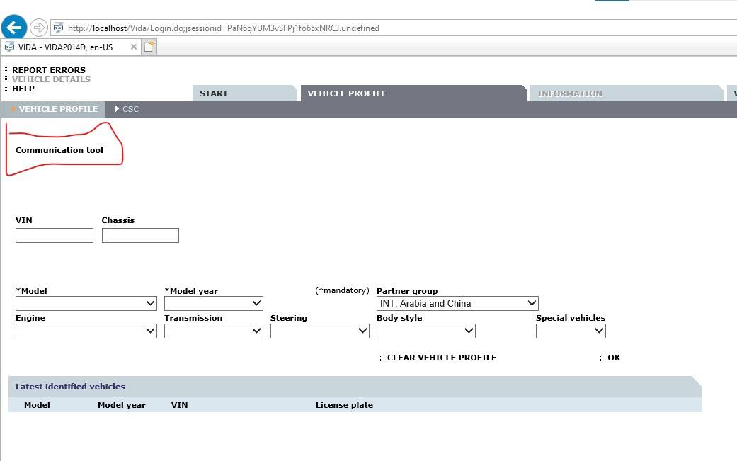

Can anyone explain why I can't choose the dice in vida? It's like Espen explains earlier in this thread but after several installs I can't seem to figure out what goes wrong. I've tried installing the vida script 2 and I have tried uninstalling everything and installing again. 1, 2, 3, 2099, 4 restart. same.
I'm on win10 pro 64 bit.
I've tried double clicking the vida logo in the system tray which opens vida in internet explorer, I've tried open it in edge and google. Nothing helps?

Vida DVD:\Install\Utils\EnableIEHostingxxx.reg .
Make sure you run the right one for your operating system.
xxx =x64 is for 64bit operating systems,
xxx =x86 is for 32bit operating systems
Reboot and login.

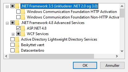

Did you make sure .net frame 3.5 is installed?

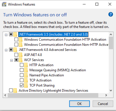

.net framework 3.5 is OK.
You might try uninstalling any .net framework 4.8 features you don't need.
Unless you are a developer building web apps you don't need ASP.NET.
