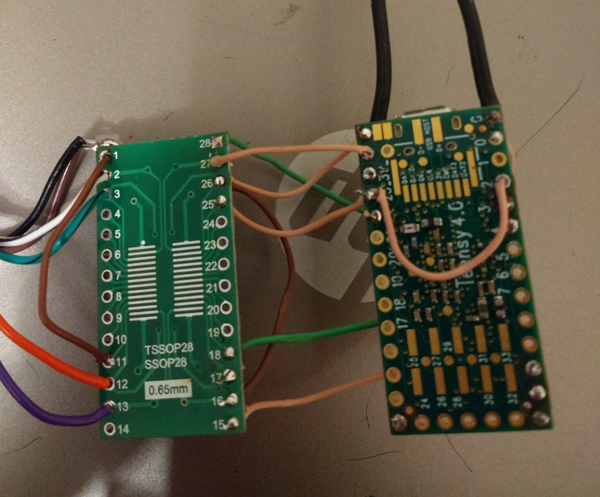

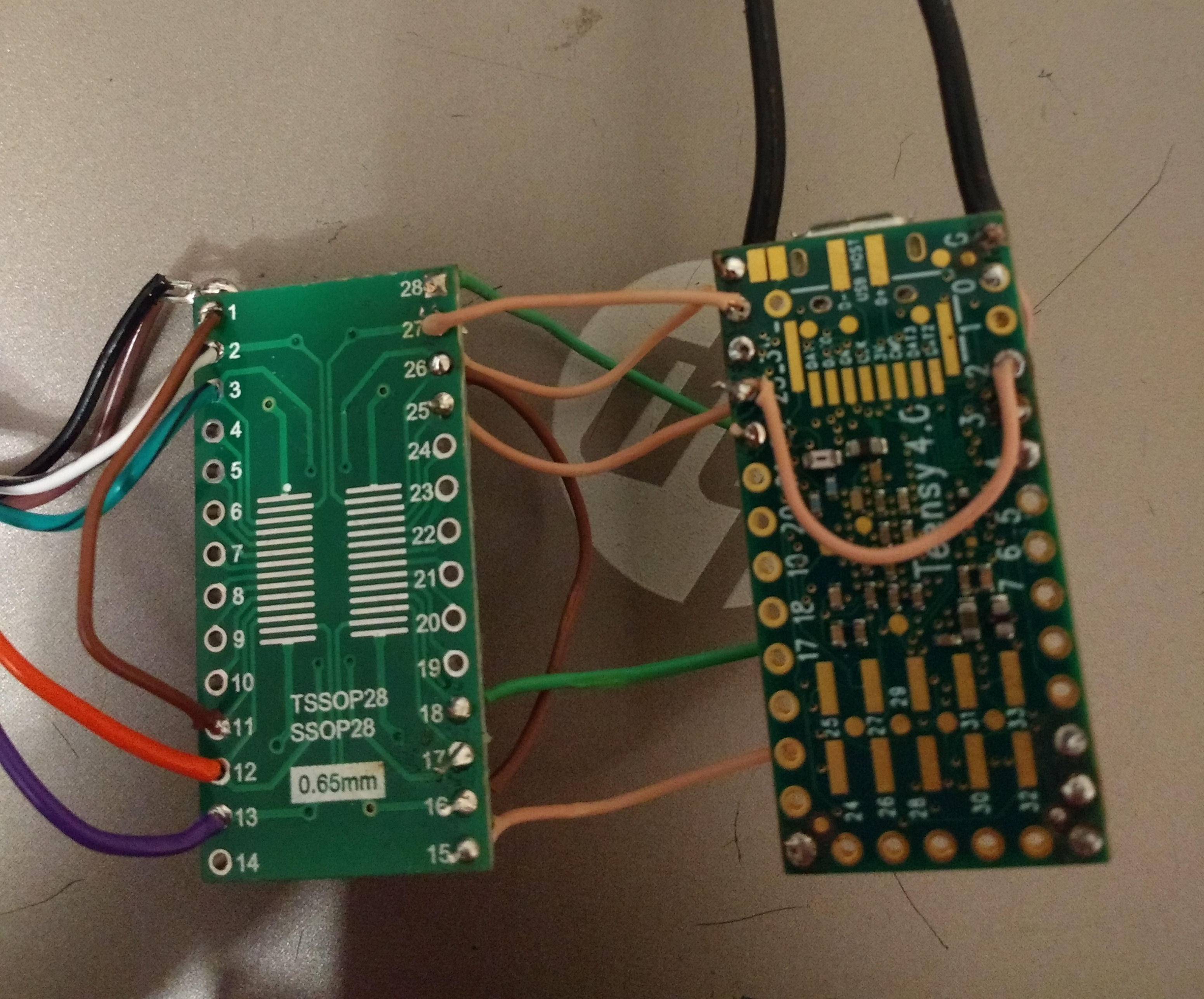

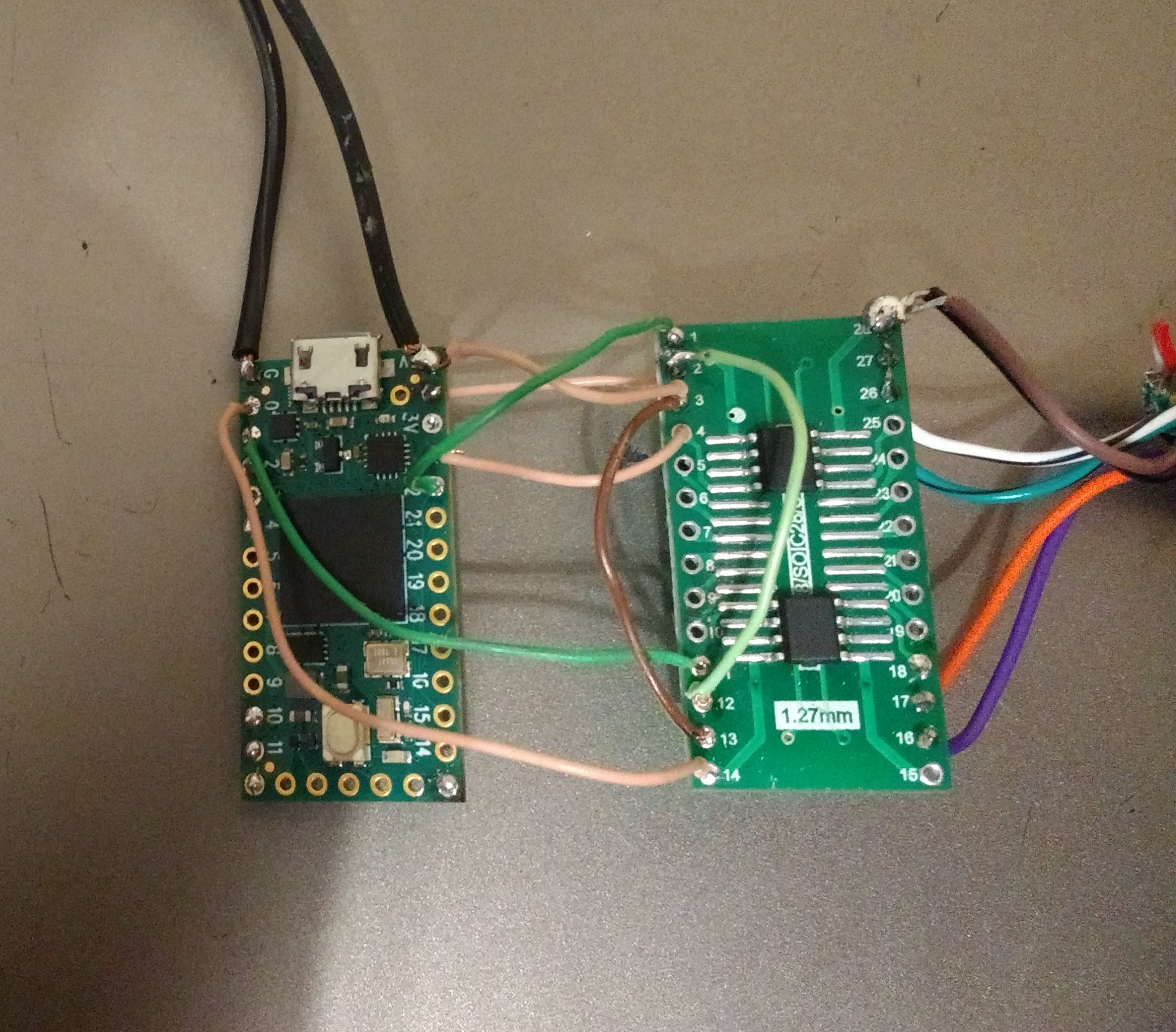

Hardware construction can make a difference. Particularly on the third byte, which is is harder to detect.Canadian Moose wrote: 31 Dec 2021, 08:50 Attaching serial output. Tried again this morning, no dice.
Post pictures of your hardware, close up and high resolution. We might be able to spot something.

Canadian Moose
- Posts: 82
- Joined: 05 Sep 2016, 19:28
- Year and Model: 2002 V70
- Location: Canada
Not my prettiest work but you get the idea.
