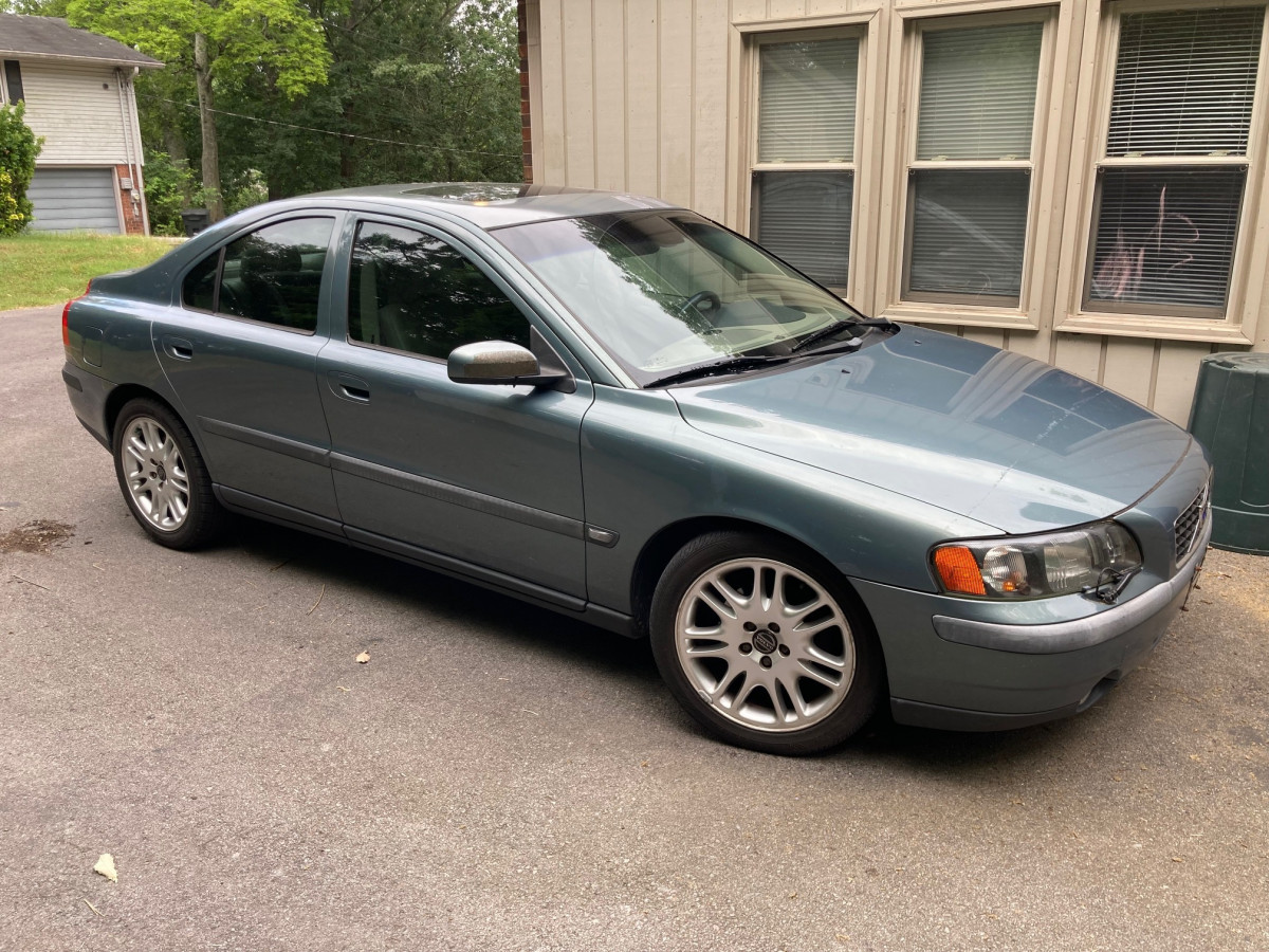

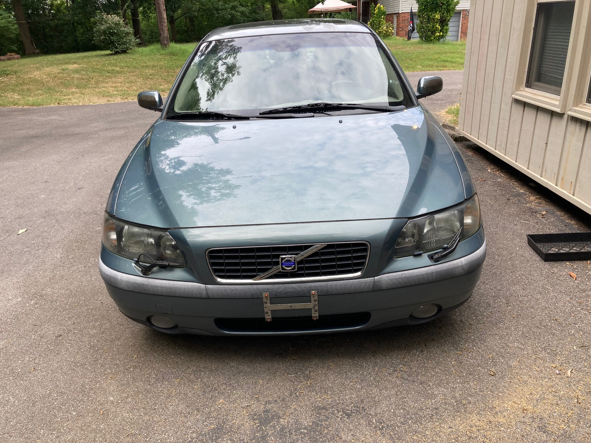

Finally finished removing the horrible, 17-year old clear bra from my 2004 S60 2.5T. Took a couple of hours, an entire eraser wheel, a bunch of Goo Gone, and a lot of patience - and I still need to come back for the mirrors and clean things up a little more.
But what a difference it makes!

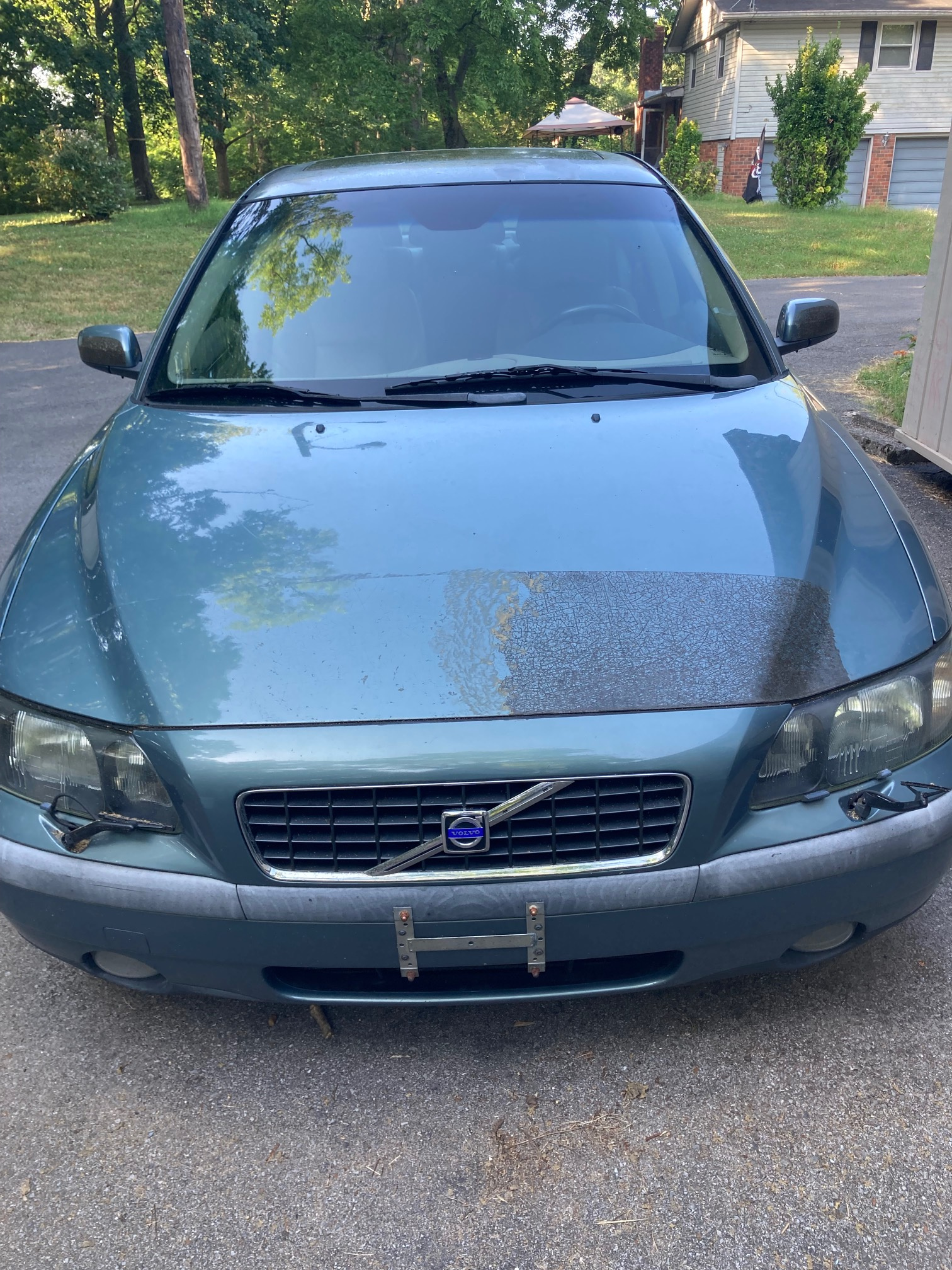

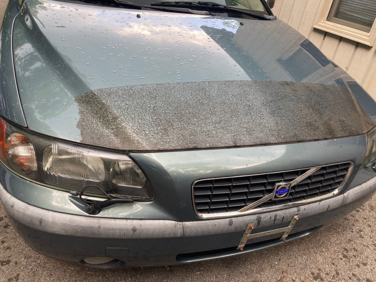

SkyVolvo wrote: 01 Jul 2021, 09:50 Finally finished removing the horrible, 17-year old clear bra from my 2004 S60 2.5T. Took a couple of hours, an entire eraser wheel, a bunch of Goo Gone, and a lot of patience - and I still need to come back for the mirrors and clean things up a little more.
I basically followed this simple video, if anyone else needs to do the same:
Well done!
Does anyone know if this method will work on peeling clear coat?

volvolugnut wrote: 05 Jul 2021, 14:01 Does anyone know if this method will work on peeling clear coat?
Nope, 3M wheel did no damage to the clear coat. I didn't want any damage.
P2 has a very thick layer of clear coat, which is hardened right. I think you may need either a sand blaster (would eat it down to metal), or some chemical aid to soften it up.

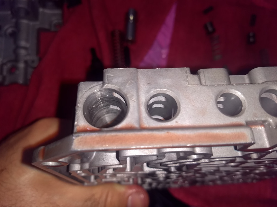

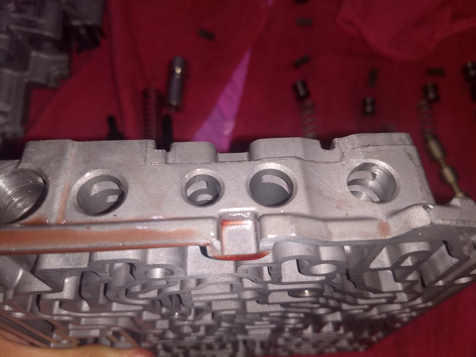

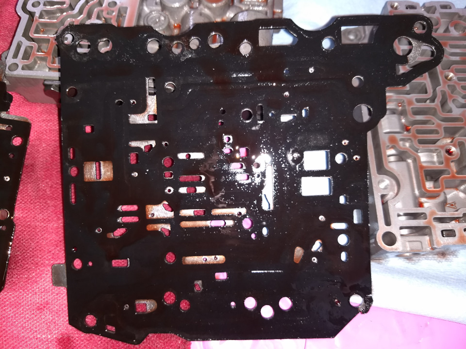

I was going to transplant the Sonnax valve body from my dying transmission to a rebuilt donor, however didn't likethe gaskets after 3 or 4 years of use. Split the VB apart and sprayed the passages with kerosene. It was clean, no clutch material residue, but anyways.

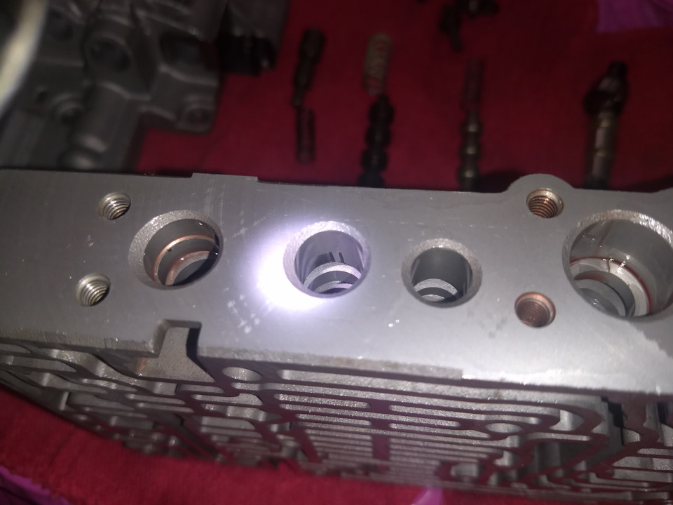

Post by vtl »
Well, ~$800 for Sonnax valve body 4 years ago was a big mistake. Look at the LPC bore wear! My ATF was never that dirty to cause any such damage! I'd better pay more for a new overpriced Volvo valve body or google better and find a new AC Delco VB for cheap.

abscate wrote: 09 Jul 2021, 03:08 Ooof, that’s awful.
At least it was clean. Partial drain&fill with Volvo ATF every 20-30k miles, some Lubegard HFM, external oil cooler and Magnefine - all of that does help greatly.
I took apart another VB, about 100k miles, probably w/o ATF flush in its lifetime. It was so dirty that I had problems removing the plungers from the bores. Two internal magnetic filters were very dirty, worse than in my Sonnax VB - and I'm rebuilding the donor transmission, because my is apparently failing mechanically, it grinds itself badly lately.
Two bores in Sonnax were rebored for oversized plungers. They look terrible (no mirror), but it seems they are ok.
LPC is not rebored, it has a lot of wear. Decided not to address it this time.
