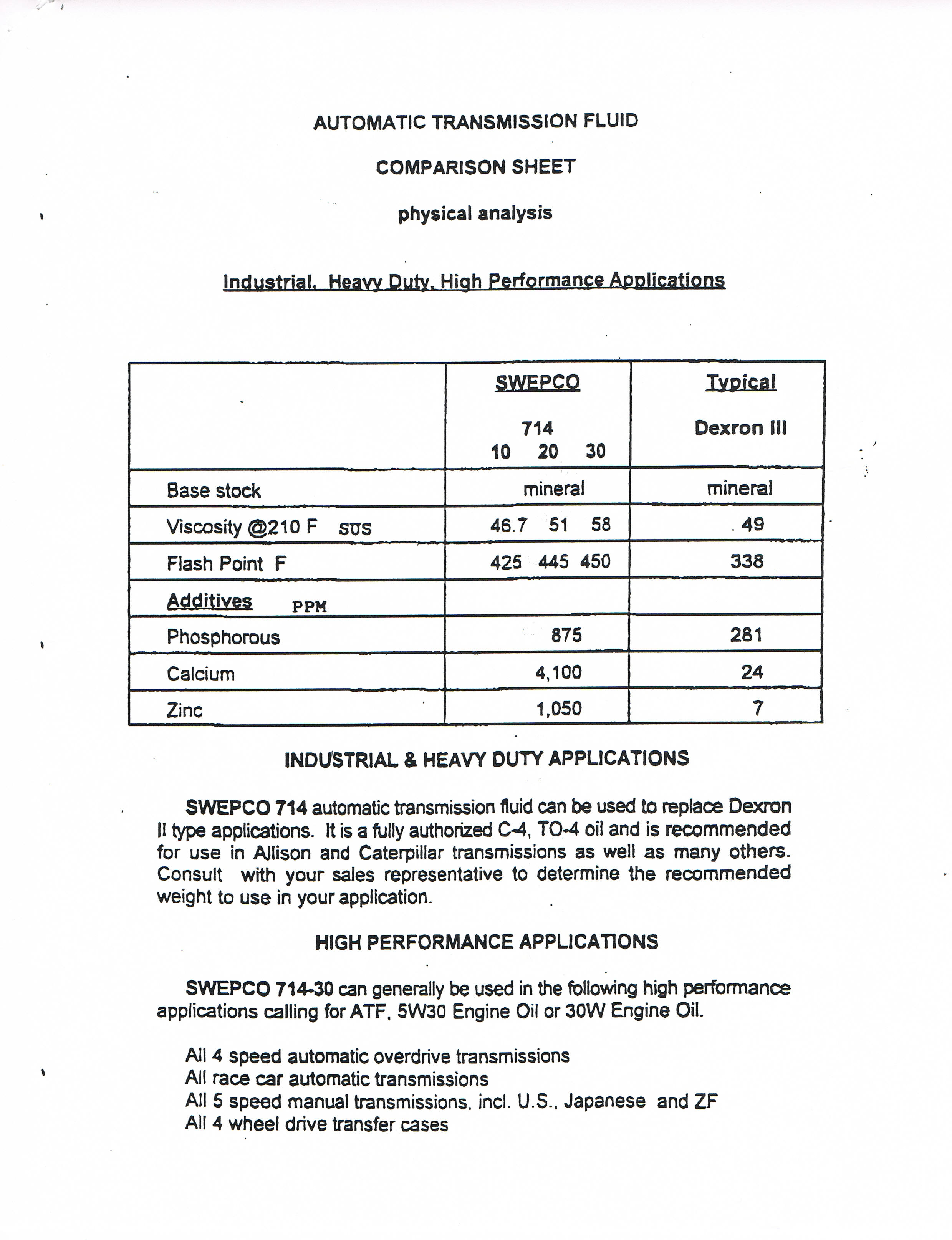

Add some Lucas Transmission stuff as TESTER and if it improves then the Pure Guard is just standard stuff. Do another Full Flush (8 to 10 Quarts) with Swepco 714 20W and you should have your Transmission back and better most of the time.
