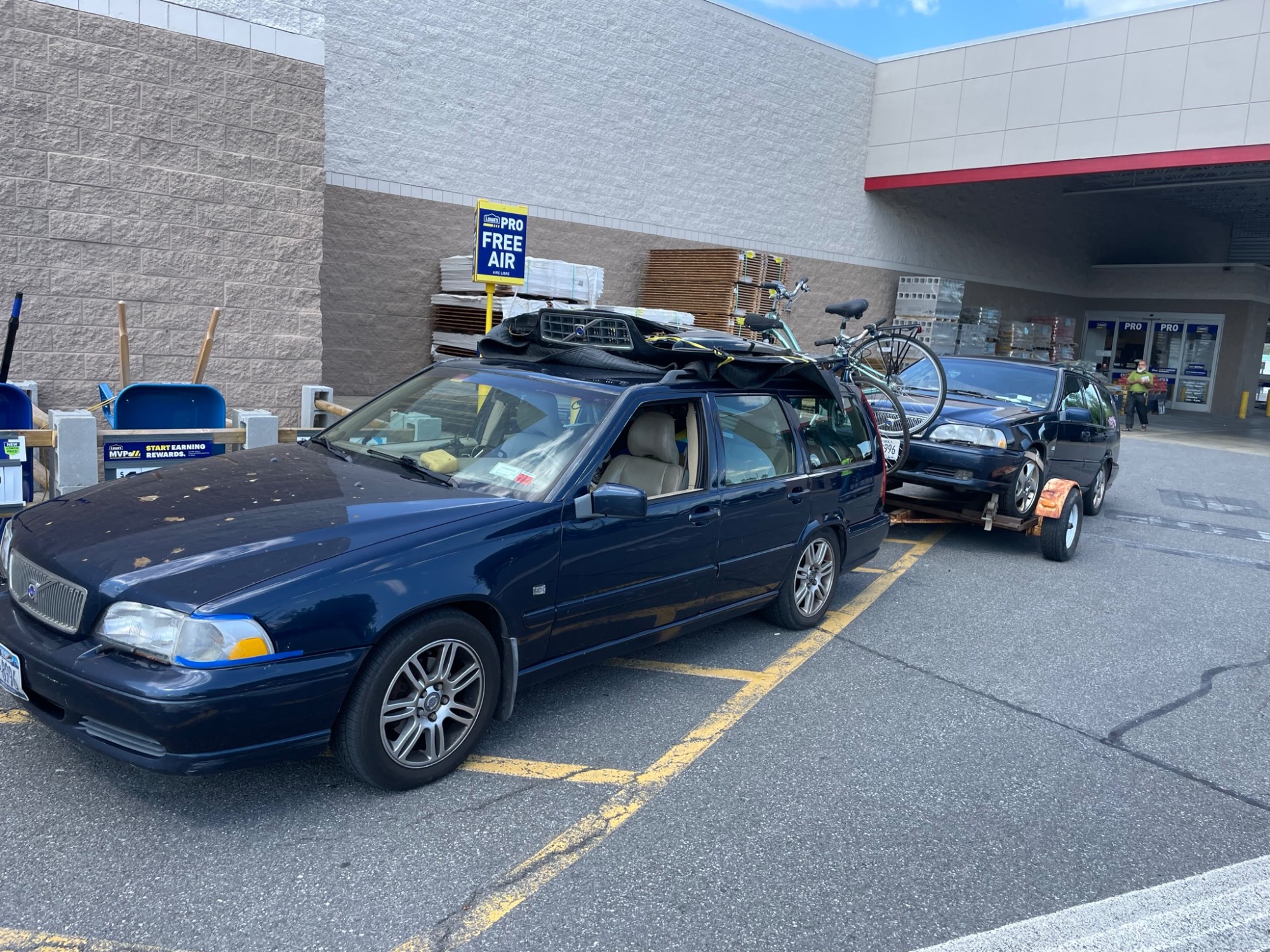

Geronimo got a bunch of used parts during a recent multi-state drive. First, I stopped off at abscate's place to pick up a black hood and fenders. I blended right in to his sea of Nautic Blue wagons with my Lunar Blue Mercedes. Thanks for getting these parts to me, abscate!
Then, I rode the high seas on the ferry off Long Island. I wonder if a ferry worker saw abscate bring this hood onto the ferry in a blue wagon, then saw me bring the hood on again in another blue wagon. They'll have to get used to it.

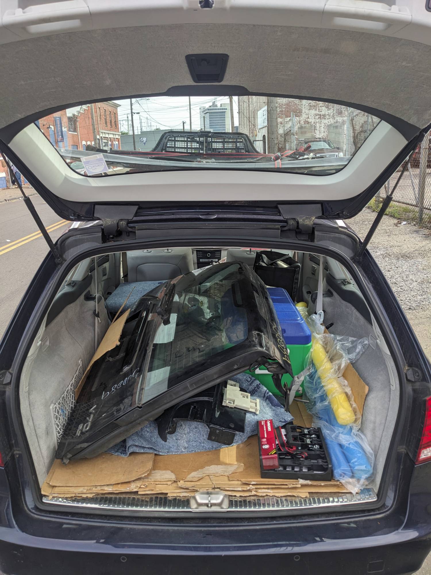

Just a few minutes from the port on the CT side, I stopped at a nice indoor used parts store. They had a nice black tailgate which had been in their inventory for about three years.
A short fifteen minutes away, I stopped at FCP to drop off used oil from two cars and some unneeded new parts. It was a treat to see the 850 race wagon in person.
I continued home, noting my bad gas mileage trying to go 75 mph due to the hood on my roof. When I dropped to 70 mph, my gas mileage increased noticeably, perhaps 1.5 mpg. The reduced speed made me feel a little better about the security of what was on the roof.

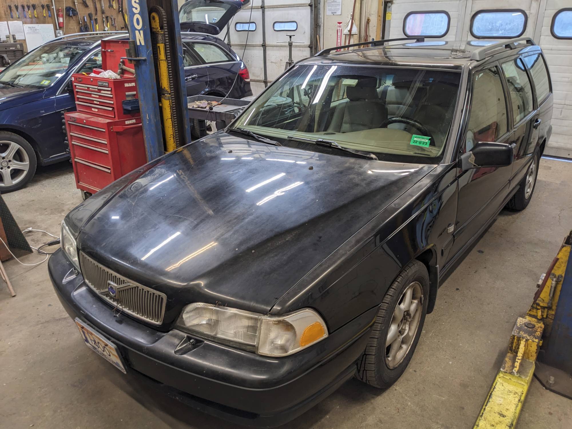

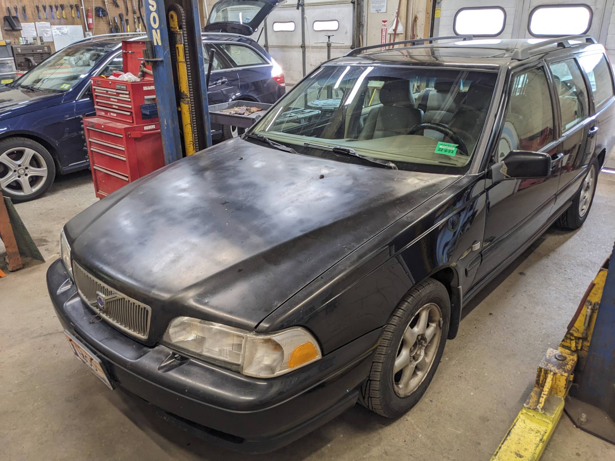

I finally got to install these used parts. The existing hood on Geronimo had rusted so the previous owner spray painted it. That process also got spray paint on the fenders which also have some rusty spots and dents, so they're slated to be replaced.
Replacing the hood was easy with an assistant. It has catches in the hinges to hold the hood both horizontally and vertically with the bolts removed. When I installed the replacement hood, I simply lined up the bolts with the wear marks in the hinges so the hood would align with the latches.
Unfortunately, I got a little carried away trying to clean the hood. I thought it simply had dirt on it, so I scrubbed it... a little much. Now there's an unfortunate, uniform layer of scratches in the paint. I'm going to ask my local detailer if they can buff it out. If not, I'll ask my local body shop if they have a low priced solution.

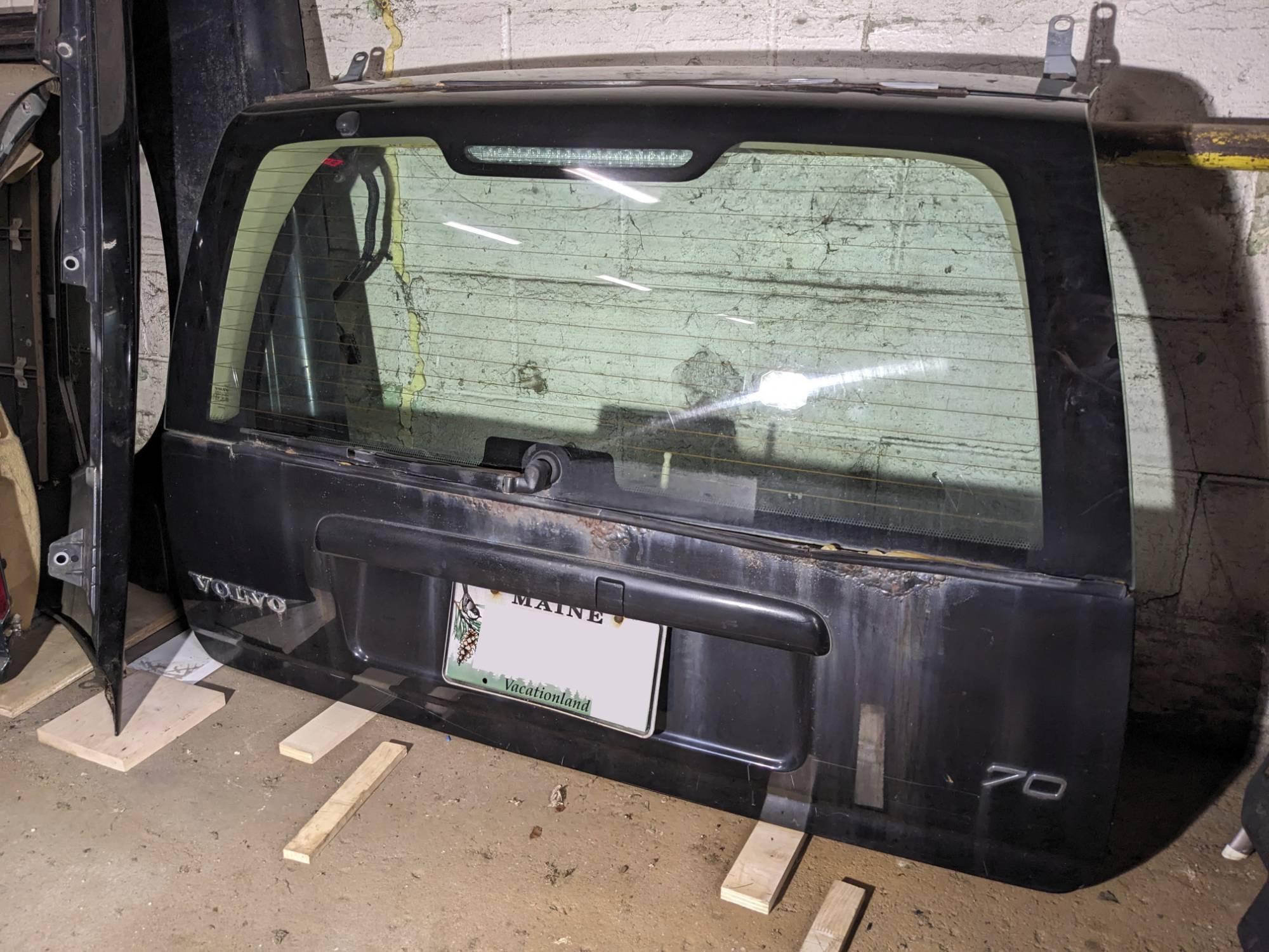

Here's the used tailgate installed. And look, now the car is a turbo! The tailgate had a spoiler at one point, long since removed by the time I got it. Would have been sweet to get both a gate and spoiler for one price (I saw this combo at a different junkyard but didn't call fast enough). I also replaced the struts while in there. Now the tailgate closes beautifully (might lack the firm grab I'm used to) and raises vigorously as it should.
Here's the old tailgate. I am glad to be rid of the rust staining and bulging, the glue applied to the seams to stop it. Most of the times I slammed the trunk lid down, rust from the inside would flake off into the trunk.

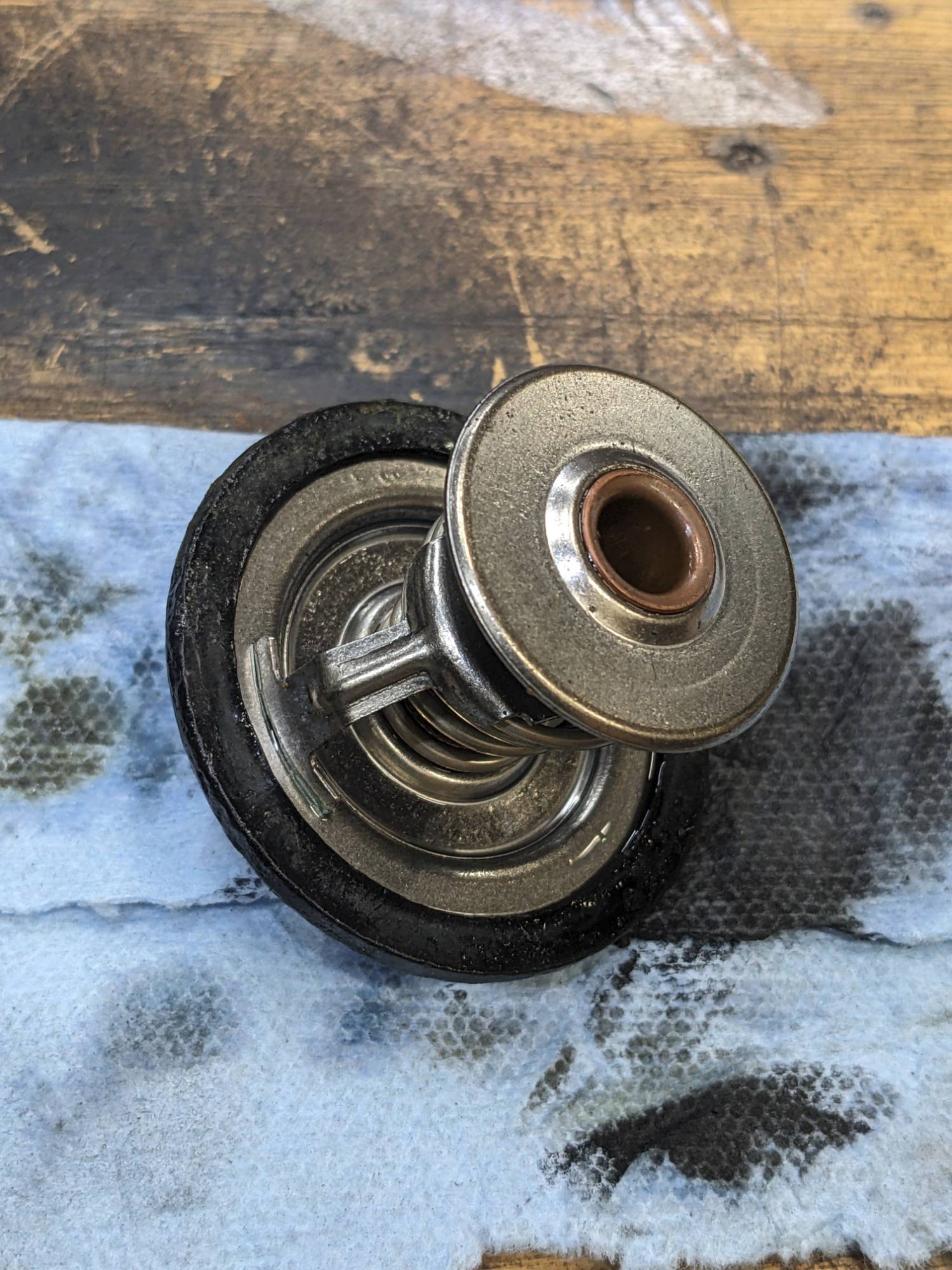

This is the thermostat I found installed. Any idea if this is a good brand? It's not Volvo or Mahle based on pictures, and it has no markings on it. I'd hate to be running a cheap thermostat which could fail and kill the car.

I don’t recall the experience with UNK thermostats , but it’s a critical life component, so Volvo only for me.
I have UBG spares in my stash
I think I had a skinny machined down 17 or 19 that let me get to the ECT without removing the housing but that’s a real fight. I always use new bolts on the housing if they are over five years old, Ni antiseize, and thermostat plus bolts plus coolant hits the FreeCP shipping metric!
The 87c thermostat for turbos is NLA, only the 90C one is used now. Not sure what this means, I’m not sure it’s very consequential
