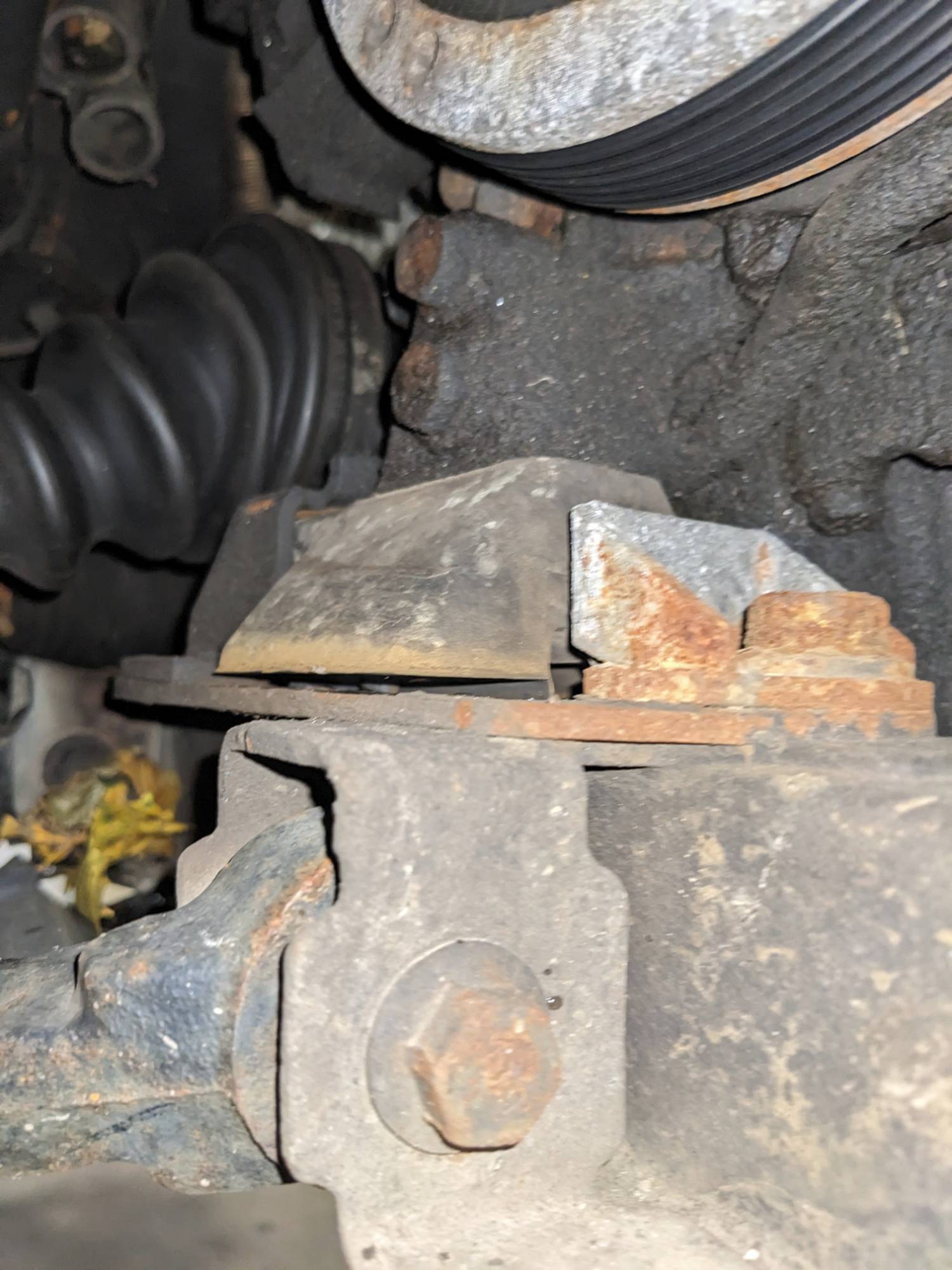

A clunking in the front right appears to be the engine mount under the crank pulley which is totally separated. The left inner tie rod boot filled with fluid and burst, spraying the transmission and axle with old fluid. I'll evaluate dropping the subframe to replace the rack and all of the engine mounts at the same time. I'll keep the old rack to try replacing the leaking seal and bending/flaring new parallel lines which are very rusty.
