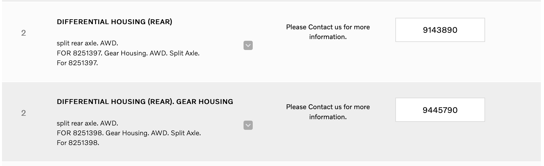

Time to find an awd scrapper and get you a diff on the cheap.
have you already dropped the rear axle subframe for the other work? If you know its free, it is about 4 hours to get that down again and open up the 'clamshell'
We dont have a lot of knowledge about AWD and R diffs on the P80 series here, maybe that needs some research.
It does ****appear**** parts are available for internal diff stuff...
https://www.volvopartswebstore.com/show ... veLine=457
