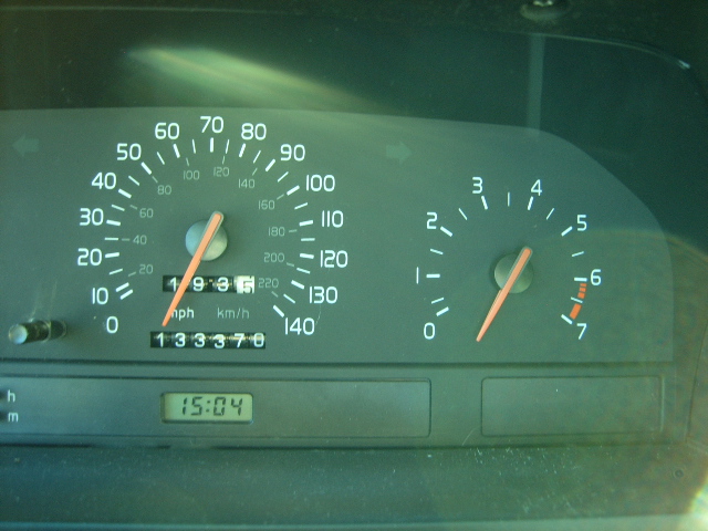

I just purchased a 1996 850GLT. The ABS light occasionally comes on while driving. The ABS works- I tried it a few times. But my other issues are the speedometer reads about 10mph lower than actual speed measured with a GPS (tires are 195/60/15-stock size), the tach reads zero at idle and about 2000 at 70mph (again measured off the GPS), plus the fuel guage reads lower than it should (the previous owner replaced the fuel pump, so that may just be him replacing the sending unit incorrectly). Does all or most of this sound like the ABS module? Thanks in advance for any help provided.

The problems with the instrument cluster are more than likely as a result of the cluster not being properly reset to zero after an odometer gear replacement. Snap a picture of your instrument cluster with the key off and post it back.

I suspect you are correct about not setting the dash back to zero, based on where the needles sit when the car is off. The dash has definitely been removed. I will find the posts about replacing the speedo gear and see if I can reset it. Thanks. And as for the ABS, I'll have to wait for some warm weather to tackle that project. Thanks again for your help.
