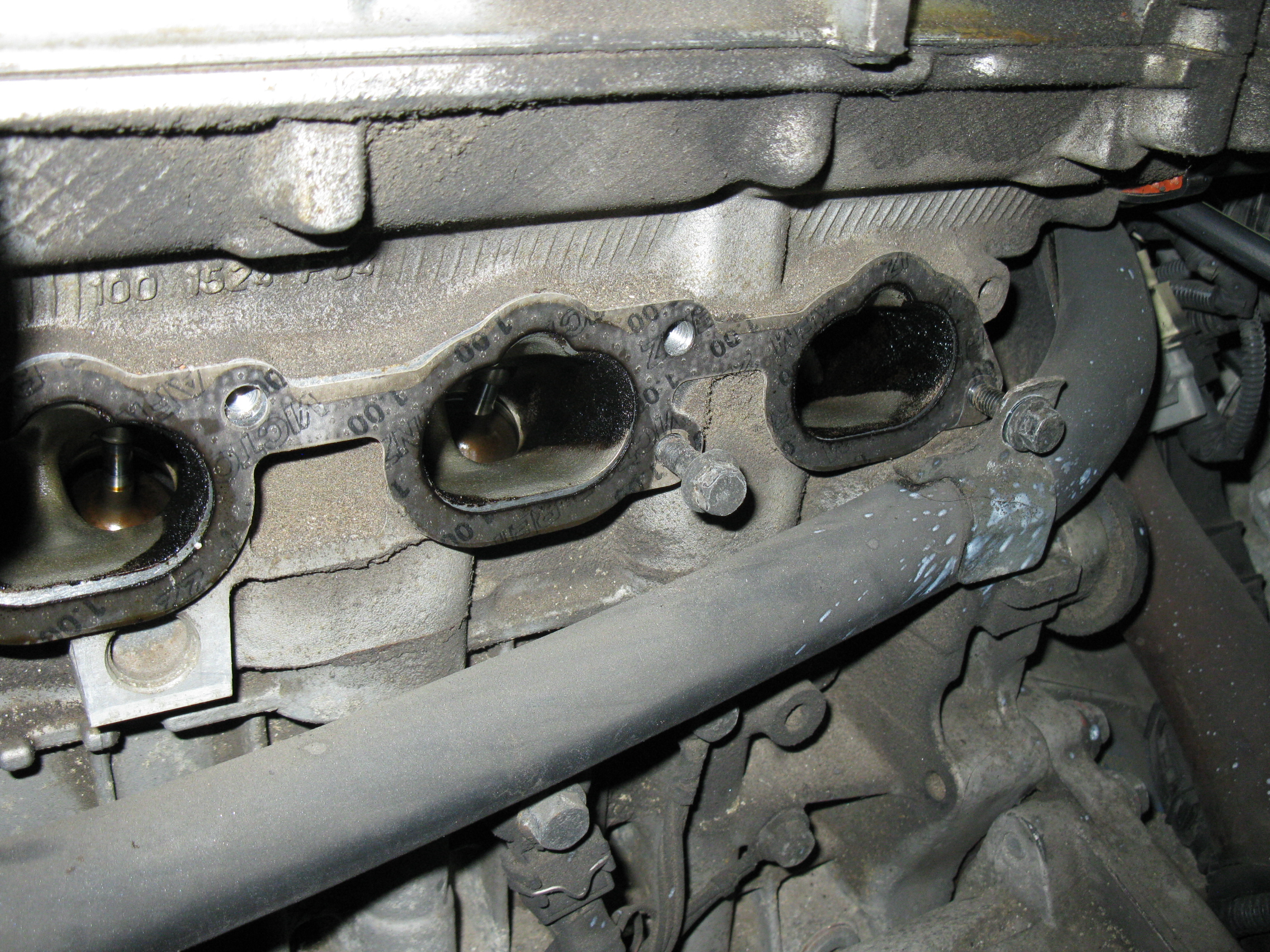

Hi again,
So I am moving through this procedure and after lifting the intake manifold I noticed these oily/gunky streaks on the lateral sides of the intake channels. Is this normal? If not, ideas on cause? Should I attempt to clean or does that risk contamination? Wait for some some sort of additive treatment like seafoam
Thanks for your ideas!

DAMN! i hope mine doesn't look like that when i do this this weekend. if it does though i am gonna reach in and pull out as much of that crap as possible and then brakeleen the heel out of anything i cant reach and then blow it out with air. good luck man, and thanks for asking some really great questions whose answers i will be taking into consideration when i'm knocking out mine

That is from the PCV not venting properly and oil being sucked through the turbo/throttle body hoses.
There's all kinds of degreaser sprays at auto parts stores - pick a good strong one and dirty up some rags.
I found a wrench dropped down below the intake manifold, and a 10mm socket from when I did the job the first time. It was a pretty nice wrench too!
