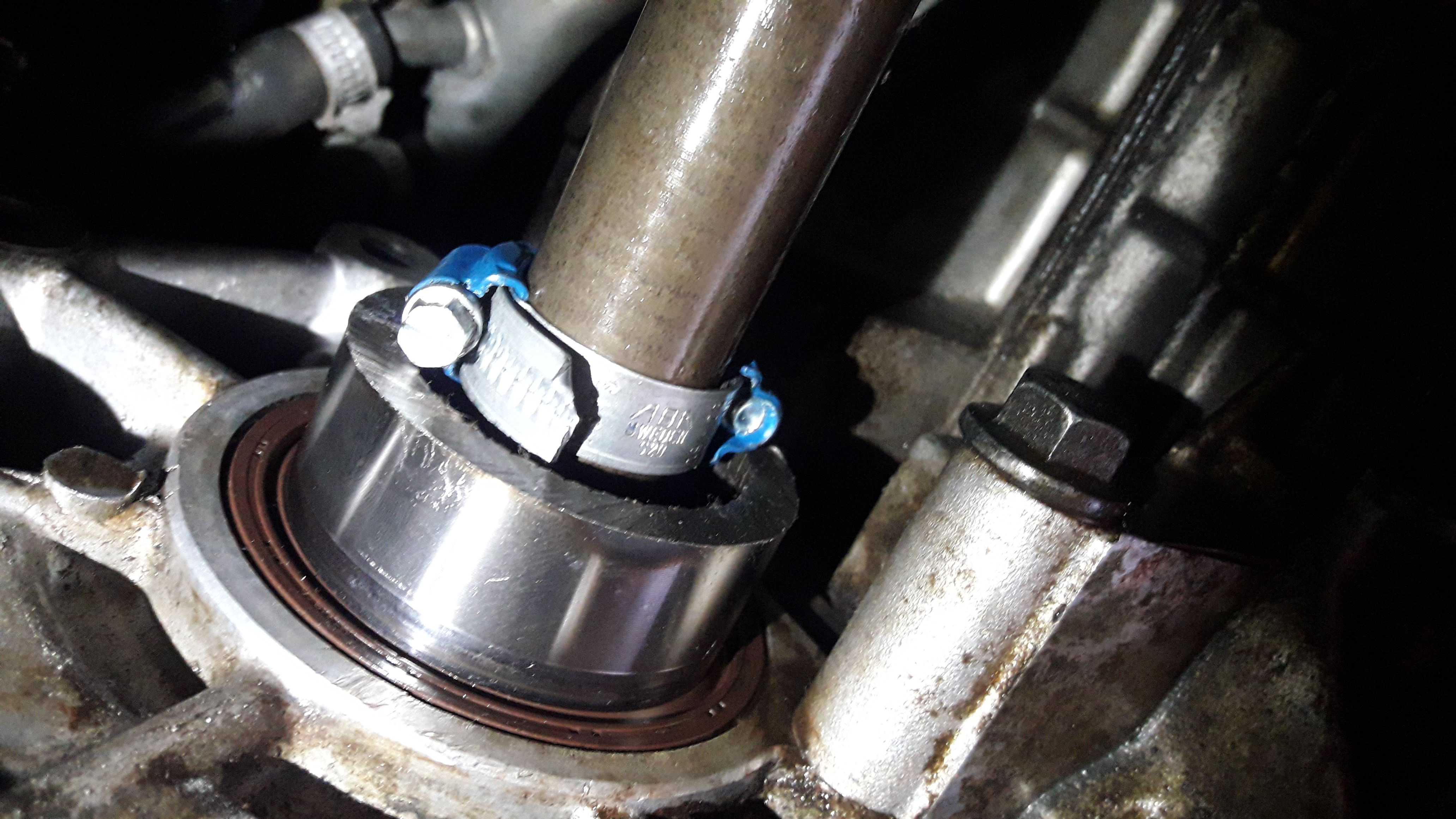

Not today, but last week I finally found the courage to get rid of the angle gear as per Ed Sykes' Ghetto Procedure involving hose clamps.
Thank you Ed for sharing your pics earlier, this inspired me to do the same!
I managed to reuse the sleeve that had been welded up to the angle gear before by grinding it in half.

I'm beginning to wonder if that's what killed the AW55 I had in my V70R before I bought it. Maybe all the fluid drained out from the smaller diameter axle. I can't remember exactly how it was set up.

There is a hollow shaft with splines on the outside coming from the transmission. The sleeve goes over this splined shaft and connects the trans to angle gear.bmdubya1198 wrote: 22 Apr 2019, 12:35 I'm beginning to wonder if that's what killed the AW55 I had in my V70R before I bought it. Maybe all the fluid drained out from the smaller diameter axle. I can't remember exactly how it was set up.
The RH drive axle slides into the hollow axle. So there is two seals: one on the inside of the hollow axle, sealing the RH shaft. The other goes around the sleeve, sealing the splined shaft+sleeve. So, you need a sleeve on there to create a seal.
To ensure it doesn't leak between the splines, I sort of glued the sleeve to the shaft using Loctite silicon sealant.

Ah, that's right.jvl wrote: 22 Apr 2019, 14:59There is a hollow shaft with splines on the outside coming from the transmission. The sleeve goes over this splined shaft and connects the trans to angle gear.bmdubya1198 wrote: 22 Apr 2019, 12:35 I'm beginning to wonder if that's what killed the AW55 I had in my V70R before I bought it. Maybe all the fluid drained out from the smaller diameter axle. I can't remember exactly how it was set up.
