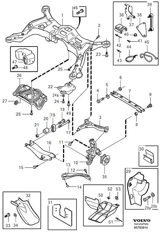

I failed with the ratchet strap method until I realized that disconnecting the control arm stay laterally greatly decreased the force required. After that it was relatively easy (compared to before that when it was literally impossible).YV1LW wrote: 14 Jul 2022, 05:56 An unappreciated issue is the force required to pull the suspension down. While VIDA instructions make the use of a ratchet & strap seem like an easy proposition; I found that anything less than 1.5" wide was just not able to create the pulling force required. I ended up with 1.5" strap and still found the use of a long 2x3 and a block to persuade the suspension down helped get more tension on the components.

I also had trouble with the strap procedure with my XC70, though I did eventually get it to work combined with levering down the arm a bit when reinstalling the assembled shock tower.enotslim wrote: 25 Jun 2023, 05:43I failed with the ratchet strap method until I realized that disconnecting the control arm stay laterally greatly decreased the force required. After that it was relatively easy (compared to before that when it was literally impossible).YV1LW wrote: 14 Jul 2022, 05:56 An unappreciated issue is the force required to pull the suspension down. While VIDA instructions make the use of a ratchet & strap seem like an easy proposition; I found that anything less than 1.5" wide was just not able to create the pulling force required. I ended up with 1.5" strap and still found the use of a long 2x3 and a block to persuade the suspension down helped get more tension on the components.
Could you please ID in this diagram the fastener number(s) you disconnected (if they are shown?)? Thanks!

The fastener I disconnected is 8 and 9 in the diagram in your post - connecting 7 and 10. The other end of what I'm calling the control arm stay (7 in the diagram) houses the eccentric bolt mechanism (4, 5 and 6) used for alignment, which is one reason not to disconnect that end and require a new alignment. Reattaching the fastener 8 and 9 required a lot of prying to align the stay with its connecting piece (10). (Might have gone back together more easily by disconnecting at 4/5/6 and accepting the need for a new alignment. I aligned anyway.) I found the names to be pretty confusing. 7 was sometimes referred to as the control arm, which it clearly is not. It looks like 10 is the "knuckle" and 3 is actually the control arm. "Control arm stay" seemed like the most sensible name for 7 but now I think this may also be confusing, since it does not connect to the control arm 3 (even though its function in alignment may be mediated through the control arm 3 with the knuckle 10 as an intermediary). Anyway, I had to take 7 out of the picture before the ratchet strap method would work. This was the only step that had previously prevented replacing the rear strut tower from being a one-person job (as abscate can attest).erikv11 wrote: 25 Jun 2023, 08:11I also had trouble with the strap procedure with my XC70, though I did eventually get it to work combined with levering down the arm a bit when reinstalling the assembled shock tower.enotslim wrote: 25 Jun 2023, 05:43I failed with the ratchet strap method until I realized that disconnecting the control arm stay laterally greatly decreased the force required. After that it was relatively easy (compared to before that when it was literally impossible).YV1LW wrote: 14 Jul 2022, 05:56 An unappreciated issue is the force required to pull the suspension down. While VIDA instructions make the use of a ratchet & strap seem like an easy proposition; I found that anything less than 1.5" wide was just not able to create the pulling force required. I ended up with 1.5" strap and still found the use of a long 2x3 and a block to persuade the suspension down helped get more tension on the components.
