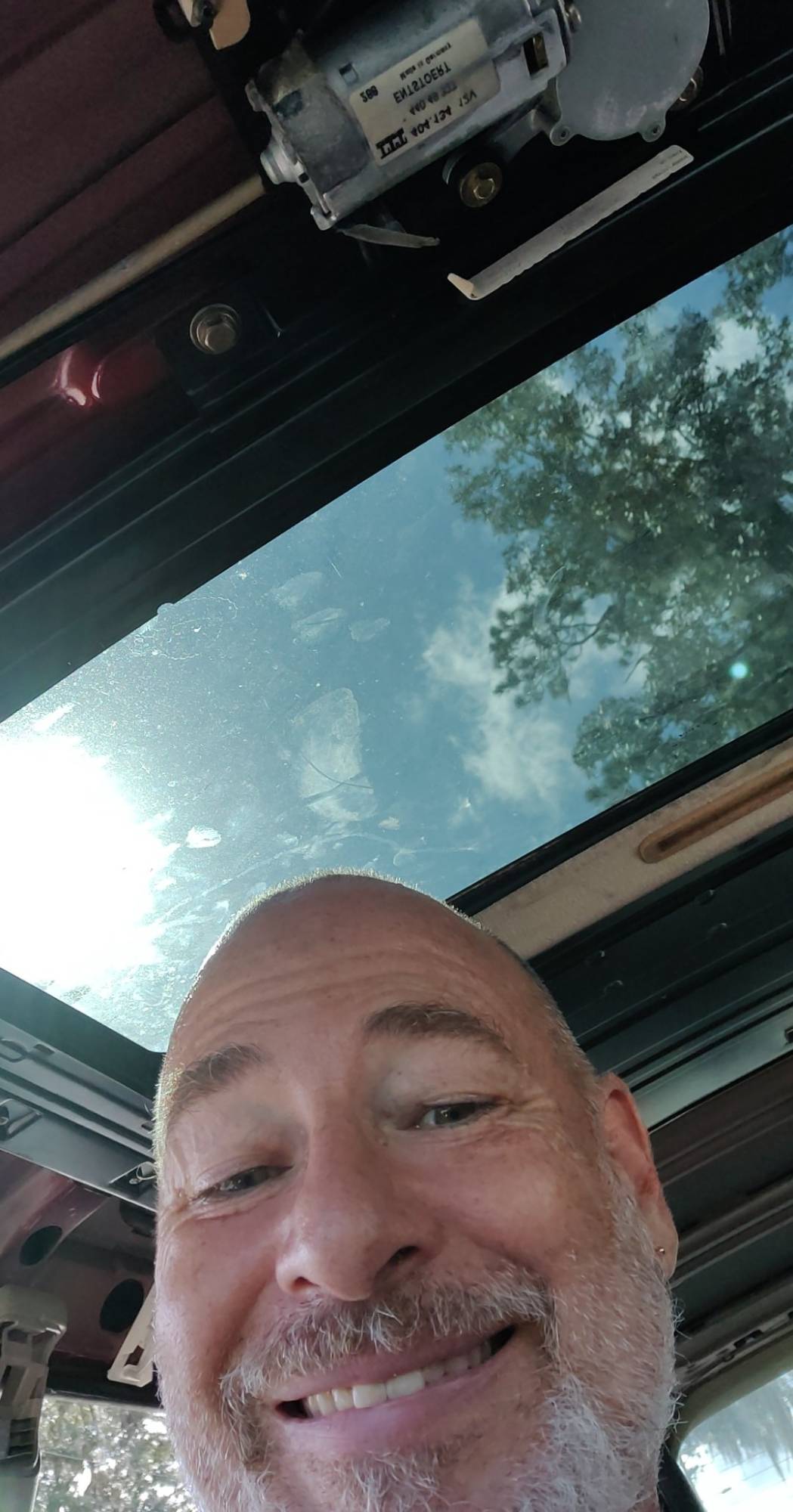

Hey Neil!
Yup, got the full cassette, no alignment needed ,
Once headliner and trim is out.....the new roof popped right in.
Had a buddy hold and raise it up into place, approx 9 bolts, (10mm) later, and all popped into place.
Questions:
What should I grease the slides with? Whit. Lithium grease, or will WD40 do for now.
And ...
The slider moonshade part, any suggestions how to clean off a few spots?
Now to put the headliner back in with all the trim, that is a future project! Hahaha
Thanks for all the help along the way.
If anyone needs to do this job, pm me and will be happy to talk and share the pitfalls, there are only a few.
