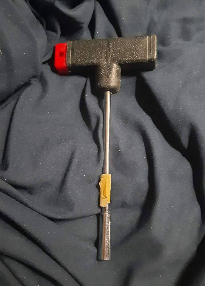

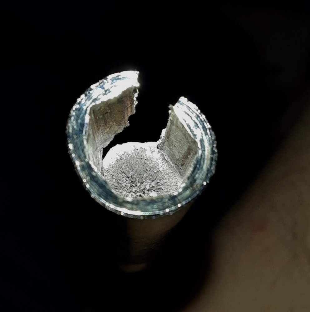

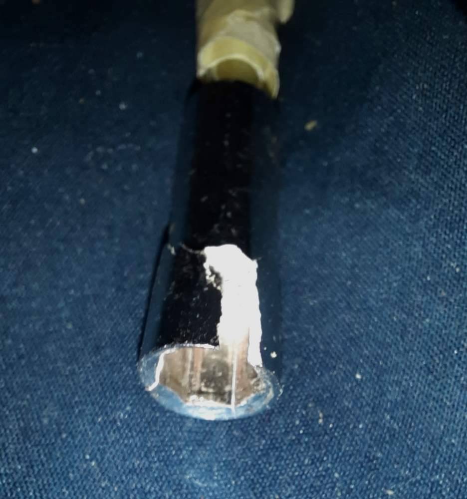

But here are some pics of the wrench that broke trying to get the spark plug cover bolts out. There are 6 bolts on this car and 5 were difficult to get out but that last one, the 6th one, which was the last one i tried to loosen, i was beginning to think would never come out without drilling or grinding or something and i didnt have those tools with me at the time. The wrench as actually a T handle for the T30 bit (see pics) and after it broke i was lucky i brought out my adjustable crescent wrench. Adjusting to just 1/4 inch, it had to be adjusted tight in order to prevent rounding around the corners of the T30 bit hex shank. After that it did loosen then i was able to use my regular hand screwdriver type bit tool which lucky i brought that out with me too.
The wrench isnt an expensive wrench, but i was surprised the metal could break in that way. See pics.
The first pic is the tool itself, the last pic is the best showing the break from the socket end of the tool.

I’ve lost count on how many shitty tools that has broken off in my hand. I only buy quality brand hand tools ever since I understood how much shitty crap that comes out of China. They try to save money on exactly everything so they can sell cheap. I had a scooter once made in China. I probably spent more time repairing it than driving it. Every single component on it was manufactured using inferior materials.

I have that same 1/4" drive T-handle. It's over 30 years old.

I have broken maybe 3 x 1/2" breaker bars. Snapped the heads right off them. Mostly trying to undo or tighten the front hub nuts on -98 P80's or removing lug bolts fitted by Trolls. I invested in an impact wrench and a 3/4" hub nut socket and breaker bar. Then decided it was easier to buy a 99- P80!! :lol: :lol:
