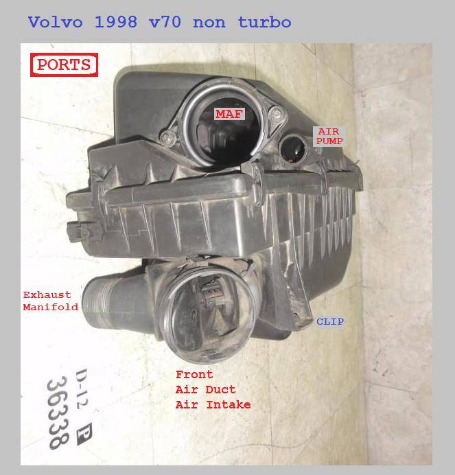

Hi Neil,scot850 wrote: 14 Jan 2023, 14:51 This picture is the airbox on it's side. The connector is the tube currently facing to the ground. It is hard to see from above. The plastic has ridges in it on the airbox end to hold it on.
https://www.ebay.com/itm/203581409055
Oh that's a nice picture thanks.
I rotated the pic right side up and labeled the ports.
Is this new drawing correct?
Also, i take it the box is held down with that one clip as labeled in the pic also?
Thanks.

I think there's 3 places where it's held down. It's a rubber plug type deally. You just have to pull and the box will come out after everything else is removed.
The top side of the rubber thing fits in the box, and the bottom fits in a plastic tray that's bolted to the car. I guess they're so the box can move a bit yet is still restrained enough to stay in place. The first time I removed the air box on my 850 I thought the rubber pieces were in horrible shape, but they were just dirty. I scrubbed them up in the sink with an old tooth brush and cleaner, and I realized they were fine.

Correct labeling. There are 2 pins on the far side we are looking at that push into rubber bushes on the inner fender. There are 2? feet at this end and you can see one of them. They snap onto 2 splayed plastic barbs.
