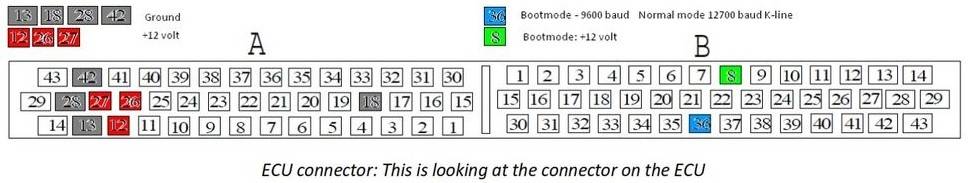

Maybe it´s a stupid question, but how works the numbering of ECU pins? I could not find the pin that has continuity to ECT sensor ground on connector. I am sure only of those pins on the picture. Their numbers on schema are 31 and 32. Have no idea what is the numbering system and which pin or pins ,,should,, be the sensor ground 18.

I think that is the best pic I have, maybe someone else has some more info on the connectors. Note its from a me4.4, but shouldn't matter for numbering.
