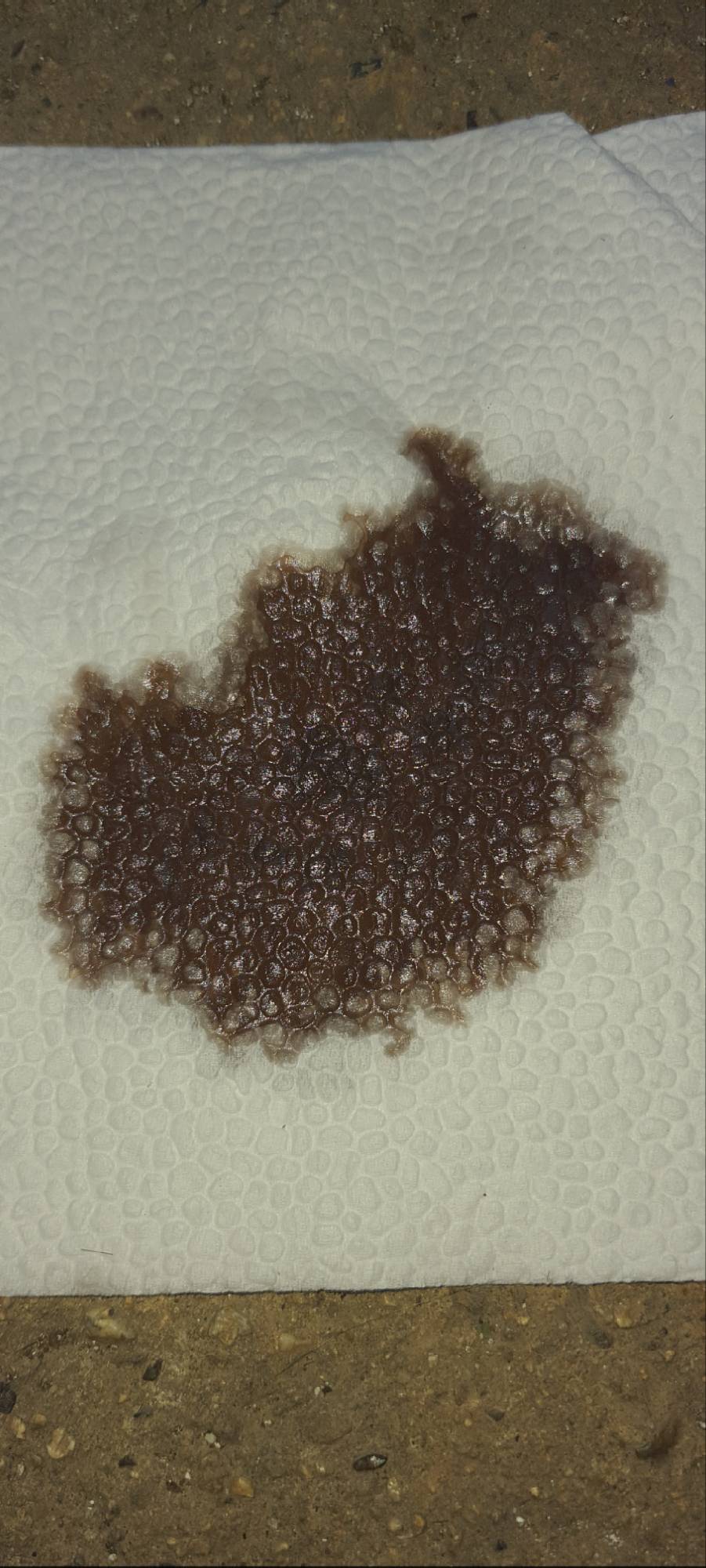

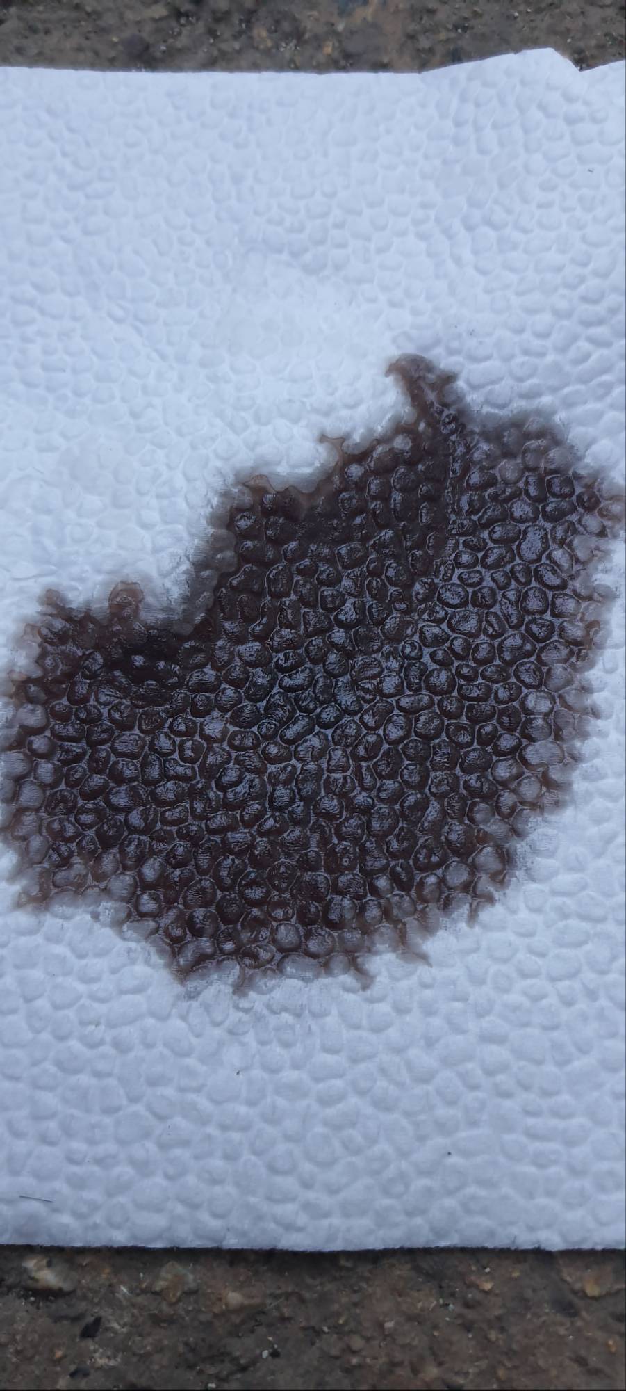

Post by dikidera »
Here is the condition of the used fluid before the very last drain fill.

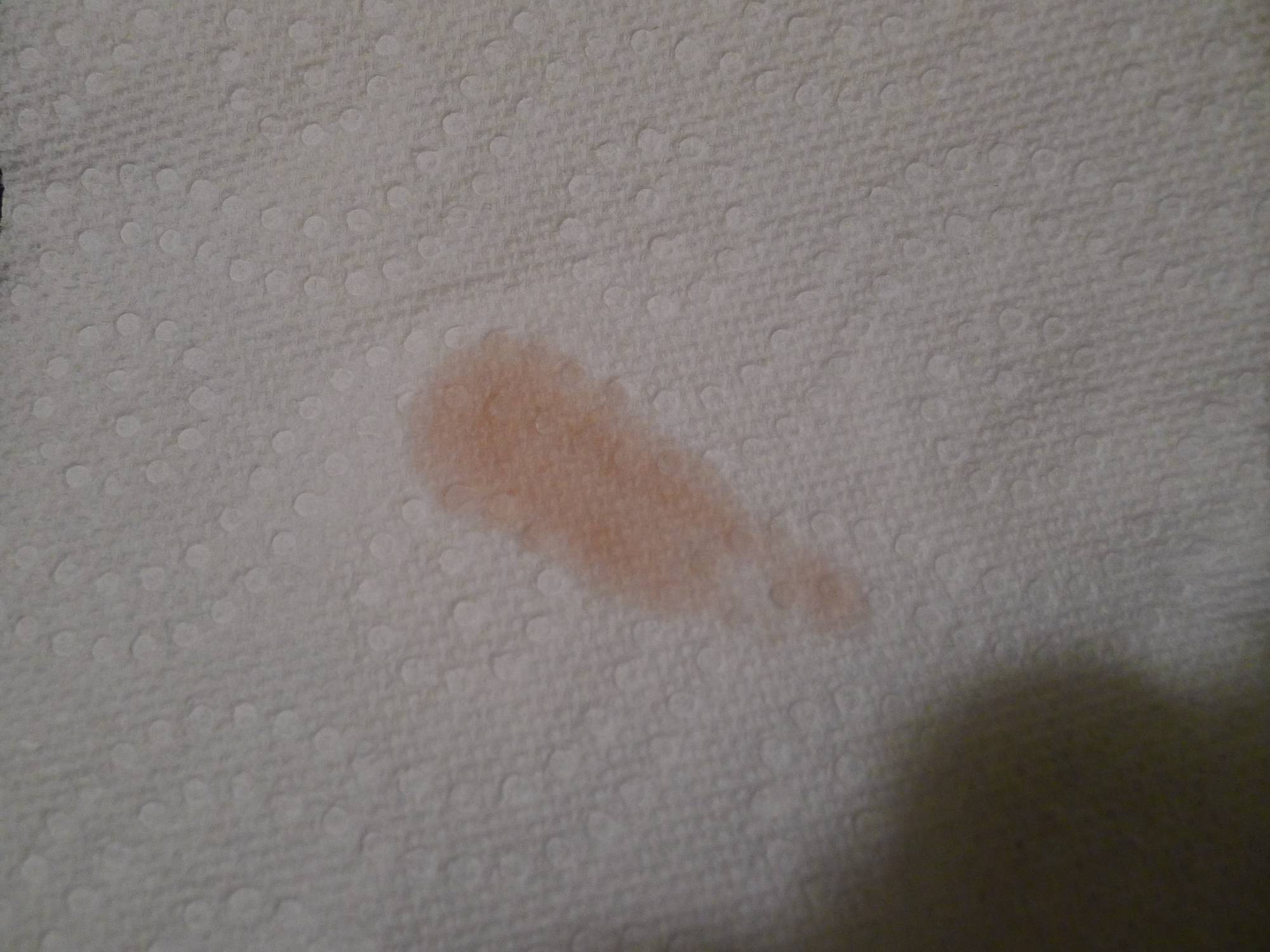

Post by ignatz »
This is my atf fluid in my 02 V70 2.4t this morning. The last drain and fill was about one year ago. I'll probably do another drain and fill next year to keep it red, but its probably not necessary.
Remember that my original fluid was as crappy as yours, but I did more drain and fills.

Post by Krons »
The horse is dead but I’ll offer this last swing of the switch. I’d estimate you’d need 10 gallons of fluid with drain and fills to get that fluid clean being so filthy. I cannot imagine highly machined valves functioning well with that fluid.
Unfortunately money was likely wasted on any additives. Apologize for a disgusting analogy—kind of like cleaning a toilet with a turd in it. With no slippage and your shift quality I cannot think of a better trans cooler return flush candidate.
