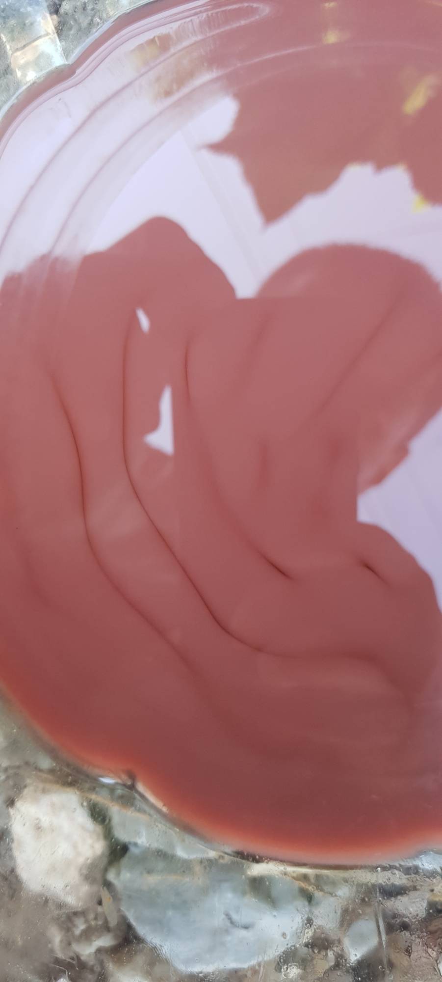

So far the transmission is better, not a whole lot but better than before. I drove it around with a 9l flush, I still have 2l to go. The fluid only became pinker, but not less muddy. The shifting is slightly better than when it was with that junk fluid.
I was advised to reset adaptations but I know from here that it is done only when a physical repair has been done to the gearbox. So I don't plan to do that, unless you guys say so.

I called a bunch of shops, they dont really want to touch these gearboxes. High cost of repair for these old poor souls. Even I don't agree to $2-3k repair of this transmission. $600 is the tops I would pay.
This is the fluid after 9l drain flush.
