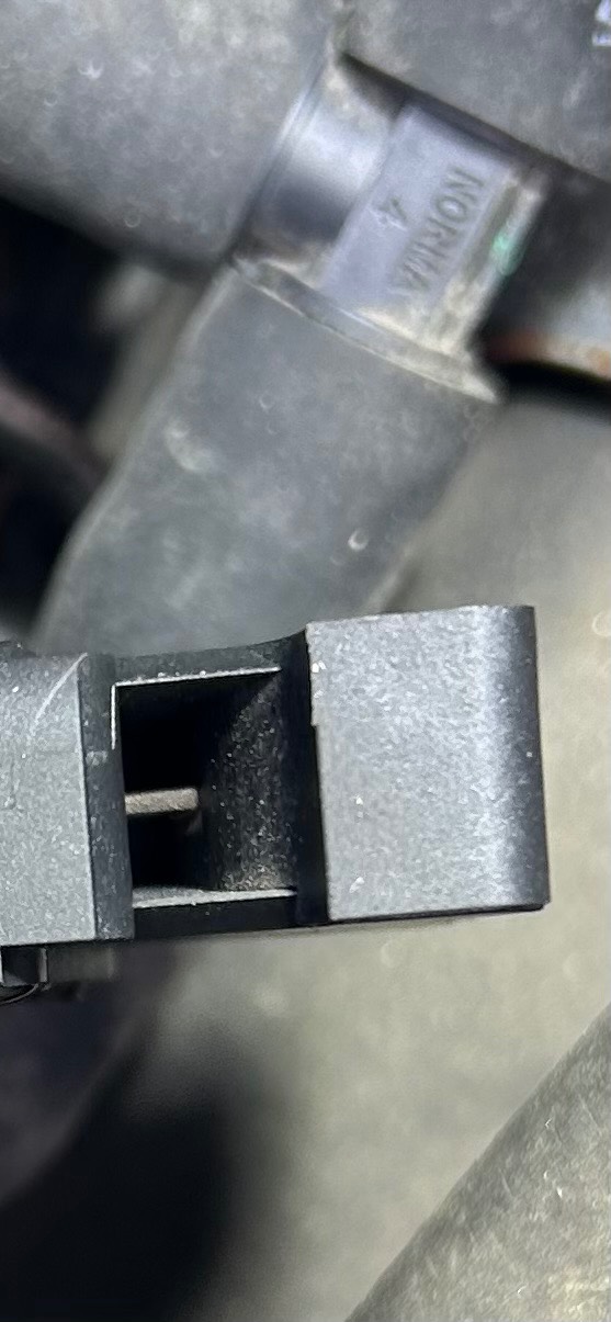

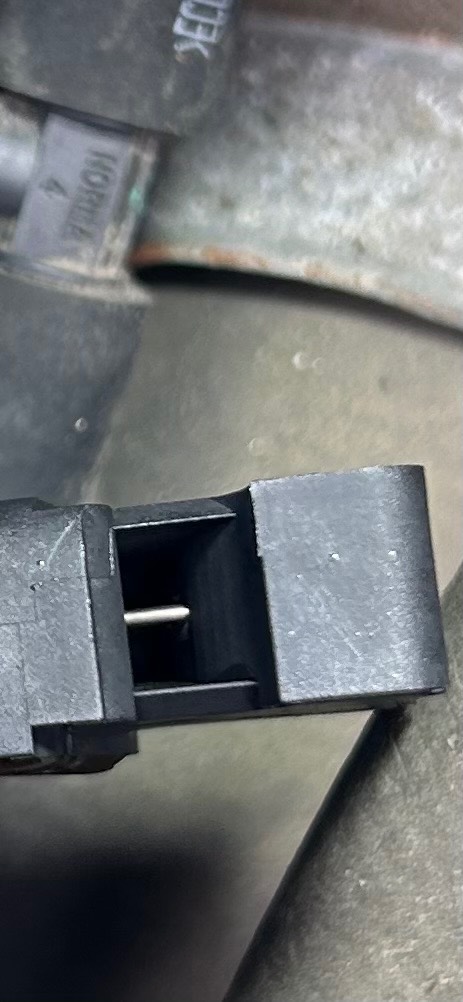

Pulled the MAF and saw that the filament was visibility dirty (pics to come). Cleaned it, reinstalled, took the car out for another drive - better! Still seems imperfect but much better, no chug at idle and engine is smoother.

Sure, yet it makes no sense that it ran poorly without a code, or that it went from throwing VVT codes to having a MAF issue …
Here’s before and after for the MAF filament:
