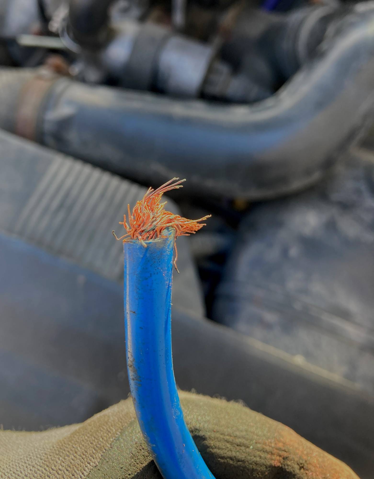

Smoking gun found ...
Looks like a household wire clamp for the main engine ground. With a couple of wiggles back and forth it completely broke off (second pic). It's been replaced with a proper lug but I did notice that the original cable was a bit firm and not as flexible as it should be, there was also some corrosion under the insulation. Resistance still tests fine on the ground wire but I'll put it on the list of future maintenance items. It was a bit difficult to get at as I had to remove the battery tray and the main charge pipe but not a total nightmare. System now puts out a healthy 14.2V to the battery at idle and 13.7-13.9V with the engine hot and under full load (heater, lights, rear defroster, heated seats) with only about 150mV drop from alternator to battery. Thanks everyone for the suggestions.
EDIT: I just read a previous post ... I was the one that put that cable clamp on
don't know what I was thinking but at the time I was chasing a no start issue that was a huge pain in the ass! Lesson learned

How long did it work?? We all learn and in my case, I keep learning as nothing is straightforward on cars. Mind you I am possibly going to have to embark on a voyage of discovery on an 06 V50 T5 AWD. I am already looking for my running shoes to head for the hills! ECU, TCU (replacement engine may be from an auto into a manual car), alternator changes between years and associated CM's that may or may not be compatible and need reprogramming to stop the car frying alternators and batteries. I'm hoping it is a grounding issue!!
Hopefully all is well after you replace the connector and crimp.

I think it lasted for like 5 years so not a total fail. Charging system seems to be much happier now. Good luck with the V50!

Nice detective work ,shegarty!
