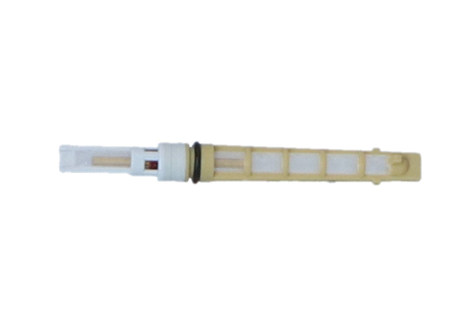

Hmmm....these cars don't have expansion valve.
They have orifice tube instead.
When compressor seize...orifice tube replacement is a must.

I mistranslated the name earlier. We are talking about the same part - I also replaced it (located in the thicker part of the tubing, under the fuel filter).misha wrote: 09 Sep 2024, 14:41 Hmmm....these cars don't have expansion valve.

It's inside a thinner(high pressure line) not inside a thicker (low pressure line).

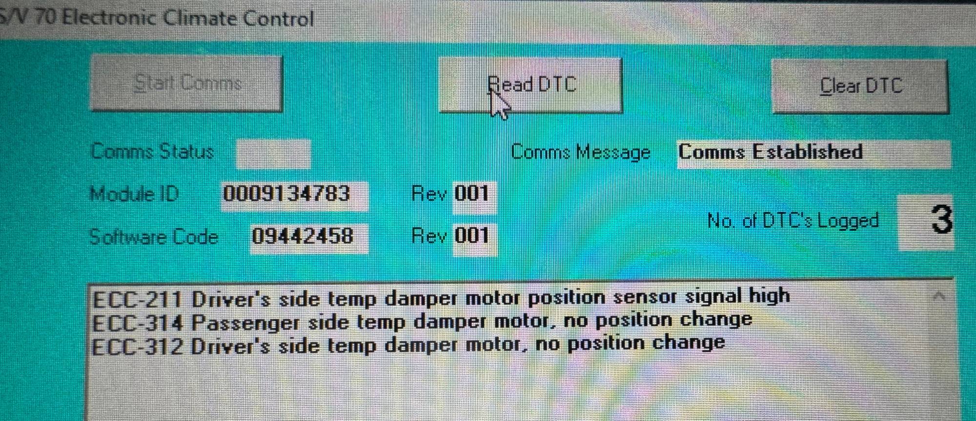

I connected the FCR this morning, and it showed new "fault codes": ECC-211, ECC-314, and ECC-312. However, this may be due to the change in the air conditioning panel.

Clear the codes and see which one comes back.
Could be that there is too much pressure in the system and high pressure switch closed to protect the system.
You need to take it to ac shop to check the pressure.
At least it's not the evaporator!
When you change damper motor or ac console/module ...re-calibration of damper motors must be performed.
It can be done with diagnostic tool or just drive a car for a few minutes without blower fan on in order to let the system to re-calibrate itself.
After driving...when you turn the engine off...don't turn the key all the way to off.
Let it sit in position I for a few minutes letting the system to store the new values.
It's complicated but it is how it is.

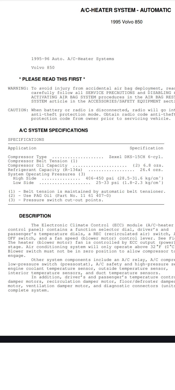

Always...when a major overhaul of ac system is performed it is recommended to let the ac work for about half an hour while engine is idling and closely watch ac pressure gauge.
This will allow to spread the new oil evenly in the system.
Here is the spec for ac system cut in & out pressures: It's for 850....but ac system is the same and compressor type you installed must also be the same like old one.
Even a slightly 10% of overfilling will make problems.
