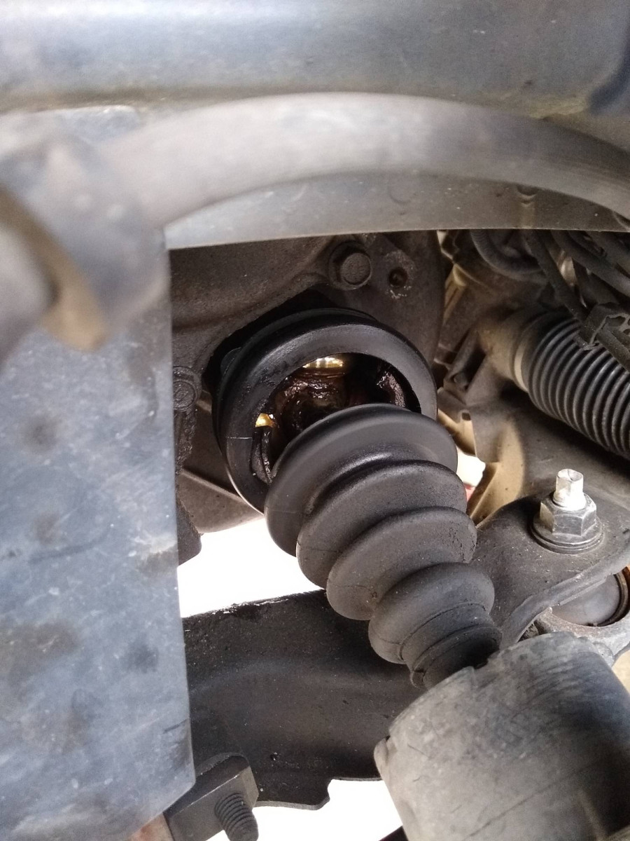

I've used this semi temp / permanent method on 2 CV Boots. The photo was taken Jan 26th 2024 and is on the driver's inner of the 09 S60 2.5T AWD. Cleaned, greased, seal with Saran Wrap one width / groove of boot, before wrapping over with self sticking tape. Not one drop and still holding up. Be sure to follow rotation of wheel when wrapping so it doesn't unravel.
You can used four small slim zip ties to close the boot after greasing to make it easier to Saran Wrap and tape. May also be able to insert the small groove of boot into a larger one and wrap.
The other car was the 08 C30 T5 M66 which was spitting grease but not broken. Injected greased with a needle at 4 points around the boot into the bearing and massaged boot to further push grease in. Cleaned the boot with degreaser and wrapped with self sticking tape, no Saran Wrap needed.
I've used the needle on broken boots of ball joints and tie rod ends. Can also wrap with self sticking tape. The steering feel is smooth again besides reduced road noise.
Use grease gun of choice, Lucas Red Tacky (preferred), Needle and Wrap. Do not use the high temp wrap as it's thicker, stiffer and does not conform as well. I have both the cloth / fleece and high temp wraps in various widths.
Excellent, better than CV joint grease.
