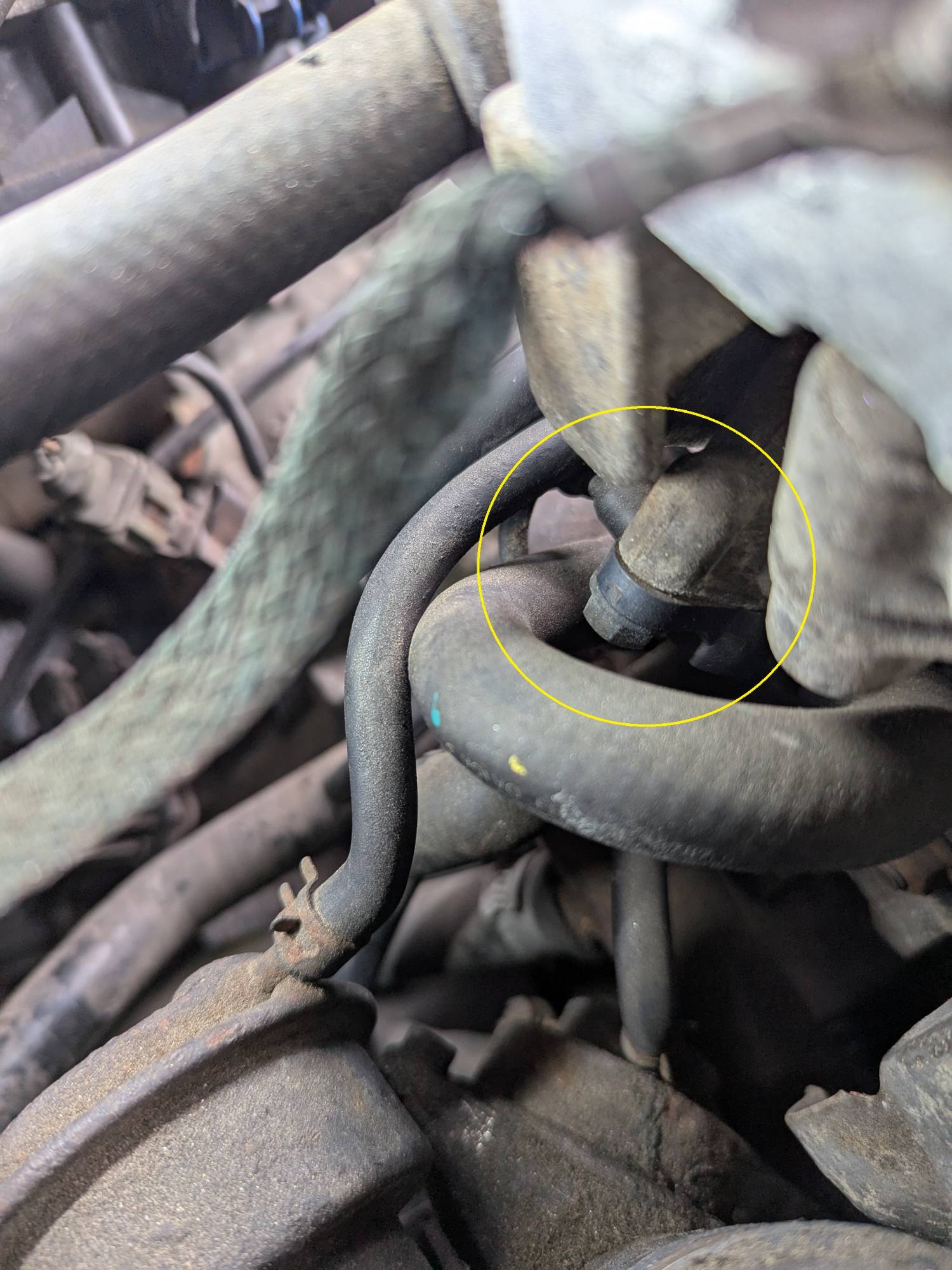

Some more diagnostic work.
There are some different opinions on what Camshaft position sensor my car should use.
Is it the puck or what I think is in this shot right on the upper engine mount. Also-
I am about ready to try and clean the throttle plate.
1. Do I need to remove the fan for access?
2. Should I remove the ETM entirely, or can I get a decent enough cleaning to work with some spray and a brush moving the plate by hand.
Thanks everyone, I hope I'm not spamming here and hopefully your Memorial Day weekend is going great.

It’s really hard to get access to the throttle body on a turbo 99-00, it sits under the manifold with poor access. You will definitely want the fan out. After you have sworn up a storm removing the four rusty bolts for the fan with vice grips , replace with cheap silver cheese screws ftom Lowes

Thanks for that.
It does seem like that will need to be removed. Thanks for the guide with parts list!
I assume you are also advocating for etm removal to clean the the throttle?
I think that will need to be a project for next weekend while I track down a new gasket.
Yeah the fan was o-k not fun to remove when I did the front engine mount a couple of years ago.
Good suggestion to get some new hardware.
It was mostly just fiddly for the tight space when I did it-being careful of wiring and plastics etc.
Any thoughts on the timing marks and if I successfully located the Camshaft Position Sensor>?
Maybe those are two items I can at least cross off the to-do list this weekend.
Thanks again!
