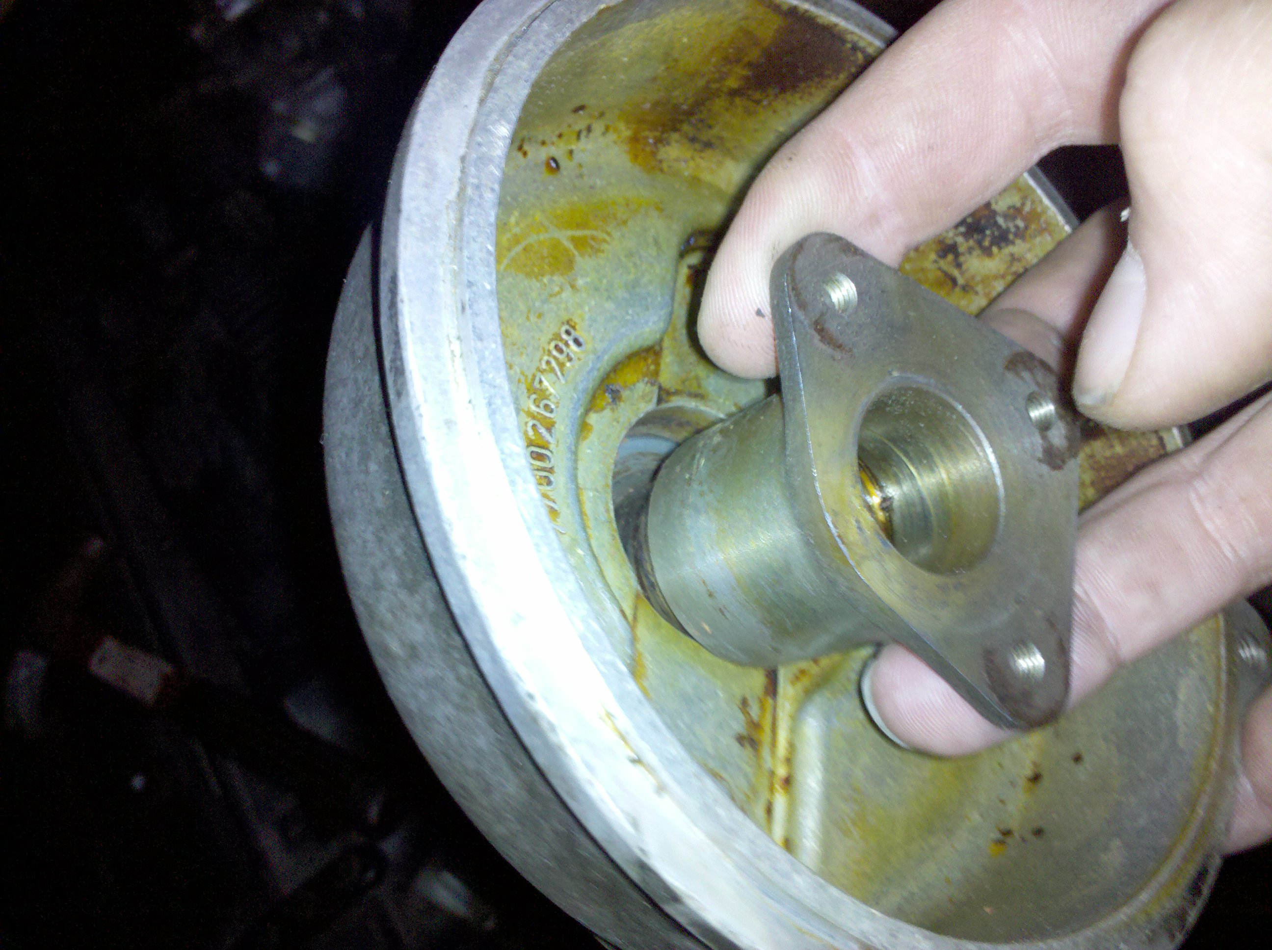

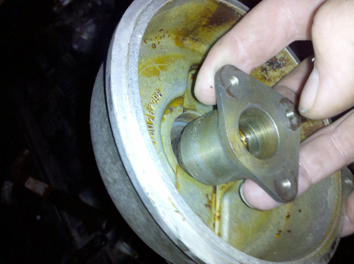

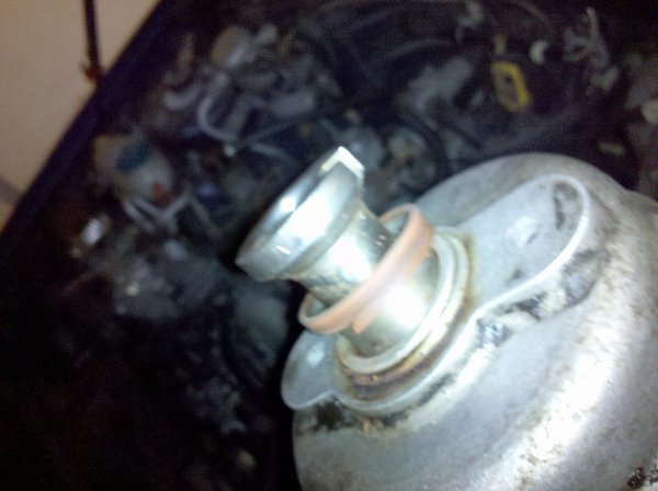

Okay, I've done the repair, this is how I did it, feel free to critique/tweak these to your liking
Thanks Jesse for the pictures, I've reused them in case others need the writeup
Note: I didn't but it would probably make things easier to remove the upper radiator hose and fan shroud, but it's not necessary
1) Mark and remove spark plug wires from distributor cap
2) Remove the 3 bolts (13mm I think) holding on the distributor cap and remove the cap
At this point there's a circular insert that can't be removed until the rotor is removed
3) Remove the three screws securing the rotor, and remove rotor (Picture 3 shows rotor removed)
4) There is an allen bolt securing the piece that the rotor screws into, the rotor boss. It was a pain to get loose but it came loose, this is either a 6 or 8mm allen bit (Picture 3 shows allen bolt that requires removal)
5) You can maneuver the rotor boss around and remove the two bolts securing the distributor housing to the block... do this and pull out the housing. The whole assembly will come out with it. (Picture 2)
6) These two pieces will pull apart, allowing access to the seal (Volvo Part# 1218239). I had to put a socket into the hole and rap it a few times with a hammer, and then it pulled apart, otherwise it seemed impossible. (Pic 1 and 2 show entire assembly still intact)
7) Slide off the seal and apply some oil to the new seal, and slip it on in the same manner.
8. Put the housing between the two pieces and connect them again (they're keyed and only go in one way) (again, 1 and 2 show proper orientation)
9) Installation is reverse of removal.. There's a divot on the end of the shaft which will align with a key on the inside of the engine
Took me a few days but it seems to be running good so far
Darrell
