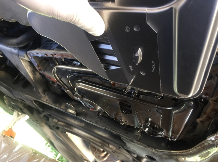

I did my 2004 XC90 at 105,361 miles. I changed the transmission filter and it took about 7 qts of fluid! I had bought 4 qts in a kit from FCP Euro, but the had to go grab another 3 to get it to the fill line. So far the tranny is doing fine.
Here's a few pictures of the job. It's not a hard job, just a bit messy.
