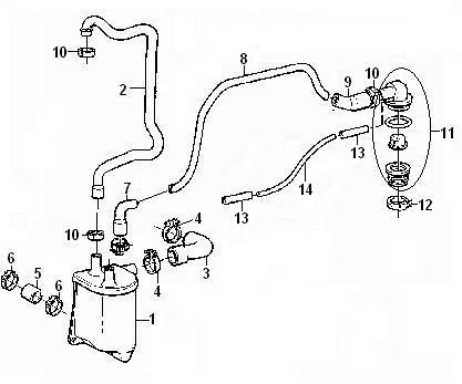

For some reason I can't edit. Here's the FCP diagram, it looks more like my car:
Early 850 PCV.jpg (21.03 KiB) Viewed 246 times
It's piece number 11 on that kit that had the white gunk in it. And it seems like there is an oily film from that point to the throttle body.

I just took apart the upper intake system to see if there were any other issues and noticed white gunk on part number 9 (I actually don't understand that diagram too much, as mine looks more like the tube above it but there is no number on it). Not sure what that means - probably it's clogged - but d'uh, I know it is :). I've cleaned out all the block holes, even poured seafoam down the tube #4.
