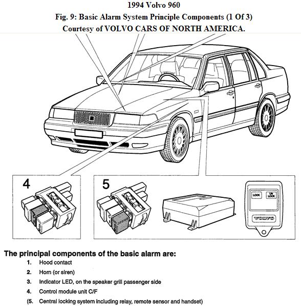

What if it is a relay issue?

Post by Medusalith »
If your car operates the central locking flawlessly with just the key then it's the alarm relay almost sure. My 440 had a similar issue, the hazzard lights worked well, except when operating the fob; the lights didnt flash anymore all of a sudden. I went to the service and they didn't even had to check it they just said it's the alarm relay that is faulty and needs to be changed.
Check this post:
http://www.volvoforums.org.uk/showthread.php?t=65269
It's about a 940 but it can give you some hits about what to do.

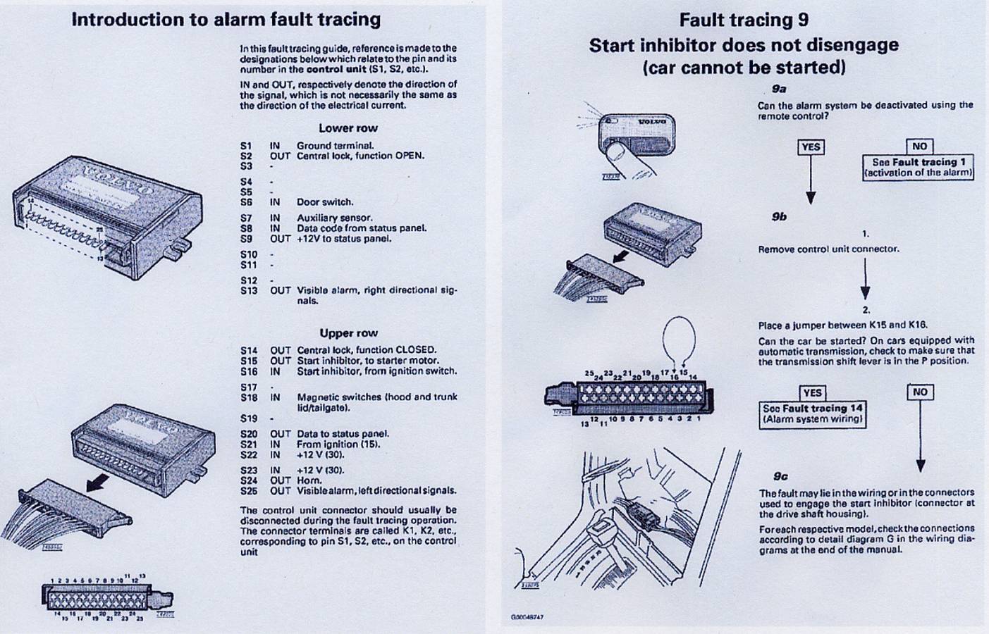

I got this some time ago from google but I can't remember the site, sorry.
I think before you go and buy any part you should see if this diagnostic is appliable to your alarm. I believe this is done accessing the alarm ECU.
