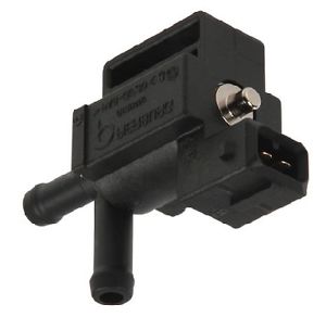

Can this fix be adapted for the square purge valves from a v40/s40? Has anyone had any luck fixing these ones? If so-any information or instructions would be greatly appreciated.
- $_35.JPG (7.96 KiB) Viewed 5008 times
