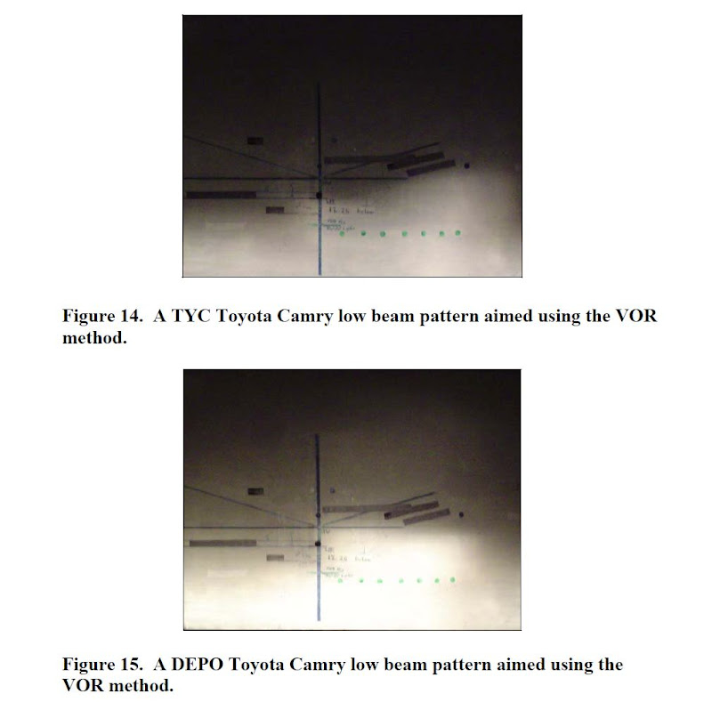

Here is a revealing report testing various aftermarket headlamps against their OEM equivalents.www.capacertified.org/press/CAPALighting3.pdf
The short answer is that the aftermarket lighting failed all tests.
This image from page 26 of the report is particularly revealing. The top is an OEM lamp, the lower are the outputs from the TYC and Depo reproductions. It is clear how someone coming from a stock lamp, particularly one pitted or hazed from age, could feel like the lower lamps are a massive improvement. The reality is that the focus is all wrong, and light is concentrated in ways that could make the driver 'feel' safer, but be actually harming their vision in the important spots.
