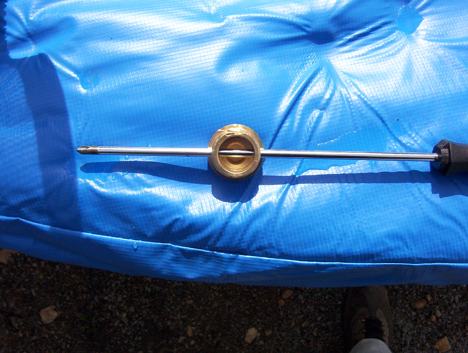

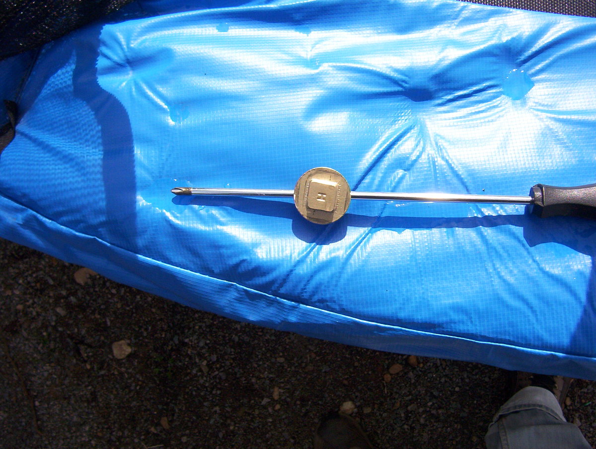

cn90 wrote:For the serpentine belt tensioner, no need to buy the IPD tool or using coins etc. Here is the $1.00 solution.
The attachment VolvoTensionerTool.jpg is no longer available
1. If you got a welder and the plug can be welded then just weld a lever on the plug
2. I used a Dremel to make flat sides on the plug. This wasn't going very well. Maybe I'm too clumsy. :wink:
So I ended up drilling a hole through the sides and used a screwdriver. Use at least a 8 mm screwdriver if you don't want to bend it.
