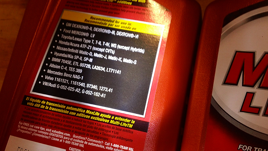

Local Wal-Mart has a gallon for $15. The label reads as follows. It lists Volvo, see 2nd bullet from the bottom. Can I do this fearlessly?
Valvoline Max Life ATF

Post by erikv11 »
I think my advice has not been so good in this thread, answering too short to make myself clear so I'll try again.
You can use 3309 if you want. Some people even prefer it over standard Dex III. 3309 isn't going to cause any problems, and if your car has hard shifting it is reported to help with that and actually recommended by Volvo in that situation (e.g. http://volvospeed.com/vs_forum/topic/11 ... obil-1-atf).
However if you are going to flush your trans fluid anyway now, that's where I would dump the 3309 and go with standard Dex III. Mostly because it is cheaper and works very well. The MaxLife you showed will work, but I would actually go with the SuperTech brand at WalMart, which is like $12 a gallon.
But if you don't want to flush out the trans now, then continuing to use 3309 is fine.

Post by precopster »
Interesting thread Erik. Thanks for posting that up about Mobil 3309 helping some AW50-42 problems.
Valvoline MaxLife has me a little stumped. It's a fully synthetic fluid meeting Toyota T-IV standard yet it makes no mention of the JWS-3309 spec. In literature provided by Valvoline this is also confirmed:
http://www.valvoline.com/pdf/maxlife_atf.pdf
I think I'll keep on sticking with the Nulon Synthetic Multi Vehicle fluid. It's synthetic and meets ALL specs
