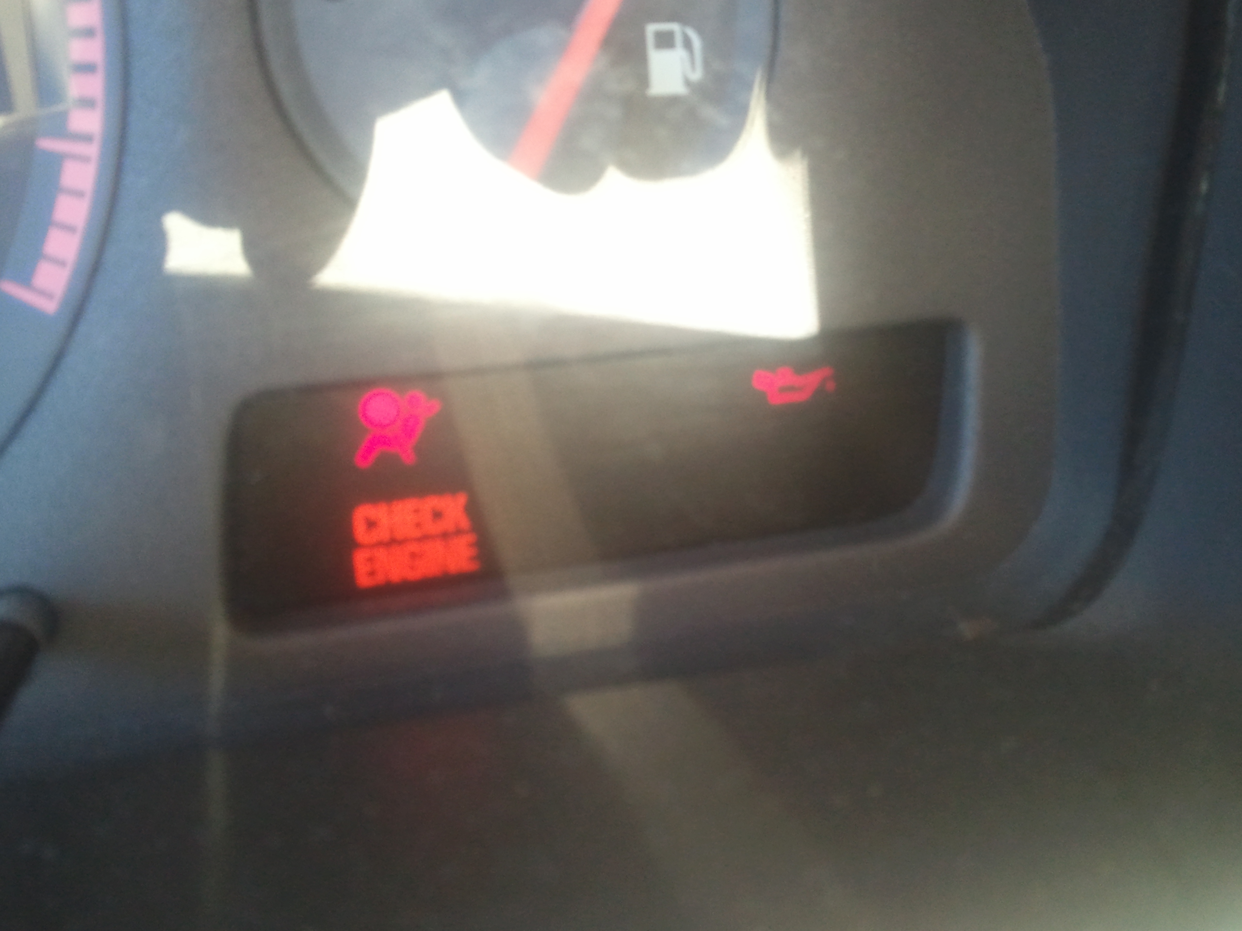

I had an emissions notification before, but either way...why wouldn't my car start by now? I keep thinking maybe it has to do with the MAF or something, but wouldn't that have to do with the car not getting fuel? I have fuel and pressure, but the spark from the ignition coil seems to be whats wrong. I don't wanna just buy a cam sensor without knowing for sure..and I filled her up like a day before she broke :[

No matter if I search individual or let it do an overall it always tells me no codes found, and yes, I have done the read button a few timesJDS60R wrote:Does the message screen show anything when you press "READ" and scroll through the messages ???
