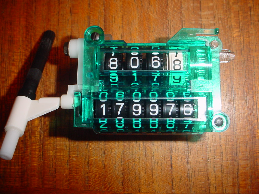

My 850 had 171,271 miles on the broken clock but a dump of the brain (See MadeInJapan's fantastic link for the instructions) indicated that I really had 179,976 miles on it. Now, how do I add 8,705 miles to the odometer?

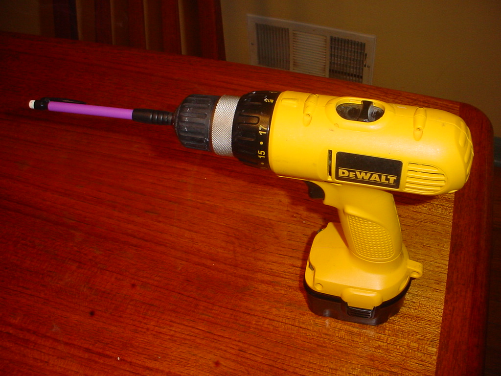

I chucked up a pencil with a good eraser into a battery drill so as to speed up the mileage change.
The odometer corrector tool!

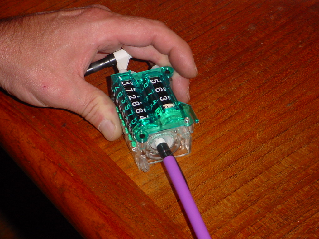

I then put my old large gear into the odometer assembly and used the pencil eraser as a friction drive to advance the large gear. In order to advance the odometer you need to set the drill to run counterclockwise. I ran it at a speed that clicked off roughly 10 miles per second and, with rest stops, I ran off the desired miles in under 30 minutes. Don't overshoot because the opposite direction will not turn the odometer backwards. I did the last 5 miles or so by hand.
The light speed odometer advancer in action.

The correct mileage on my odometer.
