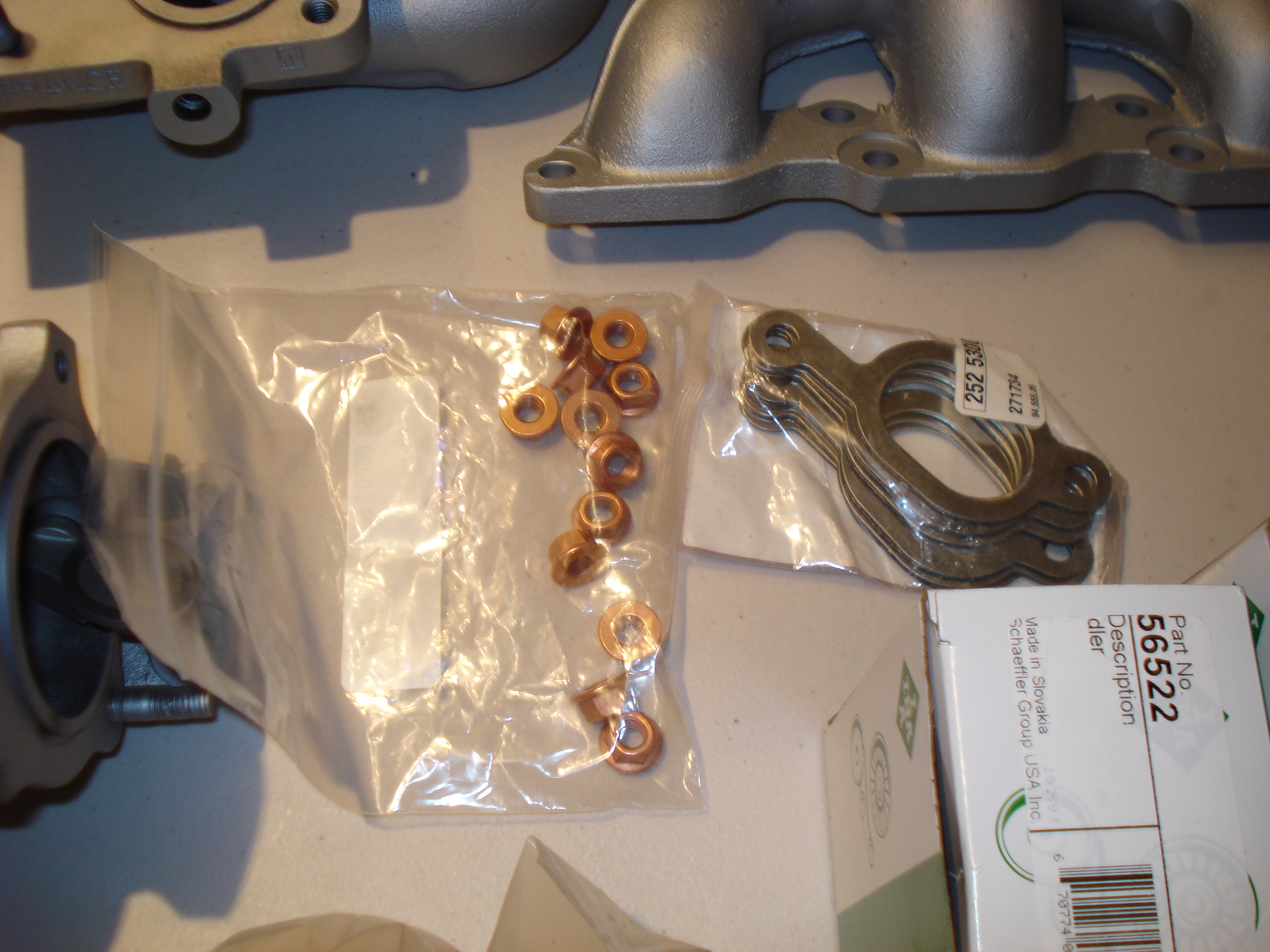

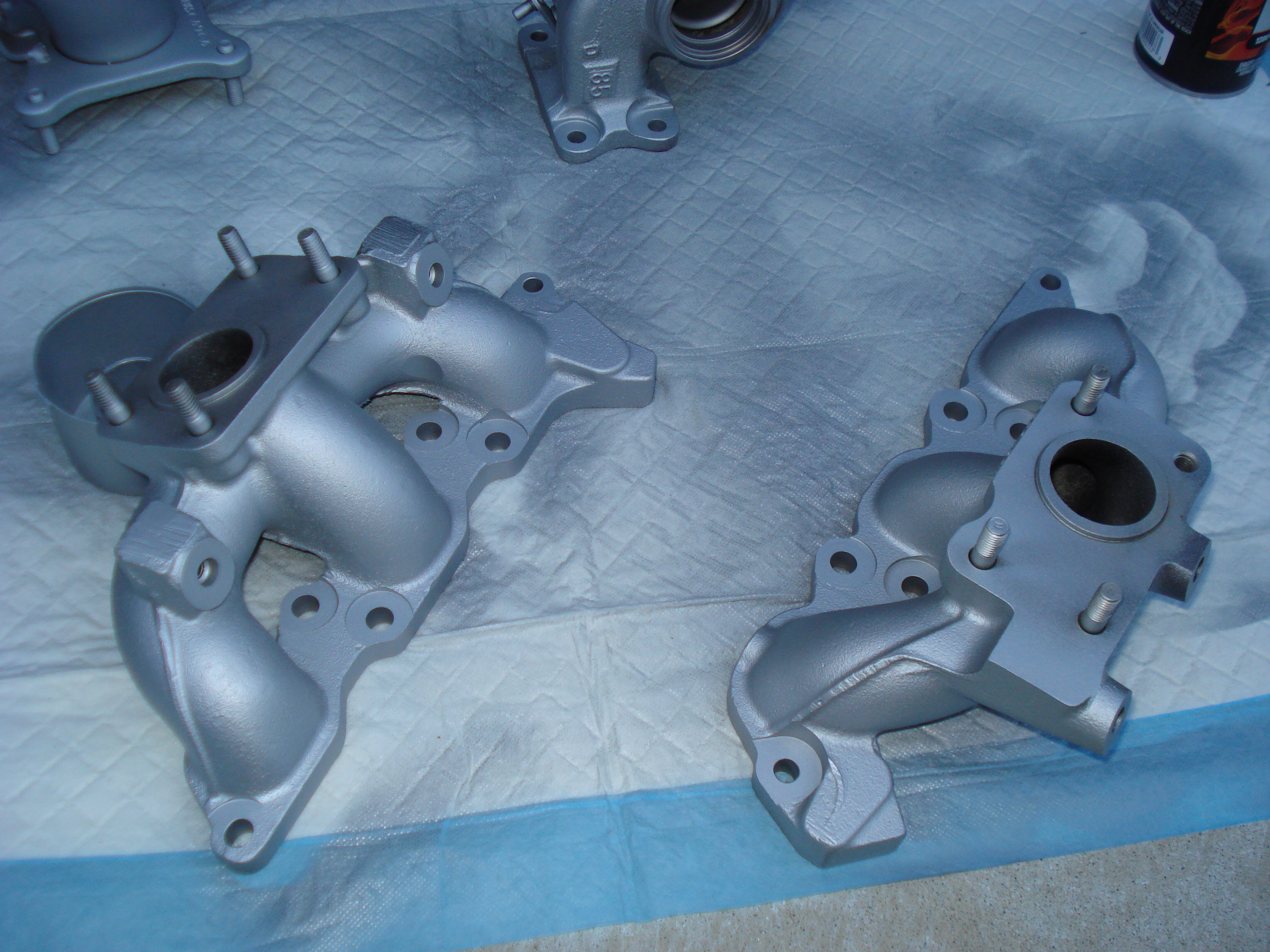

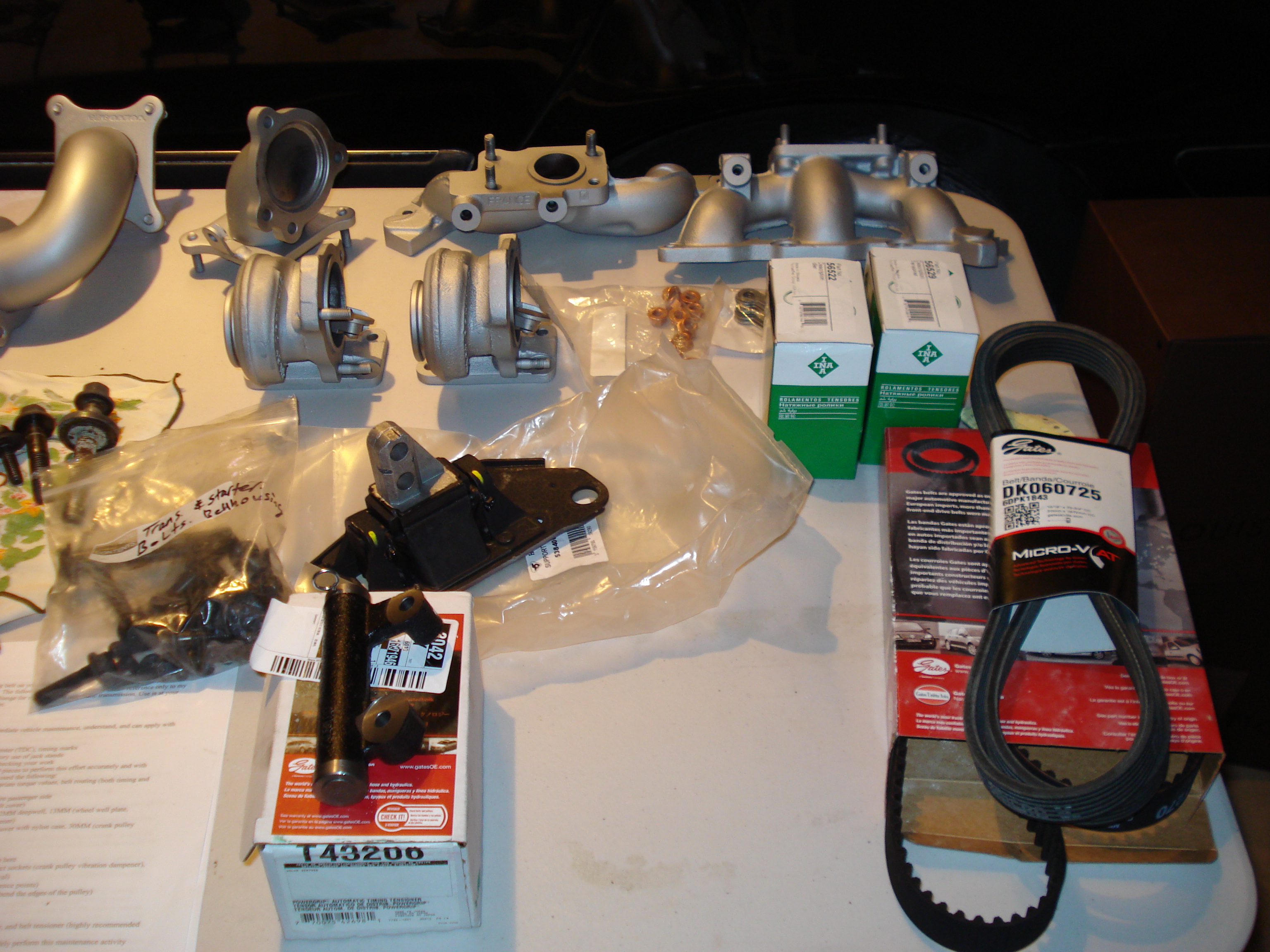

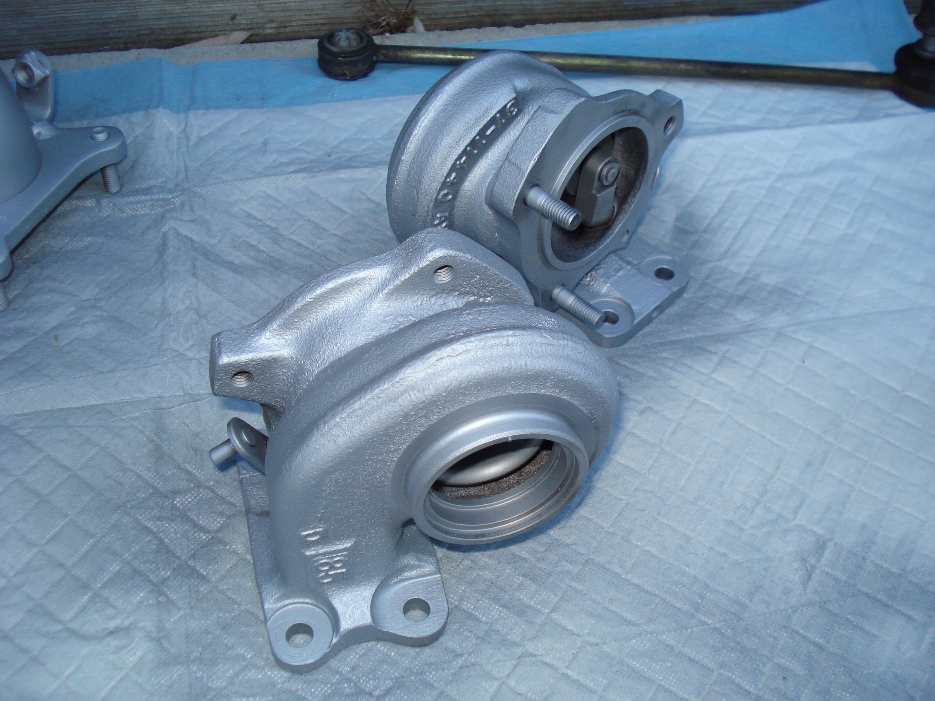

with the turbo's and ex. mani. off, going to sand blast them this week, both turbo's are dismantled, going to buy some replacement bearings ans seals, subframe bushings are here, sway bar links, all new exhaust gaskets , ordered some new exhaust mani nuts and a new dip stick, ya mine broke, oh and 2 new seals for the oil cooler. stay tuned..

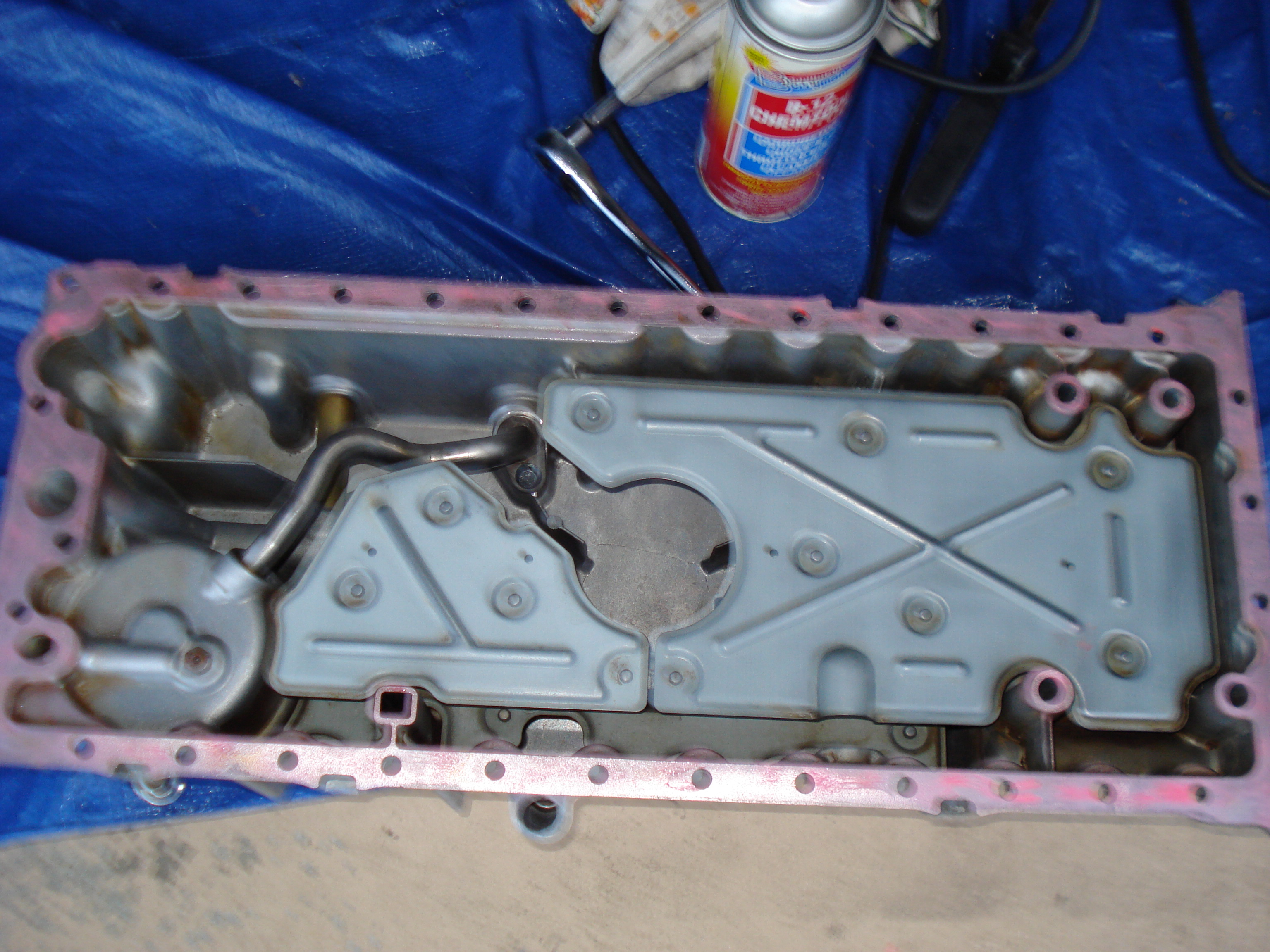

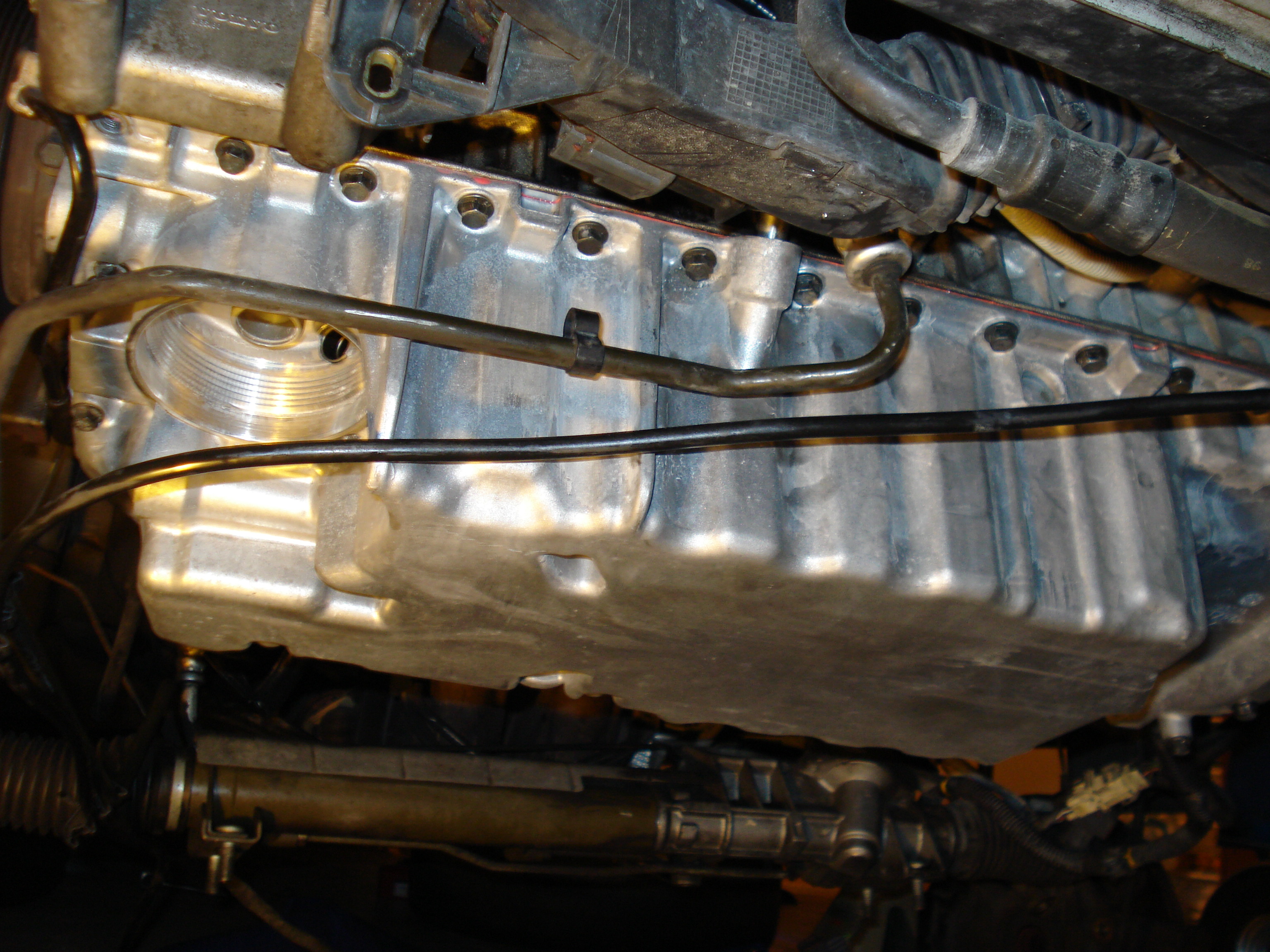

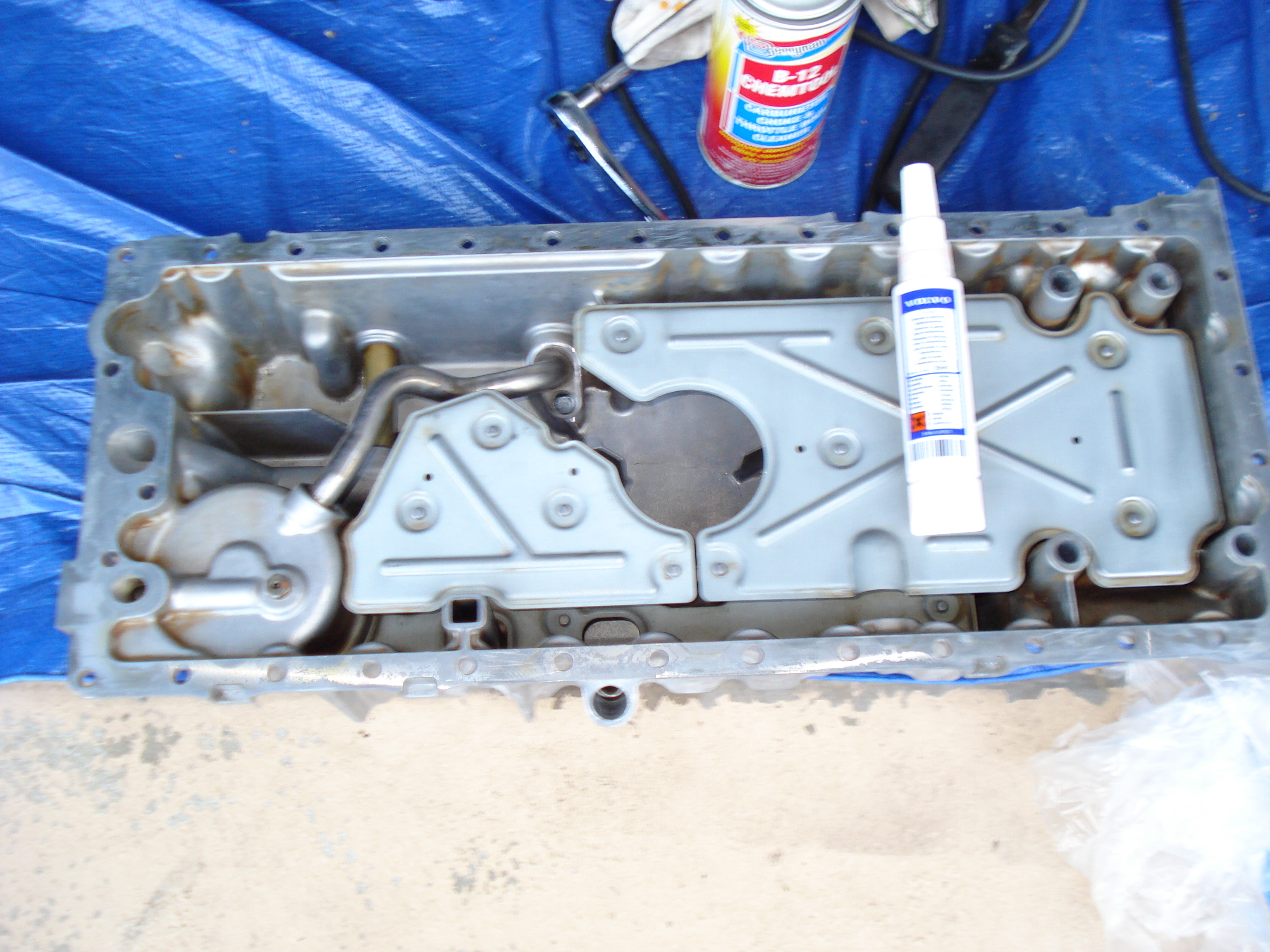

so i installed the freshest oil pan using the Volvo liquid gasket/sealer. Im attaching some pix of the oil pan and the before and after the gasket which was rolled on with a paint roller. torqued it all down , BUT i cant believe the very last bold by the oil pump kept spiining, only to find out it got stripped, i dont know why, i was very careful, so now after all this careful and long day i have to tap new threads into the pan and possibly use 1 size larger bolt.
New serpentine belt
New timing belt
New Timing belt roller
New Timing belt tension pulley
New Lower left motor mount
New oil cooler O-rings
Oil pan is installed, new oil plug and copper washer , Need Oil filter , the adventure continues....ill post a video/pix soon...
