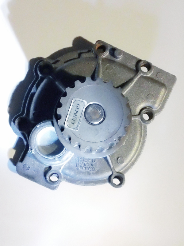

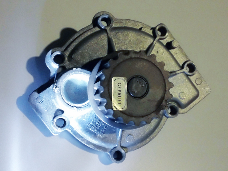

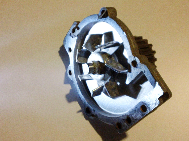

cn90 wrote:I am just curious when you removed the 2-yr-old HEPU WP, what was the cause of the leak, is it leaking through the freeze plug area?
There wasn't any visible sign of sorts that would point to the leaking. No movement at shaft, or wear.
The dripping would increase when poked the freeze plug area with my finger.
I couldn't sort if it was dripping when the water pump was running.
I still have it, do you want me to look at something closely, I would?
What is freeze plug's purpose?
The freeze plug purpose is similar to engine freeze plug, if the antifreeze does not have the correct ratio, and if you are in in very COLD climate such as North Dakota in January (-40F with winds etc.), the freeze plugs pop out to prevent damage to the engine block.
My guess is: The freeze plug in your HEPU WP pump was not installed properly at factory (the freeze plugs are usually press-fit, i.e., pressed in with force with some Loctite compound at factory).
Cold you post some pics of the HEPU WP?

xHeart,
Thanks for the pictures.
Did you figure out where the leak came from? Gasket vs Weep Hole?
Did you do the experiment to see if the leak comes from the inner seal?

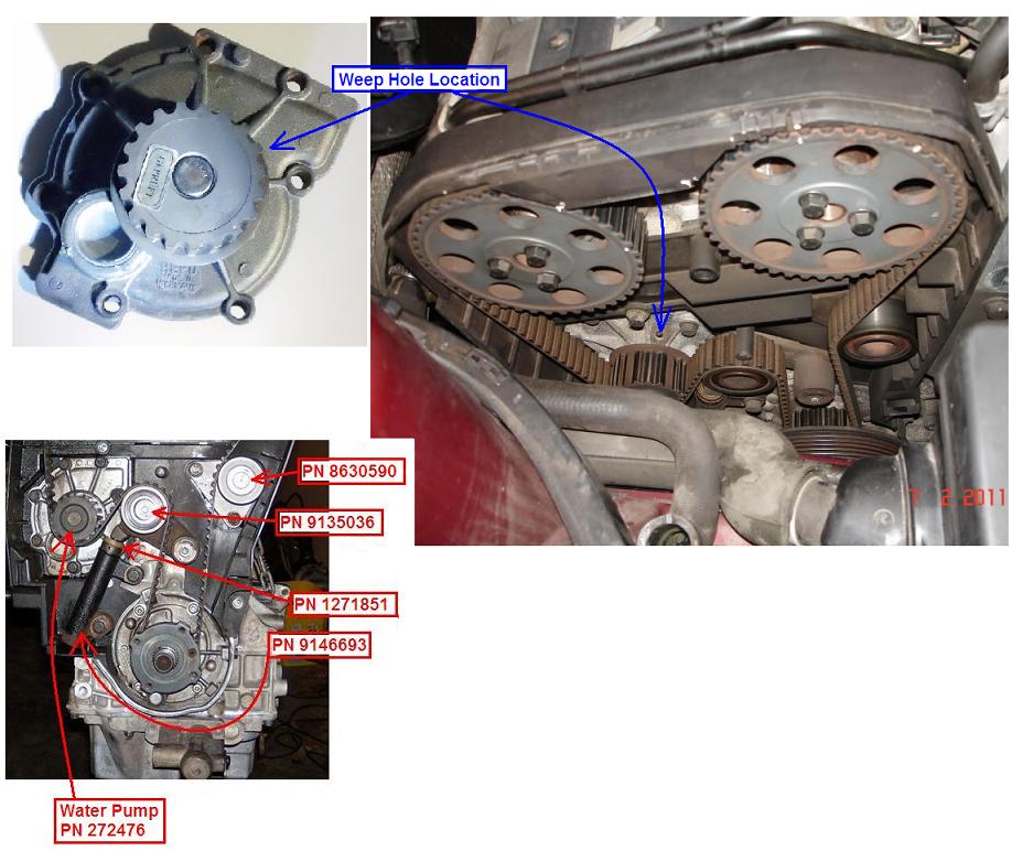

For some reasons, Volvo engineers designed the WP's weep hole to be at 1 o'clock position (instead of the usual 6 o'clock position in many cars). With the weep hole at 1 o'clock position, coolant will have to fill the bearing chamber, then spill out the weep hole.
I took some random photos from the internet to show you the location of weep hole:
Yes, I noticed the hole. I will experiment and look for the cause this weekend using old and leftover green anti-freeze.
