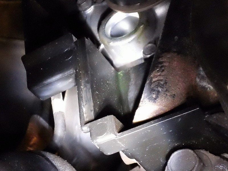

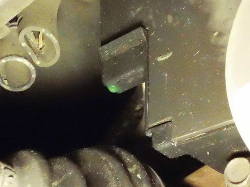

Few photos...
view from below, a drop at a time
corner with antifreeze
Yes. it is HEPU.
HEPU!
HEPU!

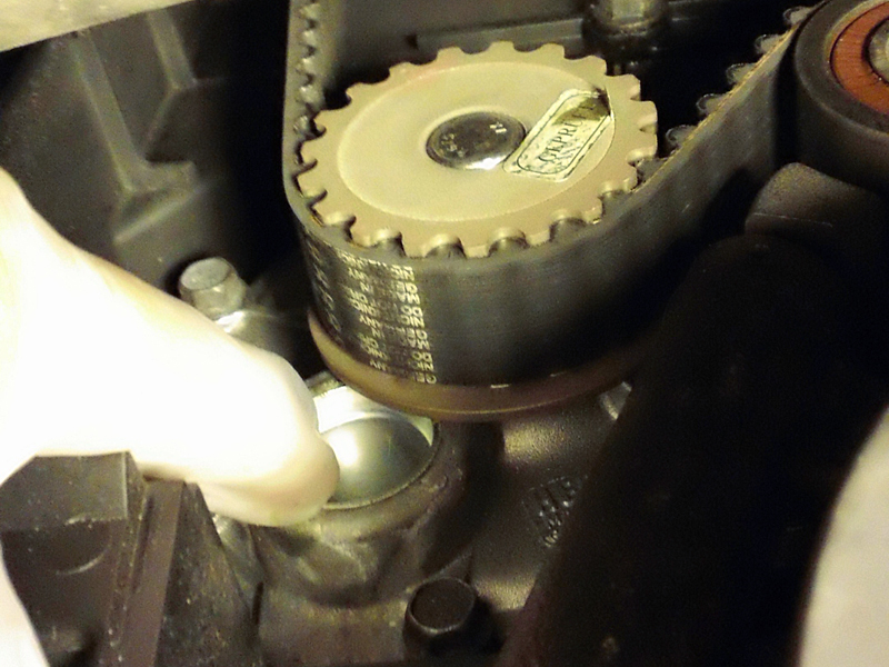

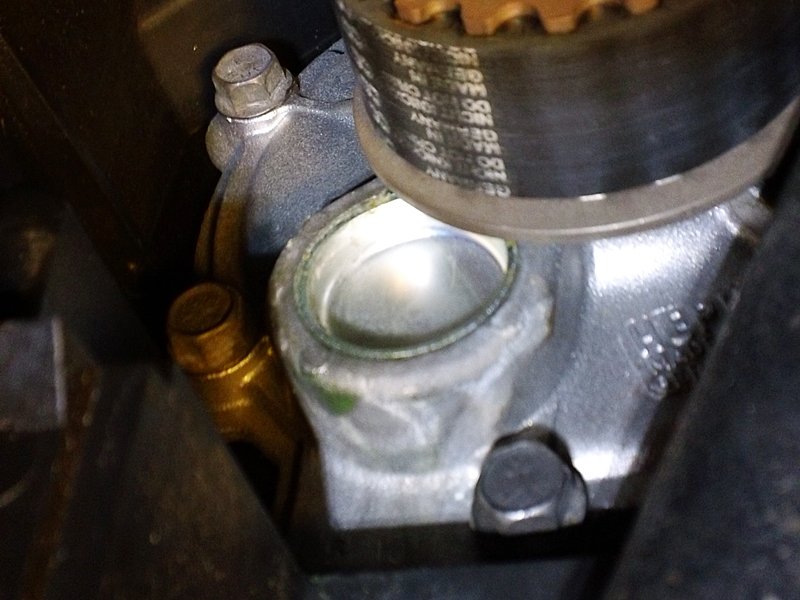

The bolts appear dry. However, pressing against the cup with finger draws out antifreeze from its edges. It is hot.
location of leak
location of leak
A clearer view of drop forming. Would the seal become so weak that the hot antifreeze would start to gushing out at some point?
here is a drip forming after it is pressed
Where do I go from here? The Aisin kit at IPD if $78.
misha

With that minor drops and with last replacement 2 years ago...i would let it there for next timing belt replacement and i would keep en eye to coolant level.In fact...you don't need to keep en eye to coolant level because you have low coolant light. :wink:
Seriously...if the pump is not making noise and don't have a play in the shaft,with that minor leak...i would leave it in there for next timing belt replacement IF leaking is not getting worse.
