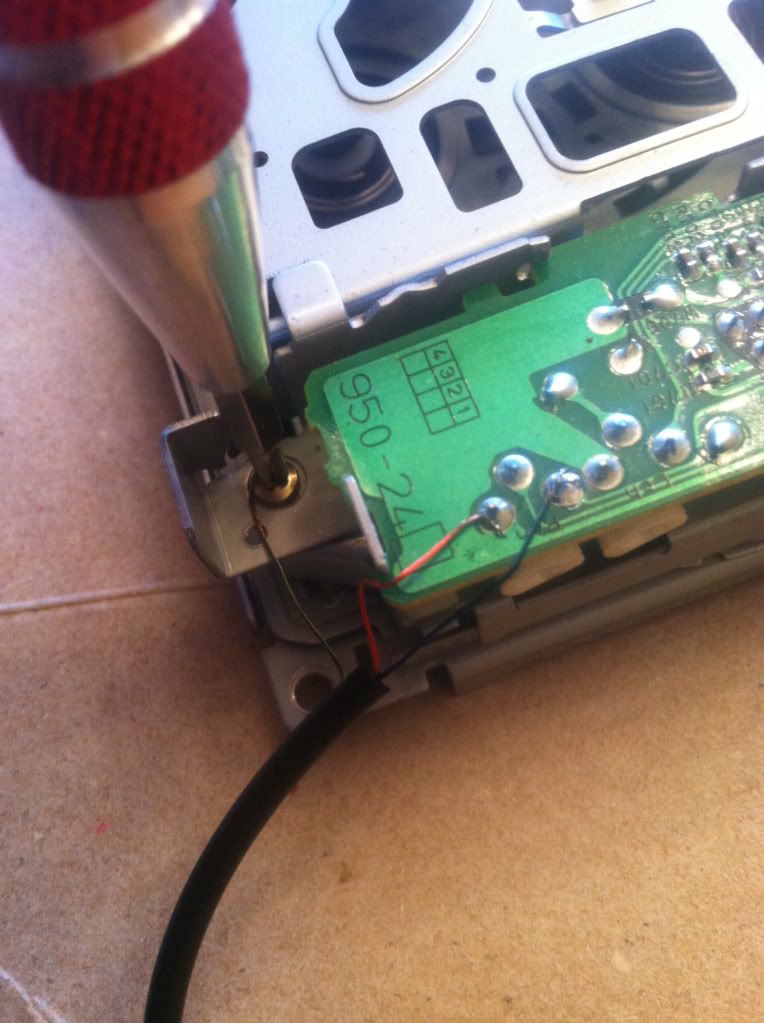

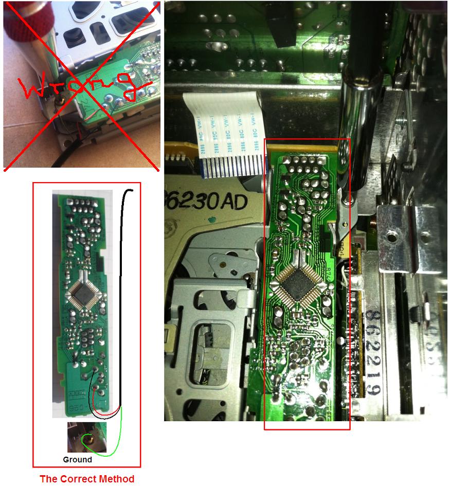

I just did this mod for iPod, a few comments:
1. As already mentioned, the very first post photos were WRONG, if you do it that way, all you get is sound from the (R) speaker, and nothing from the (L) speaker. I was in hurry and didn't read all the posts. So live and learn.
2. The CORRECT way is the photo by bags519 above. Note: I soldered the Red and Black wires as shown, but the Ground wire: I didn't solder it, instead I used the screw as in the first photo.
3. Use fine-tip solder.
4. If you are good at soldering, all you have to do:
- Only remove the TOP cover (2 screws), then remove CD player (d/c ribbon connector)
- Leave the cross bar and the cassette player alone!
- Then feed the mini-jack cable through a hole in the back of the stereo, then solder them as in the photo by bags519 above.
- If the cassette (gutted of tape) is ejected, then reverse direction as people said above.
This way you save the time removing the cross bar and the cassette player.
Hope this helps others...

CN90, (and EstVolvo and Bags519 if you're still reading), is this photo http://i1123.photobucket.com/albums/l54 ... 93ed6a.jpg the incorrect one that gives only one channel? If so I'll edit the head post and insert Bags'.
- Posts: 8358
- Joined: 31 Mar 2010, 09:54
- Location: Omaha NE
- Been thanked: 504 times
Yes Matthew,
That photo was incorrect.
I have put together a composite photo showing both the incorrect and correct method.
Again, no need to remove the cross bar or cassette player. Once the CD player is out, you can solder it using a fine-tip soldering gun...

Just to verify if the ground wire (green) fastened at the philips screw on the frame?
