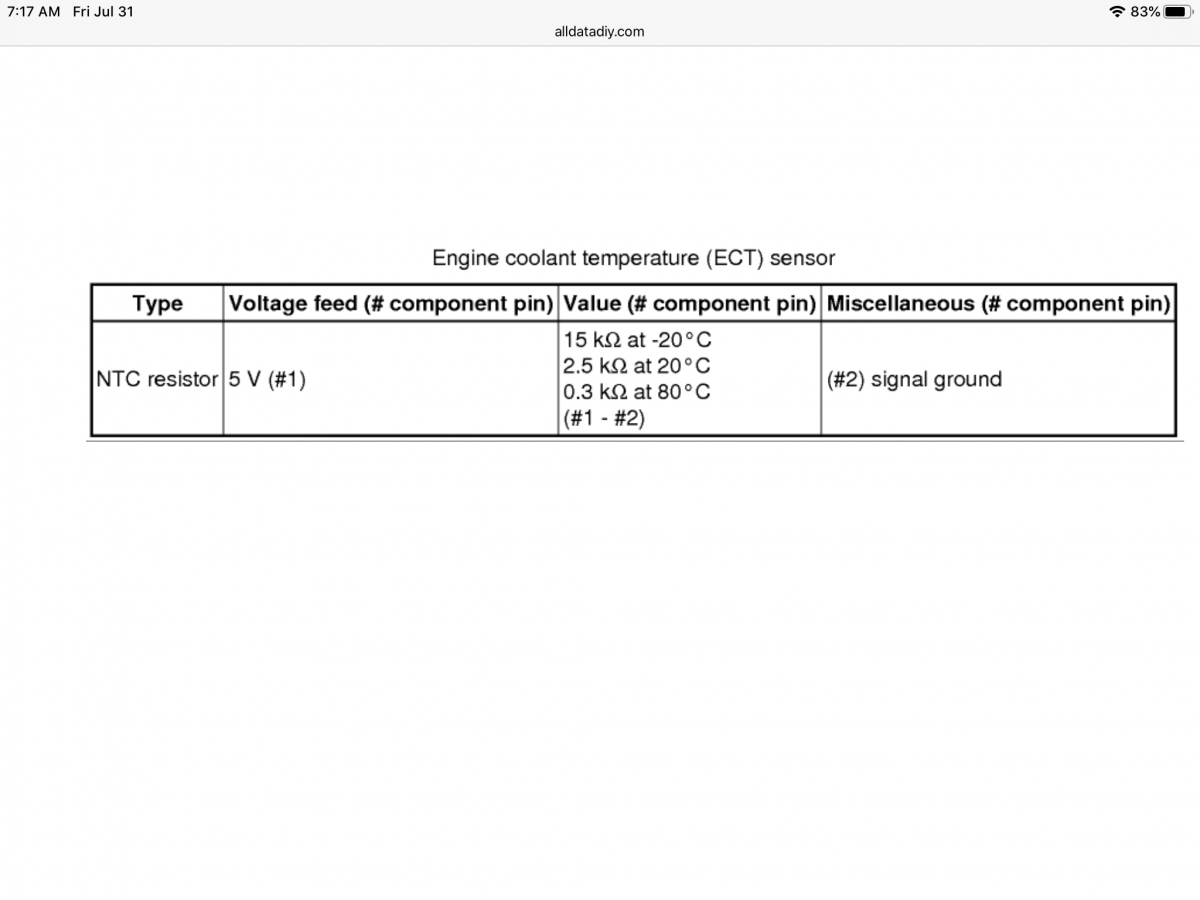

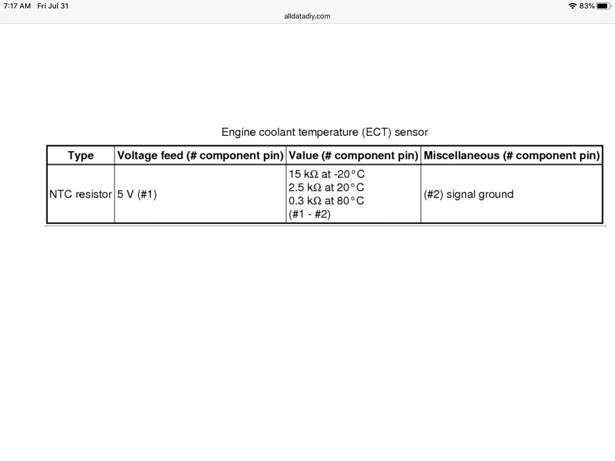

Temp sensor specs

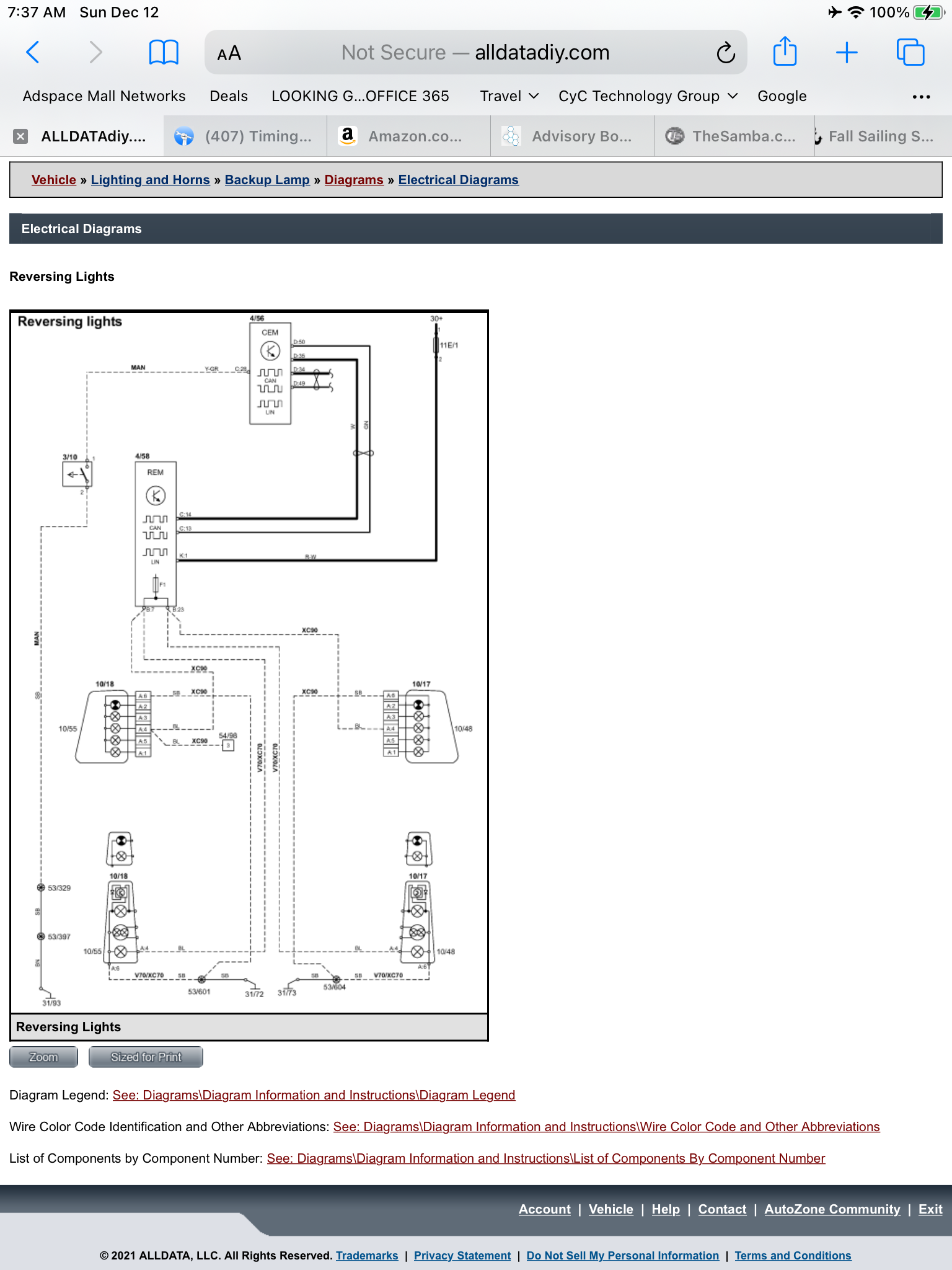

Had to replace rear rotors for rust and also clean fuse 1 in REM to fix inop reversing lights

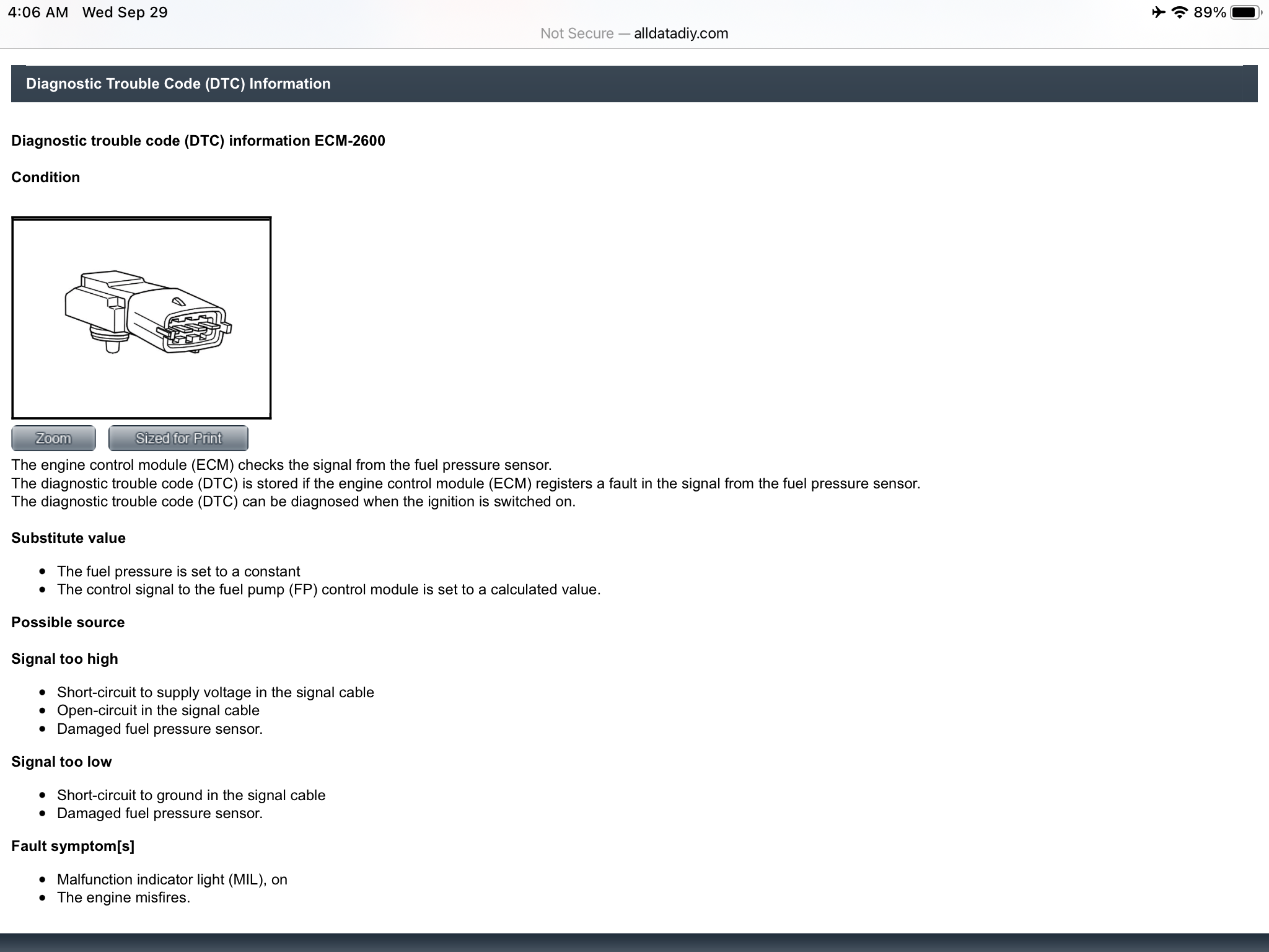

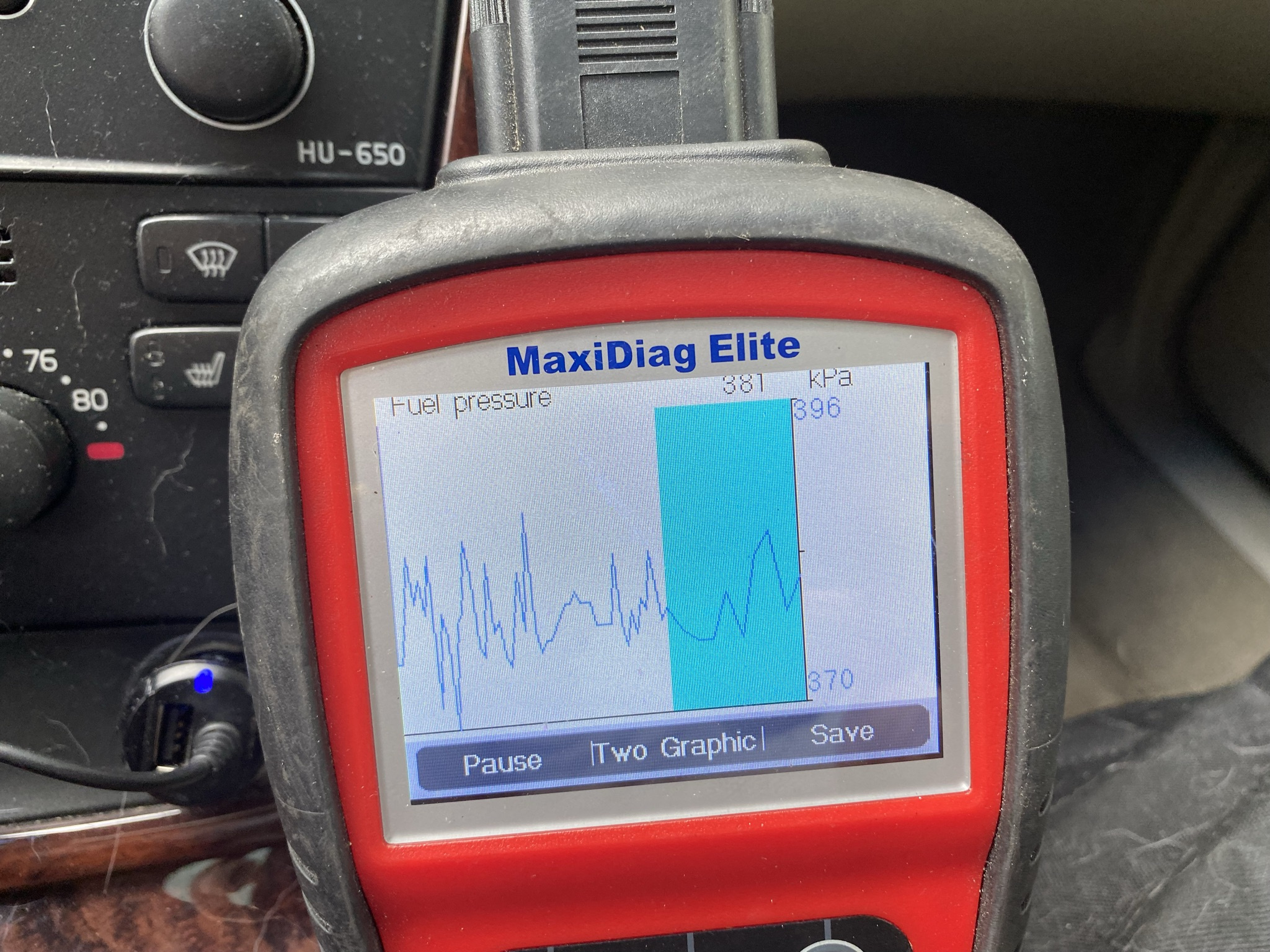

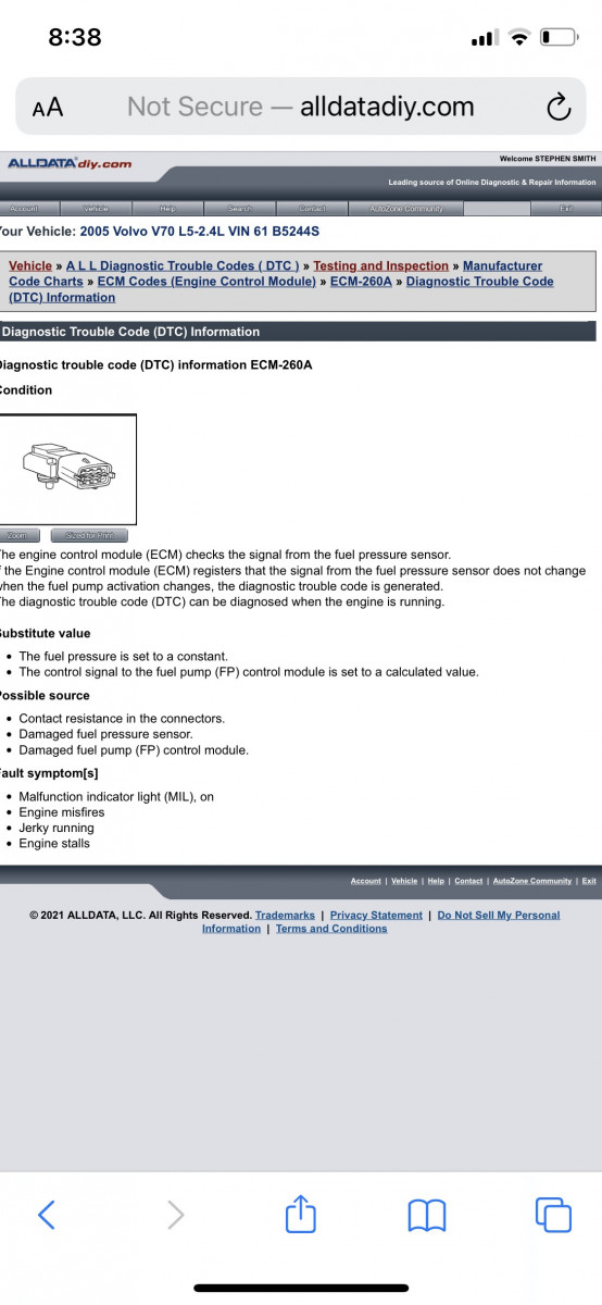

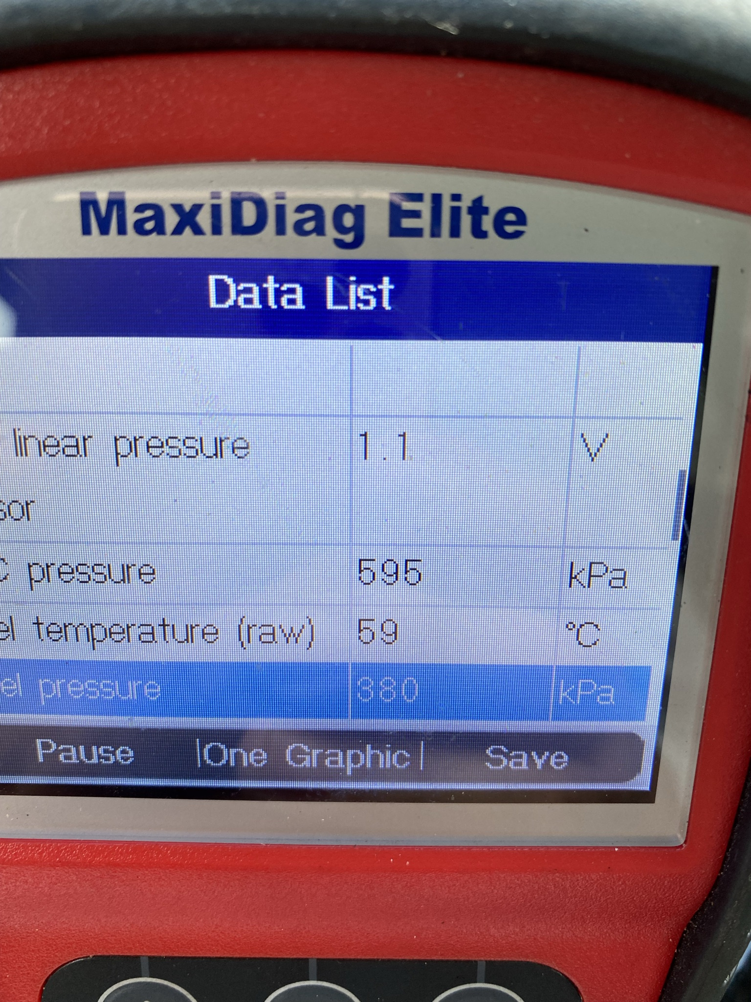

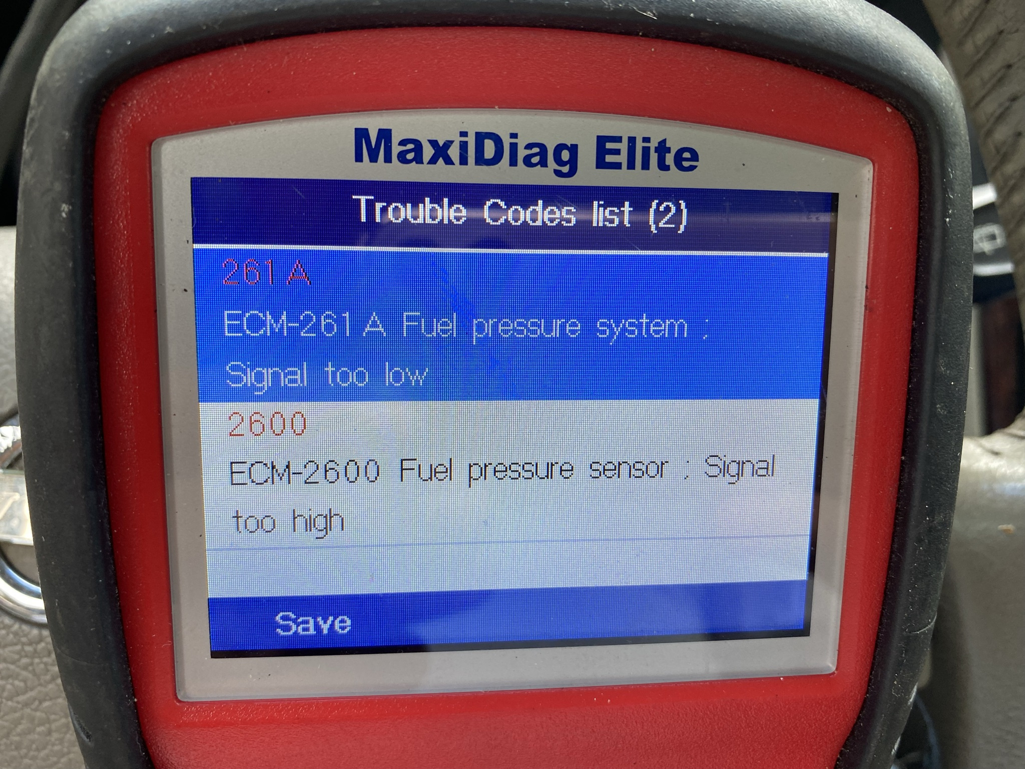

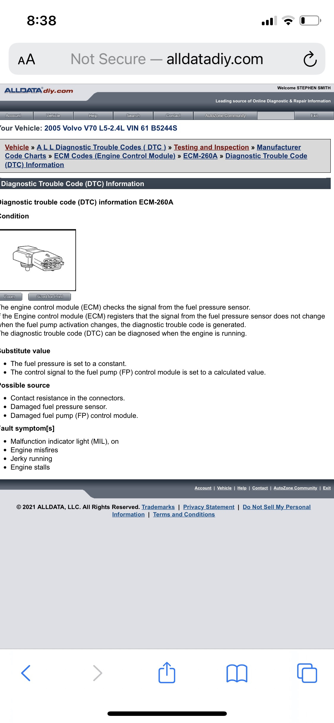

28 September. 134600

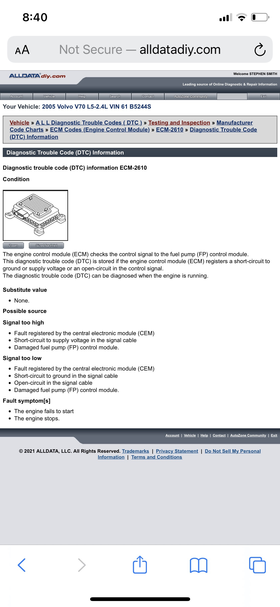

Loss of power for 5 seconds at speed, popped ECM261A and ECM2100
Points to fuel pressure sensor, PEZm, or wiring
7 October 135600 oil change filter change 10W30
Replaced reworked ABS pump. Bushing insertion with pick and large flat blade
Replaced fuel pressure sensor
Possible rear wire harness problems. Two inop items
Rear lid lock solenoid
Reversing lights..will troubleshoot signal from CEM TO REM
3/10 reverse light switch 10/48, 10/55 reverse lights

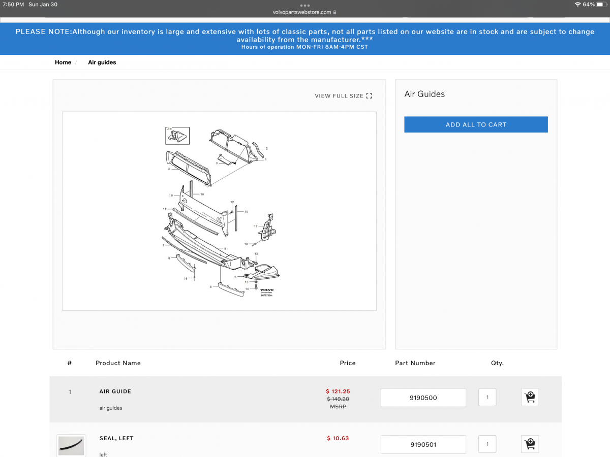

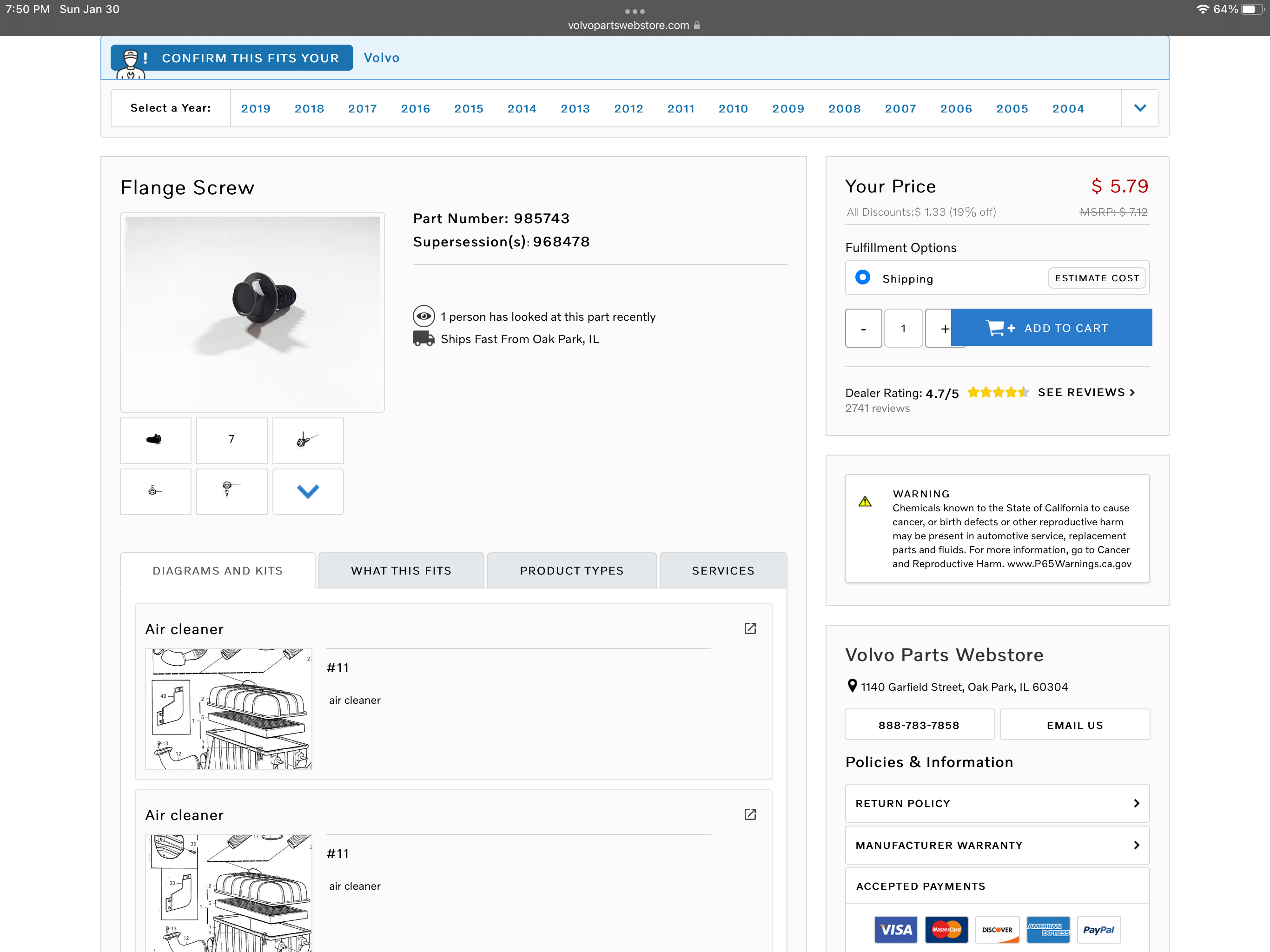

Air guide part numbers
