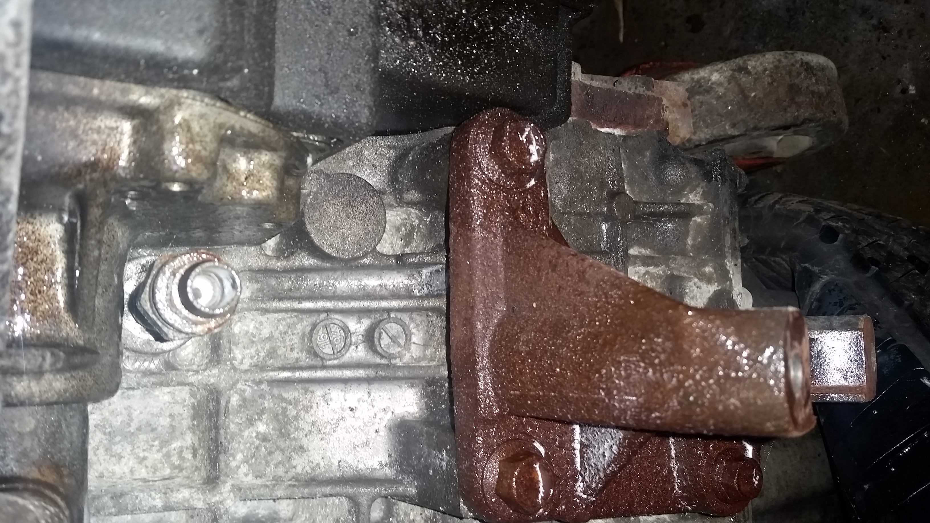

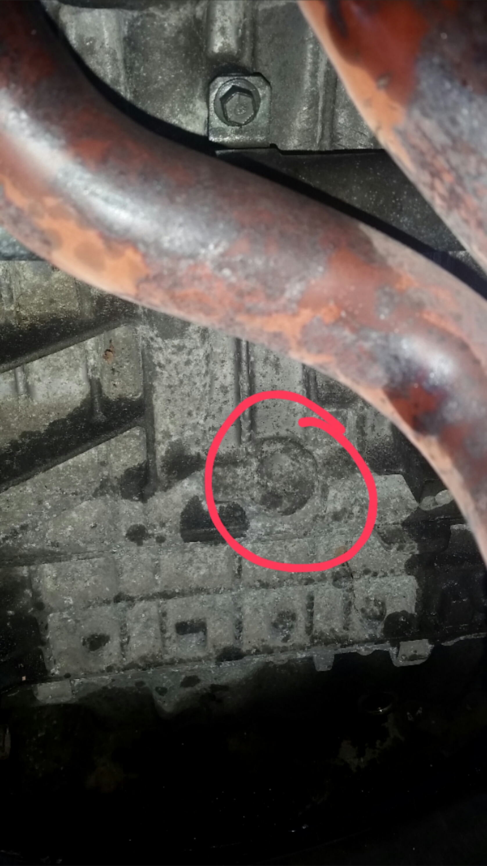

Hey Ozark Lee, Do these spots look about right?
Oil feed line location (not yet drilled)
The oil return on this block im not sure if its correct or not, but I believe it will be this spot (circled)

I have no idea. On the turbo block the socket is cast into the mid block section. The pictures I posted were actually from a '99 LPT engine and the supply may have changed since the internal oil passages were rearranged to accommodate the CVVT and the changes in the oil cooler system. The oil cooler system change wasn't much since it was all in the sump pan.
